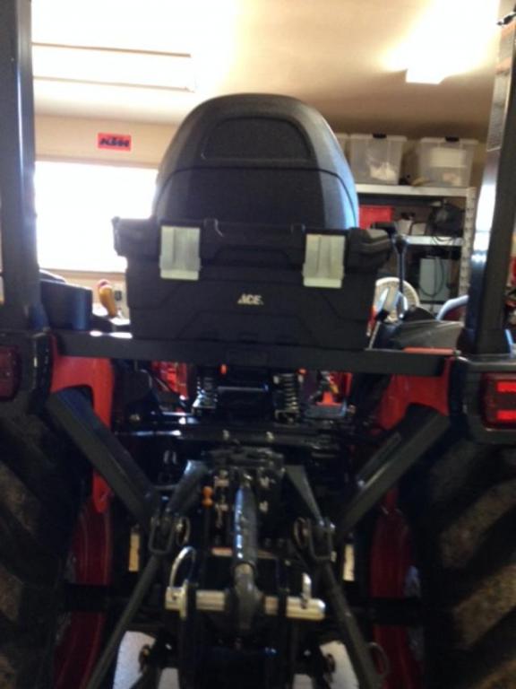

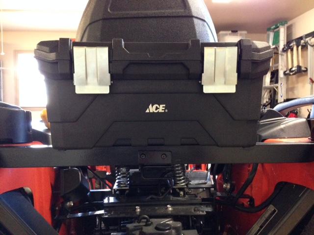

I removed the stock bracket holding the reflector and tiny toolbox and replaced it with a new piece of heavier stock 2.5 x 2.5 angle iron. Toolbox came from Ace Hardware and I bolted it to the new angle-iron in the center. I removed the top-link bracket from the old original piece and put it on the new angle-iron with two bolts. Overall much better and bigger toolbox. Probably won't reinstall the triangle reflector but may add some reflective tape. Titan sells some bolt on hooks that I found yesterday online for $15 but I want to take my time since it will involve drilling holes into the bucket. I will take a few photos and try to post them of the toolbox and top-link mod.
