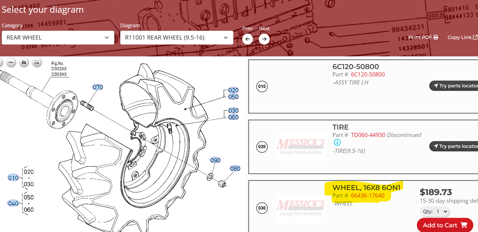

They would be as its the same sizes as the new b2301 2401 2601. The rims from the new B models will bolt right on your 7510
You are 100% right!
  • The B7510 takes 66436-17640 rims on the REAR - and Messicks shows the exact same part for the B2301HSD.

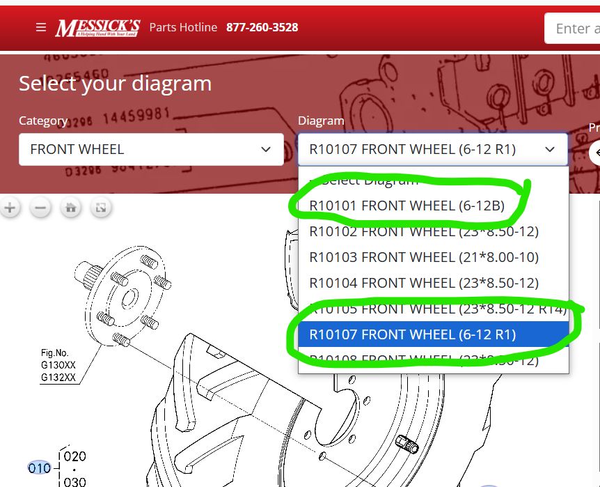

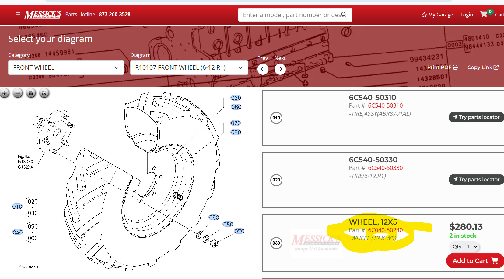

  • The B2301HSD has two Ag options for the FRONT:
  • And the second one (6-12 R1) takes 6C040-50240 rims - exactly the same as my B7510 takes
  • So, the next annoying question I have is how do the two front tire/rim options for the B2301HSD differ? - One says 6-12 R1 tires and the other is 6-12B...
  • View attachment 145147
That im honestly not sure. Id just stick with the 6-12 r1 rim to he safe.
6-12R1B super skinny (rims are skinny too) rice tires
6-12R1
Normal rims, normal ag tires.
