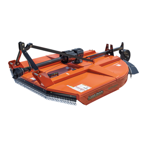

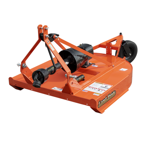

You might want to review the LP specs for the various RCRs; there are differences between the 15s and 18s.
The 15s have a 12 gauge deck versus the 18s' 10 gauge deck, and very importantly the 18s have a much more reinforced deck (upside down c-channel) as opposed to the 15s' flat stock. Compare the lift pin mounts in the photos below. On a minor point, the 18s' tailwheel is a more durable laminated tire, not the 15s' solid tire.
