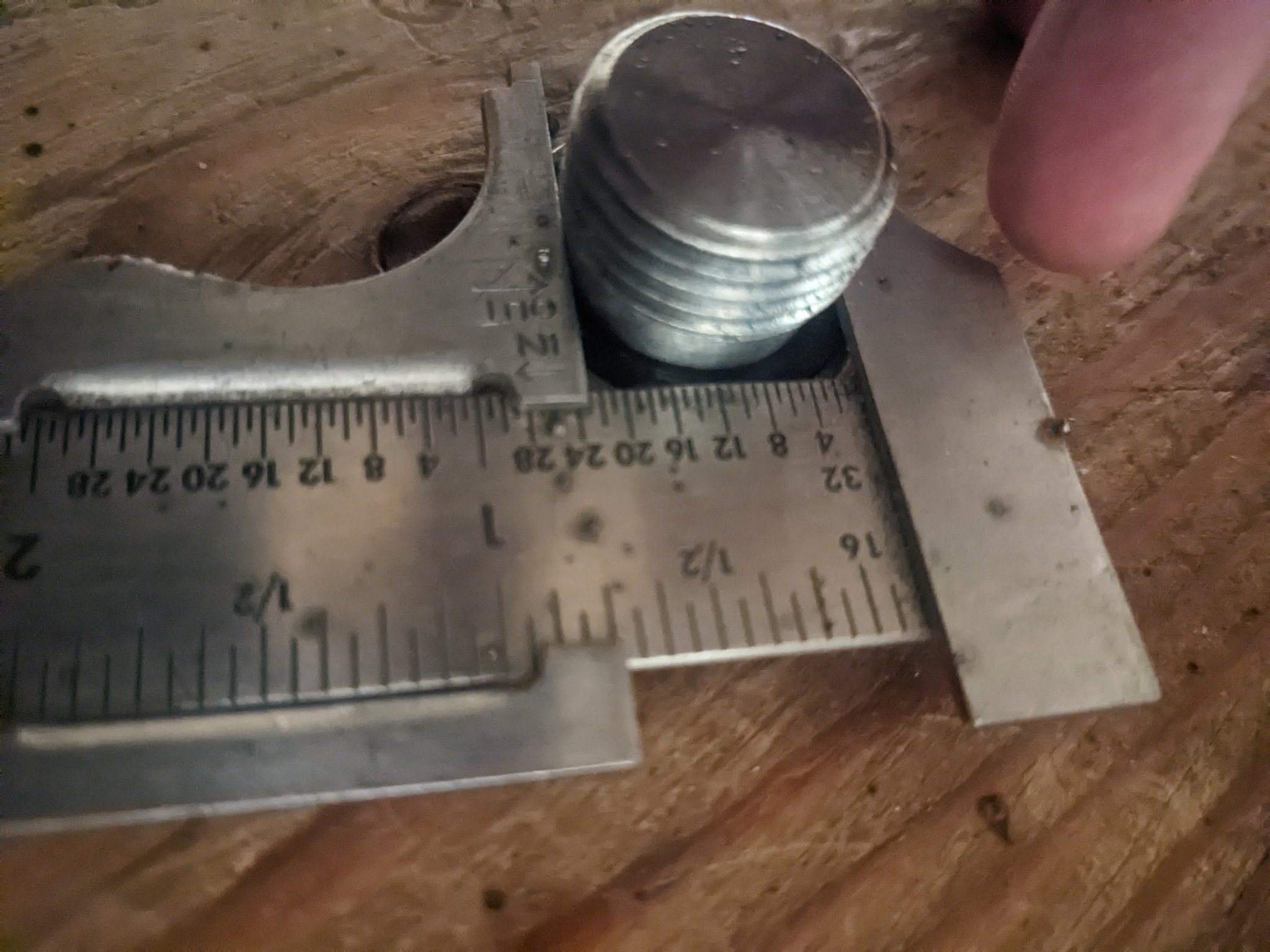

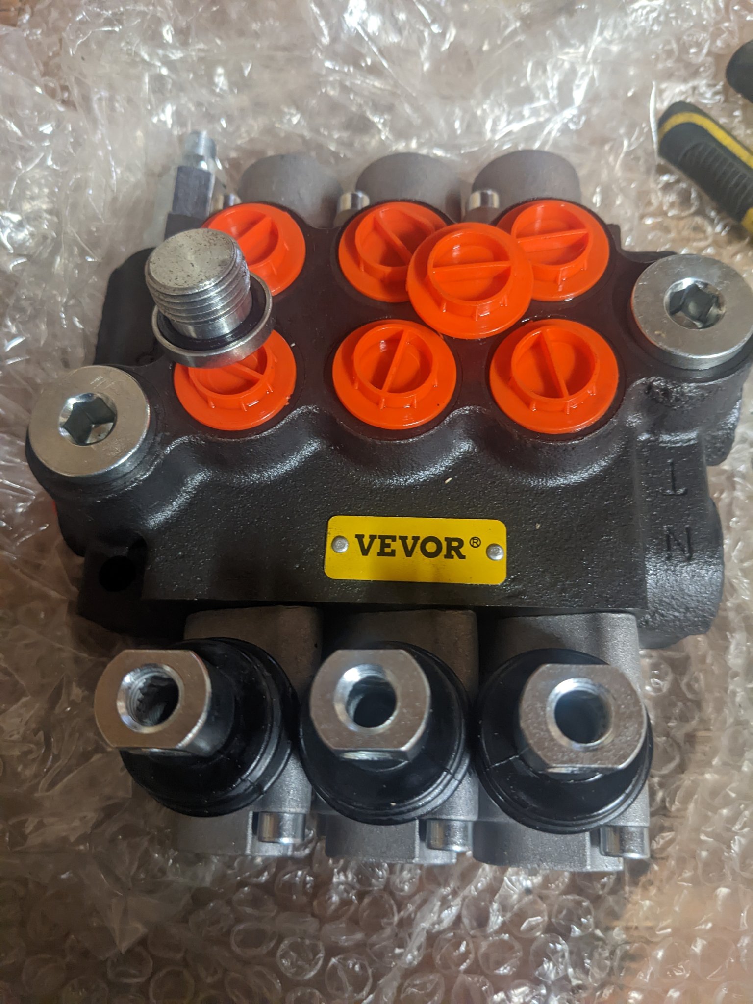

That was fast. I got it today. So it's a vevor, even though amazon said morphon. I guess it really doesn't matter.
The ports are all the same size. So I'll try to see if I can get a PB sleeve at local hydro shops around here.
The ports are all the same size. So I'll try to see if I can get a PB sleeve at local hydro shops around here. View attachment 90230 View attachment 90231
That looks exactly like a P40 valve with a Vevor namplate. Are you sure ALL of the ports are the same size. For sure that plug is NOT 3/8" G thread. A 3/8" G thread plug would be .656 and that looks like 1/2" G thread at .825. Dollars to donuts that is a Chinese P40 with 1/2" G thread on P, N, and T and 3/8" G thread on A and B.
Edit - never mind - I was reading the caliper incorrectly - 3/8" G thread as described. I think you are out of luck unless Vevor has your sleeve.

The caliper shows 3/4 right? So I think this might be npt 3/4. I'll get something npt3/4 today and test it out.
Yeah, all ports are the same. The plug fits everywhere. I sent an email to vevor to see if they sell the sleeve. If not, then I'll just return the valve on the basis that this is clearly not what I ordered: wrong brand name and wrong port size
