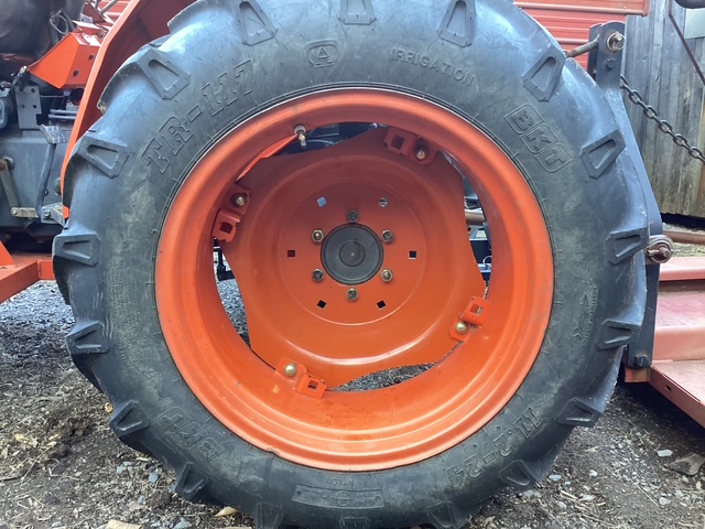

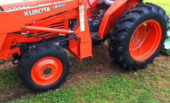

Take a pic of the front and rear tread and I might be able to give you a better answer based off of that.
I'll do that in the morning. The front tread blocks are real tall- more than half way to rice paddy status.

Grab the brand name of tire too if you would.

The tires are BKT's- rears are TR-117's, and the fronts are TR-144's. The tread blocks on the front are a 1/4" deeper than the rear ones. I haven't measured rolling circumference, yet.

It's a combination:
The rears are too small, tread depth is very shallow and the sidewall looks short.
The front are too tall.
You could just put a smaller front on it and get it to function much better.
