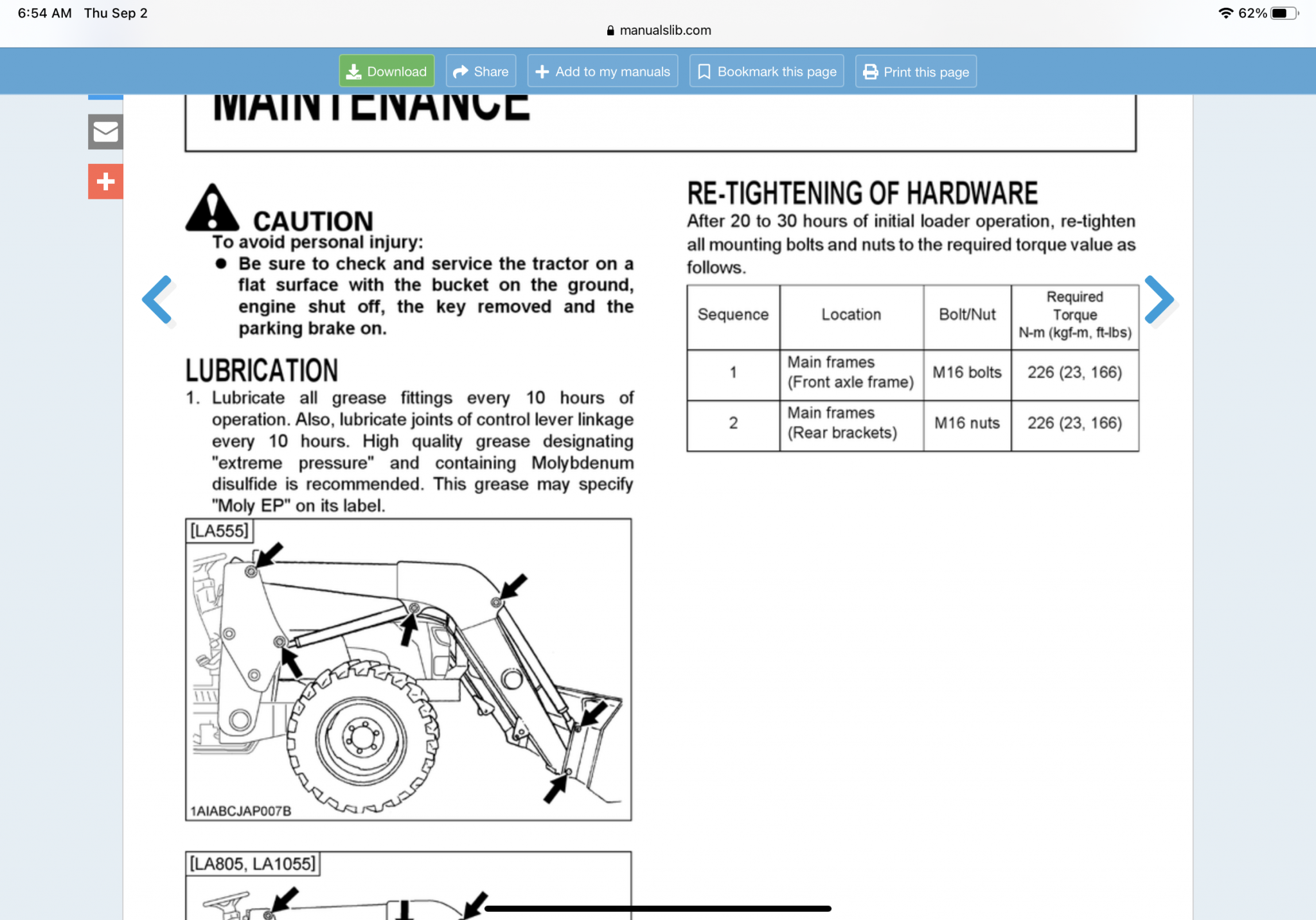

Hey guys. I’m at 10hrs on my L2501. Looking for some advice on grease guns, types of grease, and how many zerks to find on L2501.
Thanks y’all.

On my front loader I use a grease with molybdenum disulfide. I use the same stuff on most of my zerk fittings as well. For roller or ball bearings I suggest a good quality lithium grease. Your operator manual should show where the fittings are located. I don't grease a tractor often enough to warrant (in my mind) a high dollar grease gun. I do have two. One has the expected flexible hose while the other has a short rigid pipe for popping straight on to fittings which are accessible that way.

Check you manual for grease spots. If you have a separate loader manual be sure to check it as well. I number them in the manuals. Then I count as I go around just to be sure I am not missing one. It is quite easy to do.
