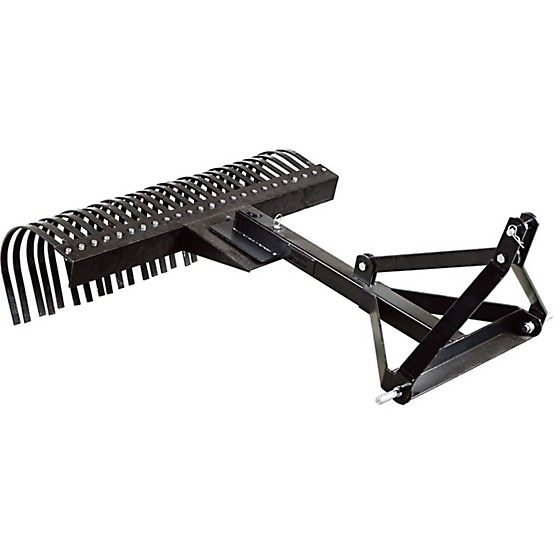

Welcome to the forum. It would be nice to see a picture to fully understand your challenge but I'd suggest a tool like this landscape rake. It will pick up just about everything you drag it over. Sometimes it will release the things it picks up, but you may have to get off the tractor to physically remove some of the twigs, etc.
That's exactly what I was looking into. Would that help with dethatching too, or would I need one of the vertical-tine versions too?

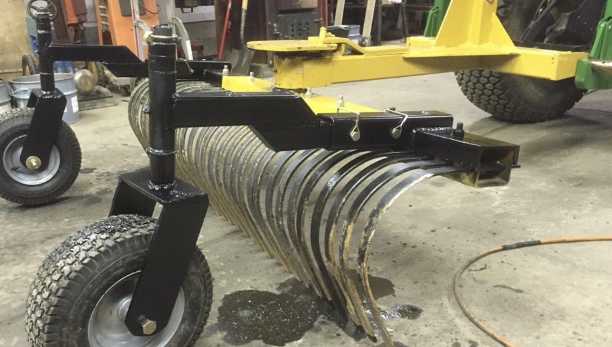

You might want to get the landscape rake with removable gauge wheels.
32,228
7,938
Russell beat me too it, gauge / caster wheels helps it float and only take off the surface debris.
