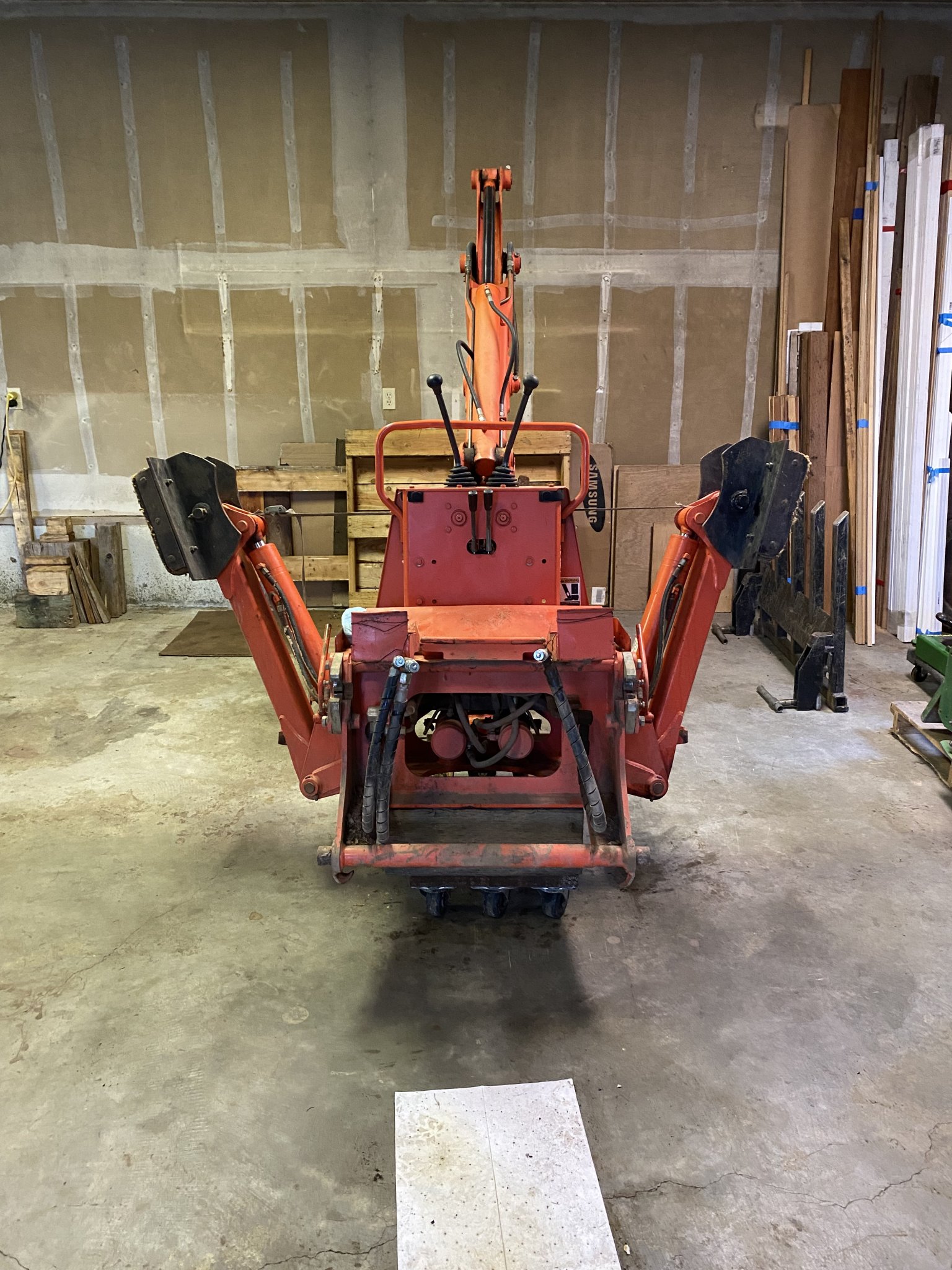

So we picked up a L 48 last year and it was missing the BT 1100 backhoe attachment and we recently found one, but it had been modified.. I would really like to get a picture or a few pictures of what it’s supposed to look like hooked up to the tractor and where all the hoses go. Or if someone would be so kind as to post or send a video of actually taking off the attachment and putting it back on that would be REALLY appreciated! 🙂

There should be a BH manual online somewhere as well. Shows yo the recommended procedure.
I can post some pics for my BT12000 if you get desperate, I imagine they will look similar. My procedure is to spread the jacks out for stability but not touch the ground, fully curl the bucket and stick, boom down to the bucket knuckle to relieve pressure on the BH frame pins, remove pins, slowly boom up and the BH unhooks from the frame.

Bought M59 without a backhoe. Landscape model. Took two years and 600miles to find one. Owners and WSM manuals are your friend. Tractor didn’t have QDs so used flatface connectors on the three lines. Note the tractor hydraulic fittings are British tapered thread. The stickers for the valve positions under the seat were about worn off. Important information when changing from 3pt and backhoe attachments. Surprised how easy to change except for manhandling the weight of the 3pt arms. Improved pin hardware and technique has lessened the time and effort to change.
Hope the previous modifications don’t interfere with OEM design frame hook up. Lot of forces generated and don’t want to come loose when operating.

I was surprised by how easy removal and installation is as well. Quite a bit easier than my John Deere 855. The owner's manual spells the procedure out pretty well. The decals do as well, and are much handier than reaching for the manual. I think you can still obtain the decals, but don't quote me on that.

I had a good picture of the hose connections on the backhoe, but not the tractor side. I took a picture that shows the connections and the valve handles used to divert flow to operate the 3 point hitch when the backhoe is removed. I hope this helps.
