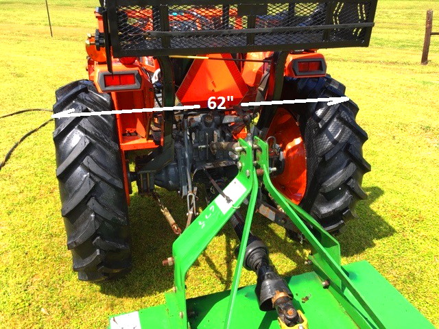

I was able to widen the track on my L2350DT by 12 full inches just by swapping them side to side and utilizing the 'tabs' provided for width adjustment.
I'm not sure that widening the front track is a good idea. It can increase steering effort and radius, plus adds extra stress on the front axle if you have a front loader.
Another thing to consider is that your front axle is most likely a 'pivoting' axle and by the time you hit its 'stop' a rear tire is probably already off the ground. So if you are wanting to widen the front for sake of stability....it likely won't provide much.

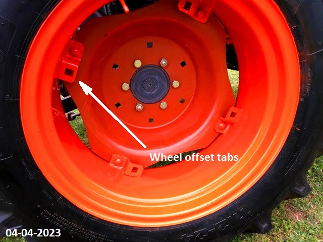

Flintknapper, what are these "tabs" you speak of?
Look at your tractor rim and see IF they have offset tabs.
IF they do...then you can swap the tires/wheels side for side AND mount them either inside or outside of the center hub for greatest width adjustment.

Ah, you have the expensive rims, mine are just welded in place so only 2 settings, wide and narrow, depending on which side they're on.
