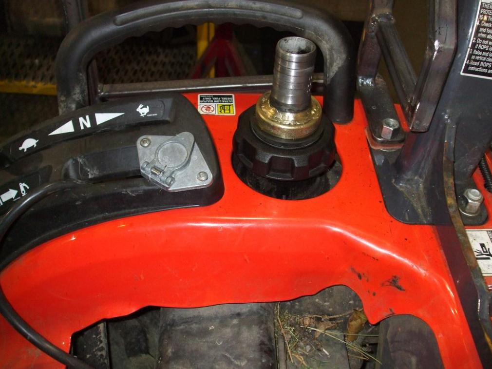

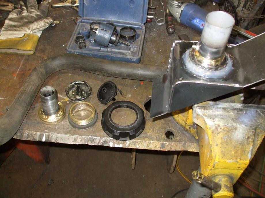

One more desired feature was to have an external Fuel Filler Neck, as it was difficult enough to raise the 5 gal. Diesel jug to the fuel cap, without having the cab door pillers in the way. Tektite Cabs had such a feature on their cabs, and knew I could build such a thing quite easily.

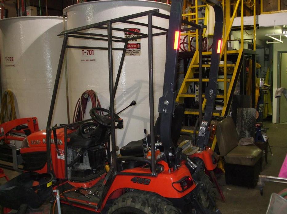

Part Deux of my Kubota Cab build,

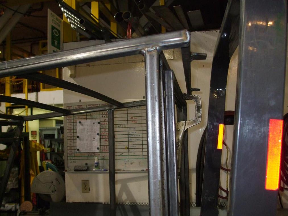

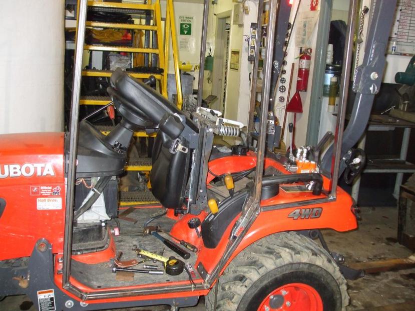

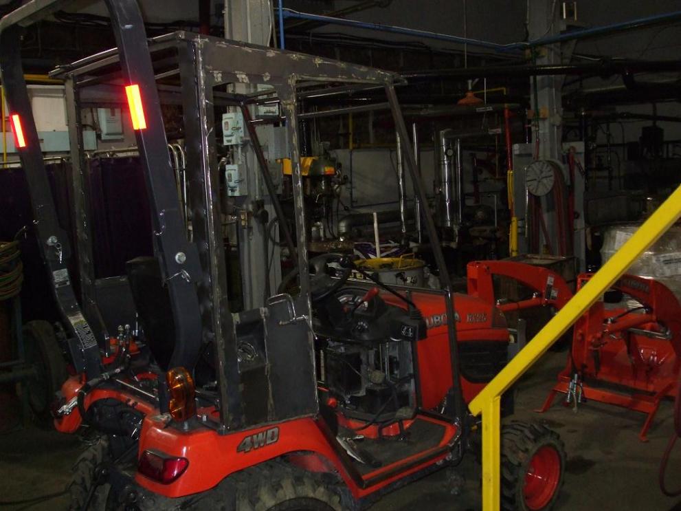

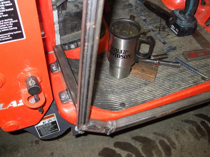

After getting the steel, I began with the front lower mount, using one existing hole from floor plus drilled one more, for tabs welded to 1" box steel. Yes, I could have simply drilled down through the 1" square tubing, but wanted a little more space to the FEL mount, for the glass and working area.
I followed the general shape of the floor pan to the rear fender, where I drilled for my second mounting point, where I mocked up the tab with the 1/8" rubber gasket. From there, followed the fender up and across to the rear ROPS mounting point. As photos show, I had to work around my aux. hydraulics valve mounted here, but worked OK.

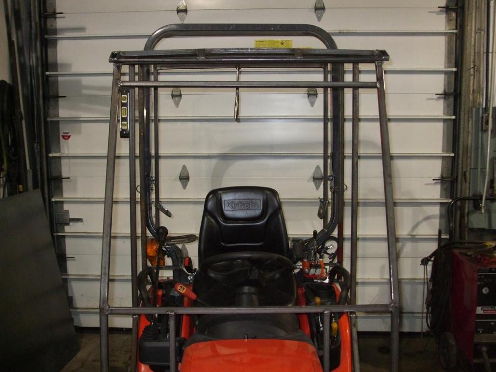

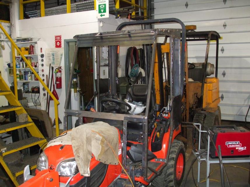

The verticals came next, for the door hinge posts and front windshield frame. I simply eyeballed the desired angle for the windshield, I was at 5deg. for the lower front, to approx. 15deg. from vertical for the windshield itself. The rear vertical followed suit, and the overall width went from 37.5" wide at the front to 43" at the rear, to accomodate the grab handles on the fenders. Note: I knew I was very close to the handles at the rear bottom framework, but it was only when I used the sling strap to remove the cab for final welds and painting I found out as long as I raised one side by one inch before the other, the cab cleared the Grab Handles perfectly - and went back on the same. (Almost as if I had planned it like that -GH)
I wanted a slight arch to the roofline, both to help repel water and for strength, so with the help of simple large C-clamps, was easy to put a 3/8" crown into the roof cross-members. Front and Rear Crossmsmbers were 1" Box, and the middle three were 3/4" Box steel.
As shown in photos, I added a 3" front overhang as a water shield/shade, and to mount the front lights. This worked well, except when installing the separate roof, I realized I cannot do a compound curve(side-to-side crown plus front drop for 3" shade) into the steel sheet without buckling. I solved this by simply slitting the 3" front drop in the center, then Mig Welding the seam back together after clamping all down.

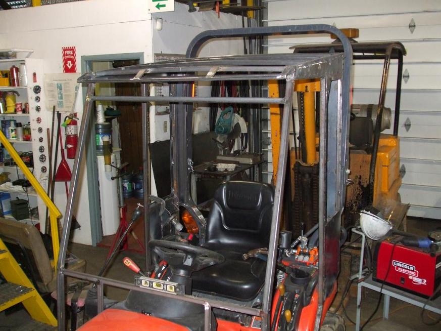

For the roof, I also wanted it to be separate from the framework, and isolated against vibration and reverberation. I had a few 1/2" thick foam rubber interlocking childrens floor mats, 24"X24", which worked perfectly, and I also laid 6mm poly plastic between the foam and the 1/16th steel roof, to prevent any possibility of sweating or condensing. I had the framework tabs pre-drilled, so after all was clamped into place, I simply drilled up through the roof panel, and used 1/4" SS bolts with rubber backed washers and large SS flat washers too.

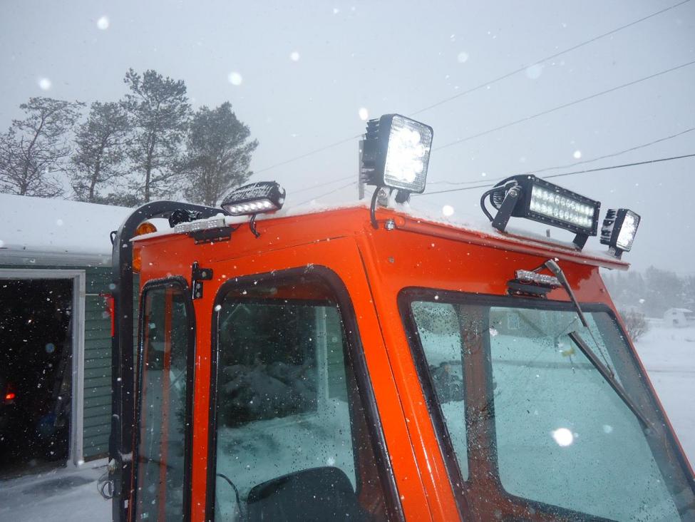

By now I had all my LED Lights, so drilled for the mounts and power wiring where required. I drilled and test fit for the Windshield Wipers (Front and Back) and drilled out for the heater hoses to pass through the left side lower panel.

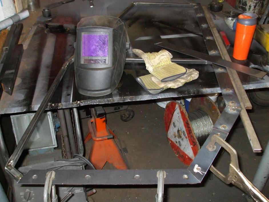

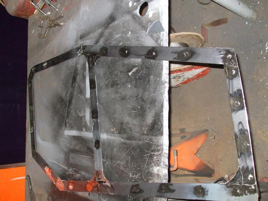

The roof was removed and set aside for painting, and I continued to build the rear removable glass panel. It was tricky to frame to match the opening, and a friend suggested I go to a local metal fabricator to have some of the sheet steel sliced and brake-bent to 90deg. to save on making extra framework for the rear panel. I did this, plus also had them shear 8 pieces of the 1/16" steel into 2" wide strips 48" long, to make the facing for the doors to hold the glass. This saved me a lot of slitting discs for my 5" hand Makita hand grinder, not to mention the edge grinding required.
I now had all the sheet steel panels on the main cab framework, Mig stitch welded and trimmed, and began to face the door framework with the sliced strips of the 1/16". On advice from another friend, I drilled 3/8" holes every 6" along the strips and after clamping along the door frames, allowing an outside lip for the rubber weatherstripping, and spot welded into the holes, securing the face steel to the door frame. (Photo to follow will show this detail)

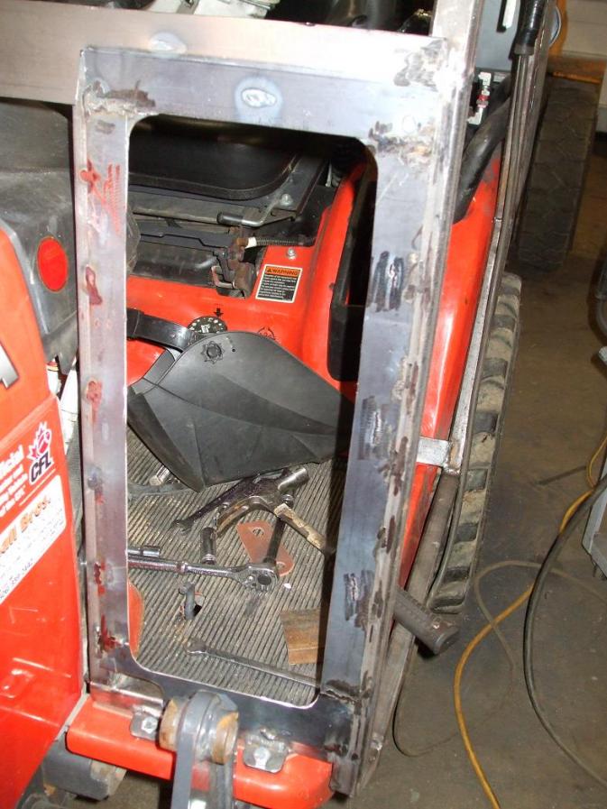

OK, Doors now framed, panelled and radiused for the glass - Time for the 'Gulp' Rear removable panel. I had framed the facing(mating) frame in 3/4" square tube, and thanks to the brake-bent steel, did not need to frame in the outside facing. I measured up and carefully cut and fit the 90deg. bent pieces for the panel to the framework, and mig'd it all together, then cut rounded corner crescents for the glass fitting. I made simple 'L' shaped hooks cushioned with sections of 3/4" hose and bolted them to the rear upper frame to hold the rear window panel, kind of a Hanging Hinge affair. I bought two rubber stretch hood-latches to hold the bottom in place. I'll also use the peel & stick rubber weather srtipping around the panel after painting.

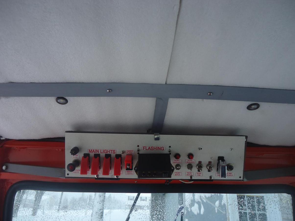

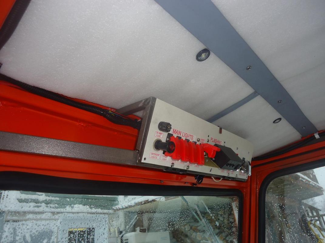

While building the cab at work during the day, I spent a few evenings designing a suitable Switch Control Panel to mount above the windshield. Our local Princess Auto Store supplied most of the switches, along with some salvage fuse holders, circuit breakers and various switches saved over the years. I planned to have all electrical fed by a simple polarized plug(actually used a Trailer Elec. Plug&Socket), and have all connected and switched at the panel. I ran Pos. & Neg. feed directly from the battery with 10ga. mains to a set of terminals then to a 25amp fuse and to one side of all switches. The switched side went to individual labelled terminal strips. From there, I simply ran each set of lights, wipers, washers, heater fan and aux. fan to the corresponding pos. terminal. I used a negative grounding of the cab frame, so only one main wire needed to be run all the way to the control panel, the neg. wire simply got grounded to the nearest lug screw into the frame. I built the frame for the Switch Panel from very light ornamental steel from a factory built cheap gazebo. It barely was thick enough steel to allow me to weld it. Matter of fact, I chose to pop-rivet and bolt it together after tacking in places.

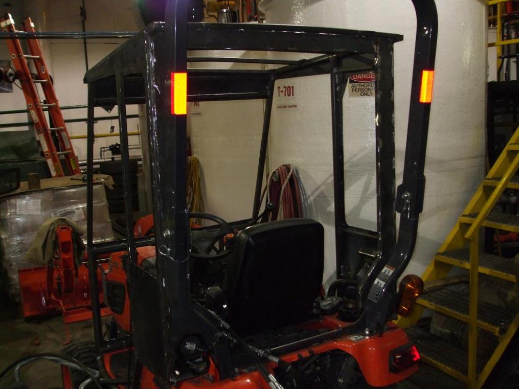

By now, I had all the cab basically built, with roof panel finished, rear panel complete, doors sheathed, and had the Outside Fuel Filler finished, ready to mount. I built this filler the hard way from scrap/salvaged materials, it did work well, but if I were to build another, would use a 1.5" Thru-Hull fitting through the original cap, and fab the outside part to match. Both pieces are joined by a 6" curved piece of radiator hose, clamped in place. Figuring the fuel cover was vented, I threaded a drilled-out grease fitting in the filler neck, and ran a piece of clear 3/16" hose up to the outside rear roof area as a vent.
My friend who is a very good spray painter, suggested I use automotive Seam Sealer at all joints and seams, to prevent moisture from getting between frame and panelling, and running rust streaks. I bought 3 caulk tubes of UAP Seam Sealer, and squeezed a bead along every exposed seam, inside and outside, and used my finger to spread and smooth it all. -Very messy black stuff, but set up nicely, and took paint very well.

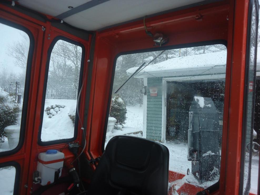

The Universal Windshield Washer kit was installed after adding a second little pump to the side of the tank, for the rear window.

I did cheat and use a skim coat of Automotive Finish Body Filler in a few places to cover a couple seams around the Fuel Filler.

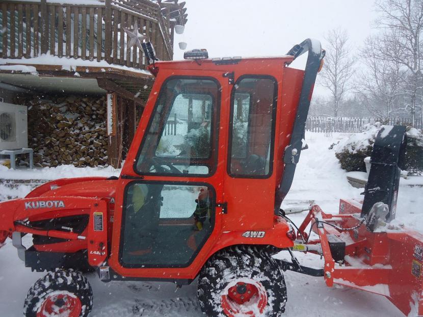

The glass did cost me the most of the build, final invoice was $1000.00, but I like to think I have better than a Factory Cab, at 25% of the total cost. I figured I have approx. $1,600.00 into the build, including the $180 in all the LED Light units, Wipers & Washers. The Square Tubing and 1/16th sheet metal came from Russel Metals, and cost me $320.00 The 5000BTU Coolant Heater unit was on sale at Princess Auto for $120, works great, I built a diverter for the heater to direct the heat to the windshield or the floor, and keeps all windows from freezing or steaming up, having used it for three bouts of plowing and snowblowing in January 2016 so far. I did the heater hookup to the engine from the water pump bypass hose as suggested, used 5/8" heater hose to copper reducers to short pieces of 3/8"ID washing machine feed hose to the bypass fittings. This was simple, and works great.
I brought the tractor home after the glass was in, and finished off all the wiring in my home garage. I used the proper connectors, terminals, looms, etc, and hooked up the Kubota 2789 SnowBlower chute Rotate and Tilt controls on a separate little panel near the rear, with two DPDT(Double-Pole, Double-Throw) Momentary Switches with Center OFF.
All works as well-if not better than planned.
The Switching Panel is from some 1/8" thick Arborite Laminate I had laying around, and I will use more of it to put a bottom to this panel area to store spare fuses or bulbs.

This build took me total of 5 weeks build time, some days were longer than others, and was a great project. I figure I've added $5,000.00 in value to my tractor, and priceless comfort and satisfaction.

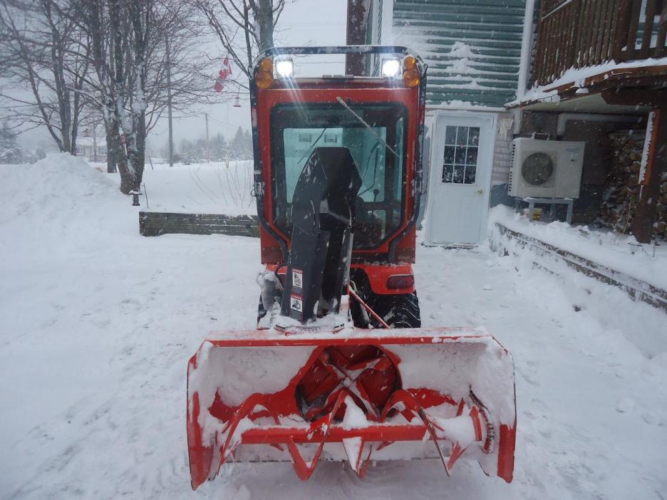

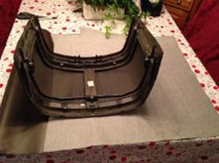

Awww, just to mention - the Winter Front air dam around the lower center console- I figured Curtis would want a wicked price, so my wife had a couple yards of brown vinyl left over from re-upholstering some chairs, so I simply took a pattern from the curved piece, extended it as needed to fold and stitch, plus allow for overhang at bottom and sides. With her help of course, we folded the brown vinyl over along my marks, and ran a triple row of stitching around it. I bought couple packages of peel & stick Velcro, washed the center panel down with rubbing alcohol, and stuck the Velcro around the outer edges, and stuck the mating Velcro to the vinyl. I peeled it off carefully, and tried to use my wife's Singer to stitch the Velcro, but it was having NONE of that crap, just balled up the thread twice. So I took it to a local Sail-Maker (Yes they still do exist in this Port City), who did me a double row of stitching through the Velcro and vinyl. - Great thing too, they just chuckled and didn't charge me a thing. -I owe him a large coffee!
BTW,
I ran the first snowstorm with the air dams (Black plastic halfs inside the Center Console cover) both intact, just put the Winterfront on. I watched the temp gauge, and ran the engine approx. 2000rpm during snowblowing for almost an hour, the gauge rose to 3/4 in the normal range, close to 1/4" from the red mark. I brought the tractor back to my garage, and removed the right side half of the black plastic air dam, letting the engine get air from beneath the tractor. I ran it again, and for the next hour, plus the next storm last week, the gauge rose no higher than mid range on the temp gauge. I will leave the other half bolted in place, and come the spring, may or may not need to remove it, or simply peel off the vinyl winterfront.

Photos following of me making up the WinterFront
Really great looking cab, I know it makes snow blowing a lot more comfortable.
For cooling on my BX2370 I removed the foam seals that are use to seal the openings in the black air dam and left both pieces of air dam installed. Normally my machine runs at two divisions on the temperature gauge. The only time I have gotten up to three divisions is blowing heavy wet snow. I have a 1/2 mile of driveway so with wet heavy snow I have a good long run to heat it up. On the way back the temperature dropped back to the normal two while still blowing snow, but going downhill.
Thanks for the nice comments, Larry. - I'll look again at the foam seals on the black air dams, and may re-install with those removed to try.
