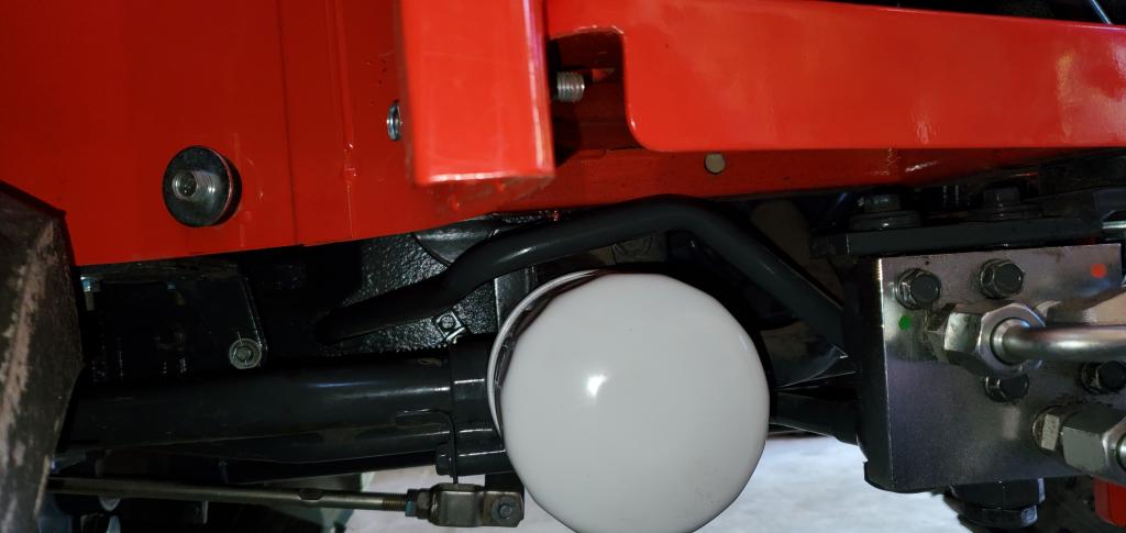

short interesting story I thought some may find amusing here. I did my first 50 hour maintenance on my L2501 the other day. So that involves changing the oil, the oil filter, the HST filter, and the transmission filter, as well as some more minor tasks. I had watched a couple videos and read up on all that it entailed as it would be my first time doing this stuff on a tractor. Everything was pretty easy and straight forward. I did the oil and oil filter first, then came back the next day and did the other filters, as I was waiting on a gallon of super udt2 to come in. (Knowing I would lose a little fluid in the filter changes and wanted to have a gallon on hand to top back off) so the transmission filter change went fine, only lost a few ounces of oil there. Then I got to the final step of my 50 hour maintenance - the HST filter. Everything had been simple and smooth. I grab my filter wrench and start cranking on it, it finally comes loose and I pull it off. Oil starts to really pour on this one - I knew it would be the one where you would lose the most oil from my research. I already had my new filter ready to swap on immediately. I grab it and quickly go to screw it in place only to find this metal pipe literally hanging down a good quater to half inch in the way - there is no way at all to get this filter up to the thread. Baffled, and with oil just pouring into my 4 gallon pan, I keep trying to force the filter, but its not going to happen, this metal pipe is literally in the way. I grab the old filter wondering how in the world did it manage to be on - and I see a dent right up near the kneck where this pipe and clearly been bent/pushed down, bending and resting on top of the filter. I scrambled to grab a screw driver and try to force the pipe up(which did work a little), all the while Im just losing all my hydraulic fluid. I finally had to grab a 5 gallon bucket near by as my oil pan was about full. I was so frustrated as $100 of hydraulic fluid, that wasnt really needing to be changed just ran out of the engine.
Needless to say, I soon accepted my fate and just let it run out, realizing I was gonna have to just go buy a 5 gallon bucket and deal with it. I began to study this pipe. I have no idea how or when this thing got bent, of if it was bent like this when I bought the tractor. It was clearly bent, resting both on top of the filter and some little part that connects to the treddle peddle. It is some part of the hydraulic plumbing. The pipe is bent in such a way it is meant to go up and over the filter location, but mine had been pushed down. I went to my dealer to get the 5 gallon bucket of new oil and while there walked over to other L series and looked at the HST filter location to see what it is supposed to look like. This is when I knew for certain mine was bent. On these machines this pipe has a good 1-2 inch clearance above the filter.
Once back home I decided to take a block of wood and a car jack and slowly try to bend this pipe back up out of the way, just enough where the filter will clear and it wont be pressing on anything. Long story short this worked perfectly. I just slowly spun the jack and was able to re-bend the pipe back up to its more normal position, without breaking anything and without causing any leak that ive seen thus far. I then put my new filter on, then put about 4-5 gallons of udt2 in to bring it back up on the gauge where it should be. I havent done anything with the tractor since all this other than ride it around a little and let it idle for a good 30 minutes or so. Everything seems ok. I guess the silver lining is that I sorta got a full HST fluid change at my 50 hour maintenance - and I know some people suggest doing this anyways. I had planned not to do it, but oh well, now its done :)

You got pics of the pipe and area you talking about? Mine ain’t HST so I don’t have that extra filter.

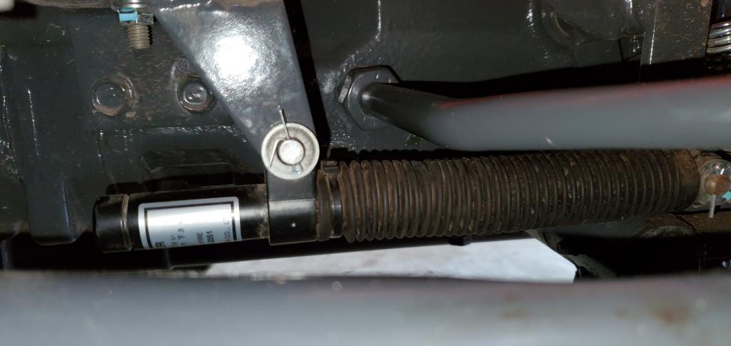

Here are some pictures showing that pipe. It was pushed all they way down to where it had pressed into and bent the original HST filter, and was resting on top of this item with the rubber protective sleeve on it, which connects to the treadle peddle. Using the car jack, I slowly was able to put pressure on this pipe and bend it back up so its in a more normal position.
