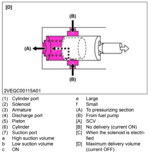

From what I see in wsm. And I'm struggling to wrap my head around the fuel delivery system, if I unplug the scv and say the scv is not stuck or in wrong position, shouldn't the high pressure pump be putting something out to common rail when cranking it over? In other words..no current should deliver fuel? Thanks!
