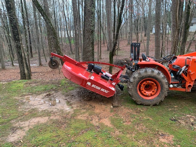

I like my pats and euro top hook from FitRite. On my 6000.
Best picture I have at the moment.

Correct, well kinda. After the Pats was installed, the factory top link was too short by about 2-3" to hook to the cutter pictured. Wasn't of any concern to me, as I knew I was getting top and tilt. I added the euro hook after seeing @ctfjr setup in another thread. Sent Brian some measurements and everything arrived spot on.
Extended
Retracted

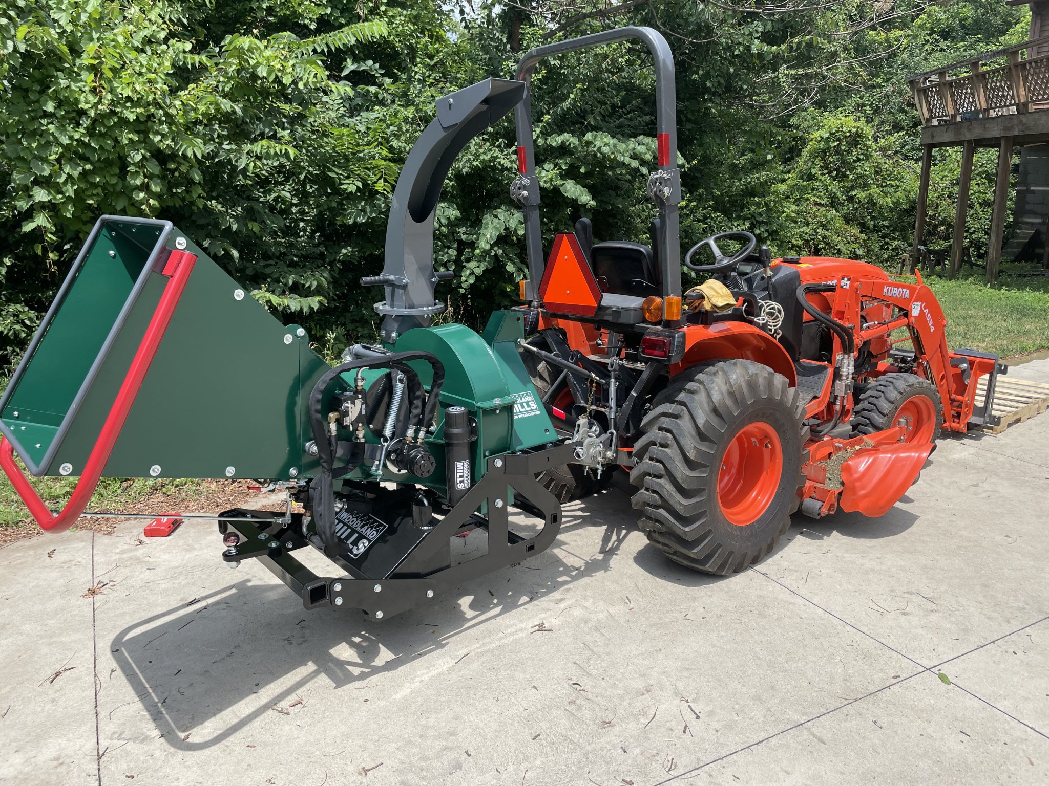

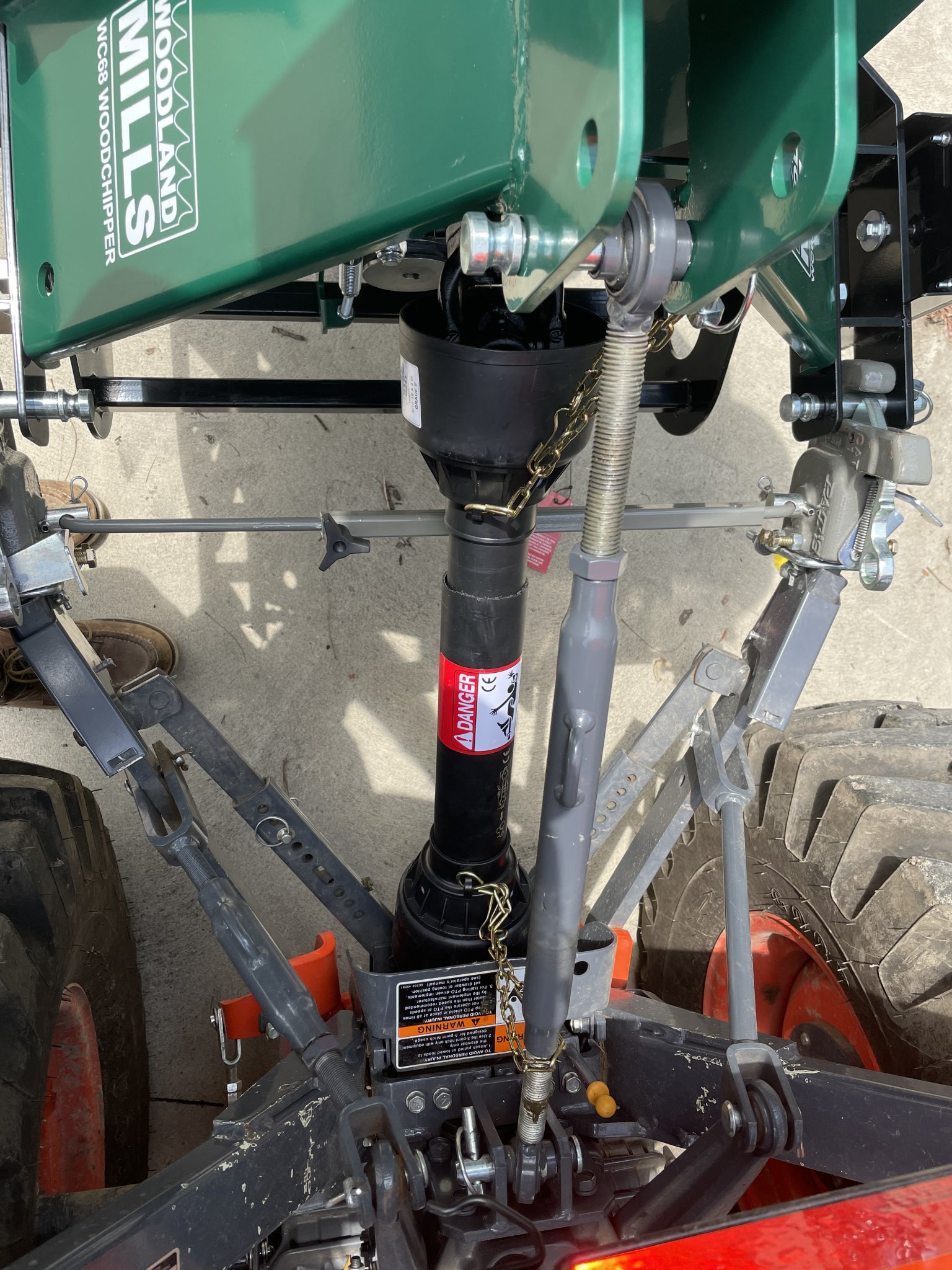

Just a follow up on top link w/ Pats. 2 for 2 and I more attachment to go. Today I attached and finished final set up of the chipper and with the Pats, the original top link(output side of the link arm) is at about a 1/4 or 1/8 turn on the buckle from the stop…so I’d say it is right at the limit. I have no idea how many threads (length is left on The inside) left…on the side towards the tractor their is more room to turn though. Probably depending on the attachment and tractor as jyoutz suggested some may need a longer link.

The problem that I found with many of the quick connect systems was the difficulty of connecting the PTO shaft after the implement is connected. My solution was “PAT’s Easy Change” system. It attaches the
connects directly to the lower lift arms leaving open access to the tractor’s PTO. The system also allows easy adjustment for various widths of connection pens on different implements. The one downside to Pat’s system is you have to dismount your tractor to connect the top arm of the 3 point.

I think I would have to dismount to connect the PTO on all of them that I ever met, unless I could figure Inspector Gadget arms 😉. I connect the top link after I set the PTO. It’s the same dismount…I flip the pats tabs on the arms at that time too. Even with my QH on the other machine still have to get off to flip the levers and the set the PTO shaft. I think Pats is more more flexible, so far with limited use I wish I had Pats on the larger machine as well. The top link is another step, but if it lines up easier to me it’s quicker…and sliding the pin isn’t worth arguing about…at least not to me.
