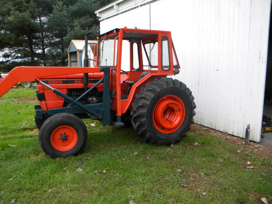

So my M4500 came with a muffler that was more or less round. But when it came time to replace it I just bought a straight in/out glass-pack with the correct size outlet, cut the nipple off one end and welded a 24 inch extension on in its place (didn't want to use a clamp on the top too). Looks very much like stock (except no seams), straight through design, but far quieter than a straight pipe. Works great, ought to last for years.
