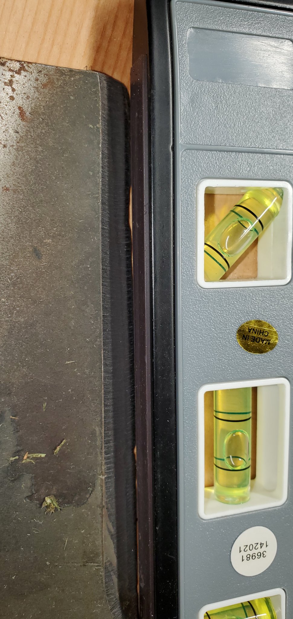

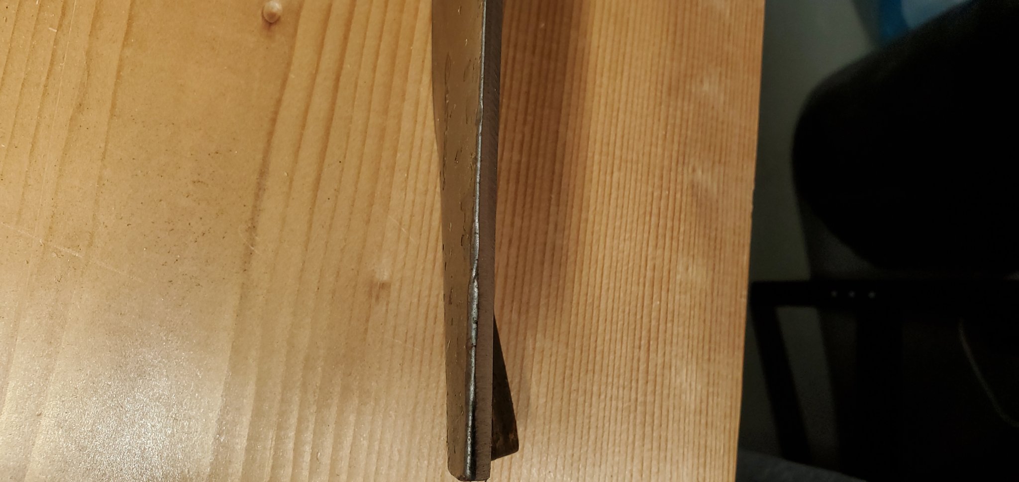

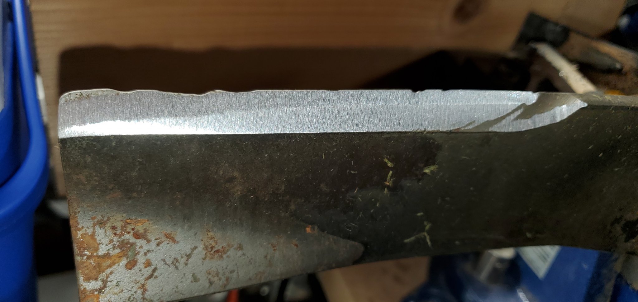

Here is an example of a "gently used blade" that has a couple bigger nicks (not bad in comparison) after it's already been resharpended. This is about as average of a damanged blade as I've got.
in this picture, you can see a couple bigger (longer, not really deep) nicks.
here is a view looking straight down on the cutting edge showing the nick (middle toward bottom of picture) and you can see it's not as narrow (sharp) as the inside (top of picture) of the cutting edge. I'm not sure how "terrible of a cut" this blade will leave. If I can improve the cut, I'd rather do that.
In this picture you can see how deep the nick is on the cutting edge. The blade is laying against level/straight edge. I'm guessing maybe 1/8" max, probably smaller.

For just nicks, grind a new edge. There is enough "meat" on the blade to clean it up a few times and once you have to take off too much material then it is time for a new blade.
When grinding out a lot of material, pause and let the blade cool a bit a few times during the process. Getting too aggressive with the grinder can heat it to the point where you have turned your factory heat treated blade into a brittle blade.

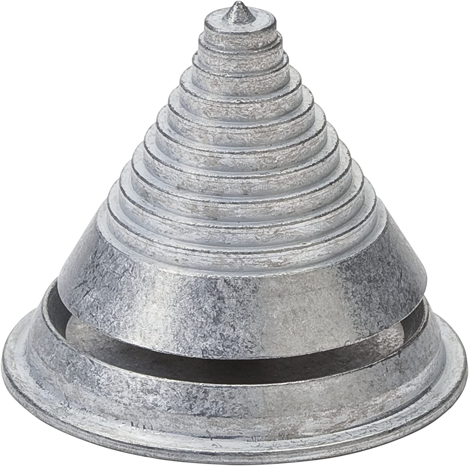

As Greensvillejay mentioned get a 4 1/2" angle grinder and a floppy disc for it, and a simple balancer and start practicing on what you have. Always clean off any dried grass on the blade before doing any sharpening. You can get an inexpensive angle grinder at Harbor Fgt for <$20.
When you have the edge cut the way you want it lay the blade on the balancer. If one end is lower than the other put a chalk mark on it and dress it down a bit more all the way across the cutting edge just to lighten it up so it becomes level.
The video you posted shows the guy grinds all the way to the center of the blade. He grinds too far from the outer edge and takes way too long grinding with that disc. Only grind where the original cutting edge is. Go quickly with short strokes and try to keep the blade as cool as possible.
I've seen these balancers for $5 at hardware stores or Wal Mart.
