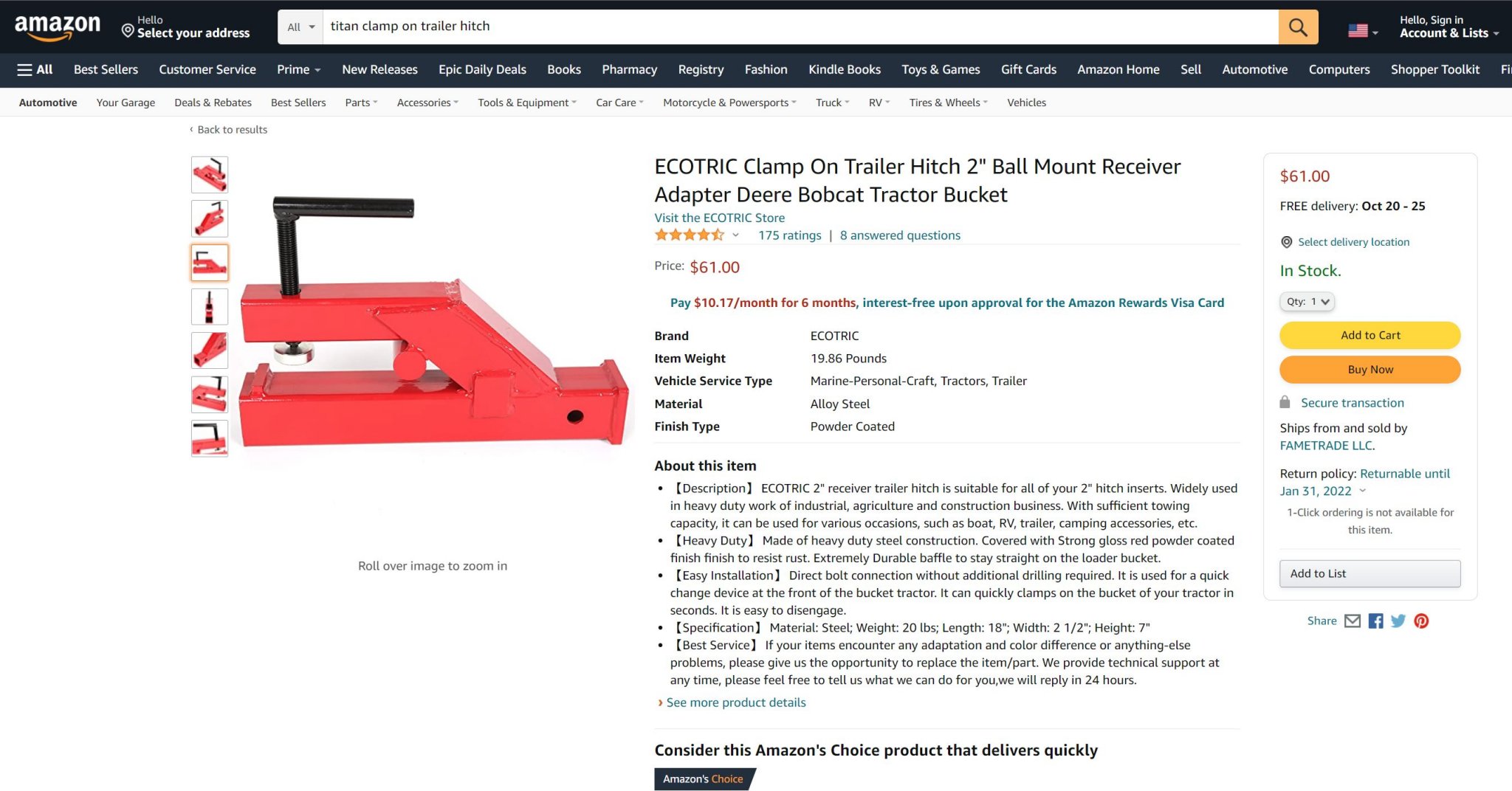

Then there‘s the pallet-forks…. I’ve ordered one of these red-adapters in the pic because for the same reason I’m reluctant to drill a hole in a fork…. and don’t know why.

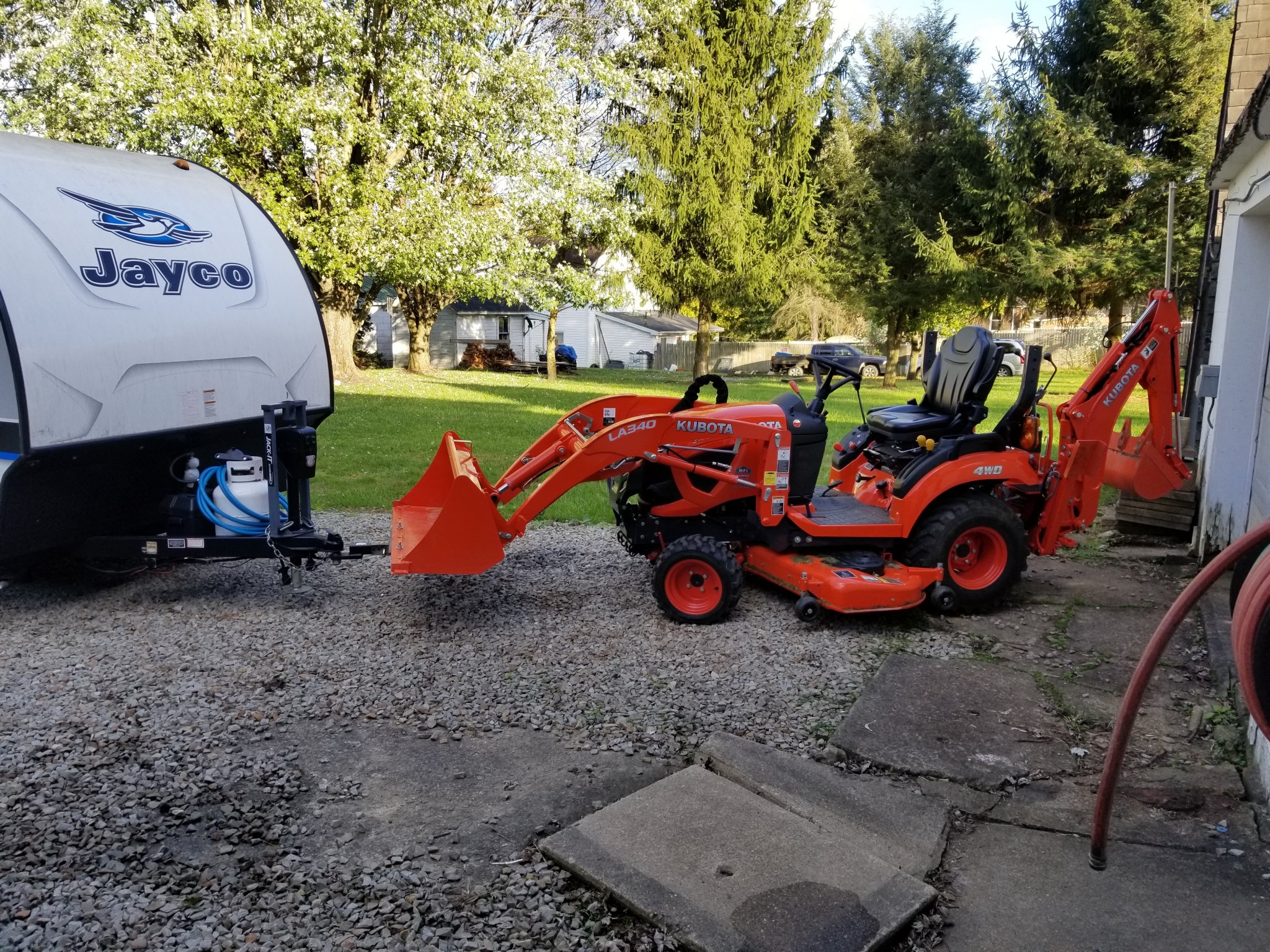

I drilled a couple holes in my bucket to use something similar to the black one in your photo. Works perfectly and I never notice the holes.
Absolutely no complaints here. The trailer ball thingee goes on and off in an instant. Maybe a minute in real time.

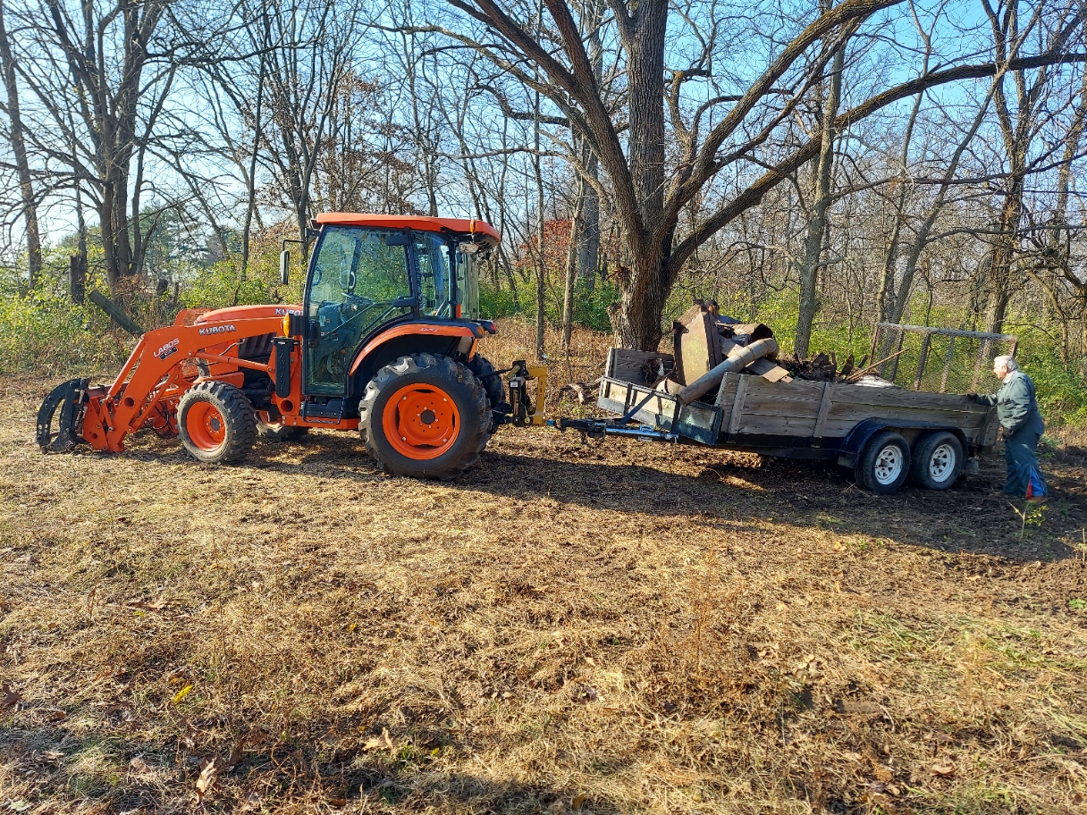

I welded a receiver to the bucket. It is a HUGE time saver. I use it all the time to move 20’ tandem trailer.
(i should add, this is for empty trailer only! :LOL:)

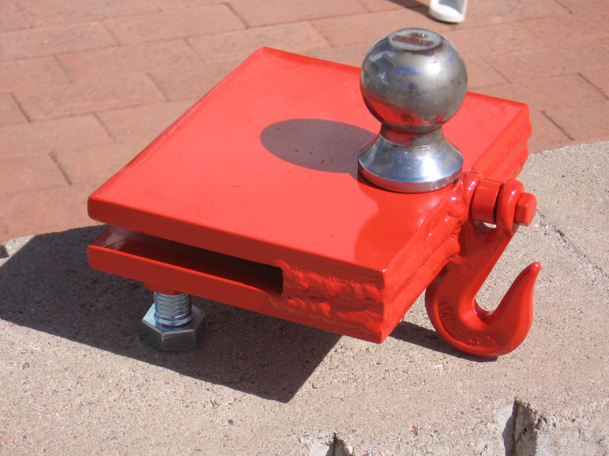

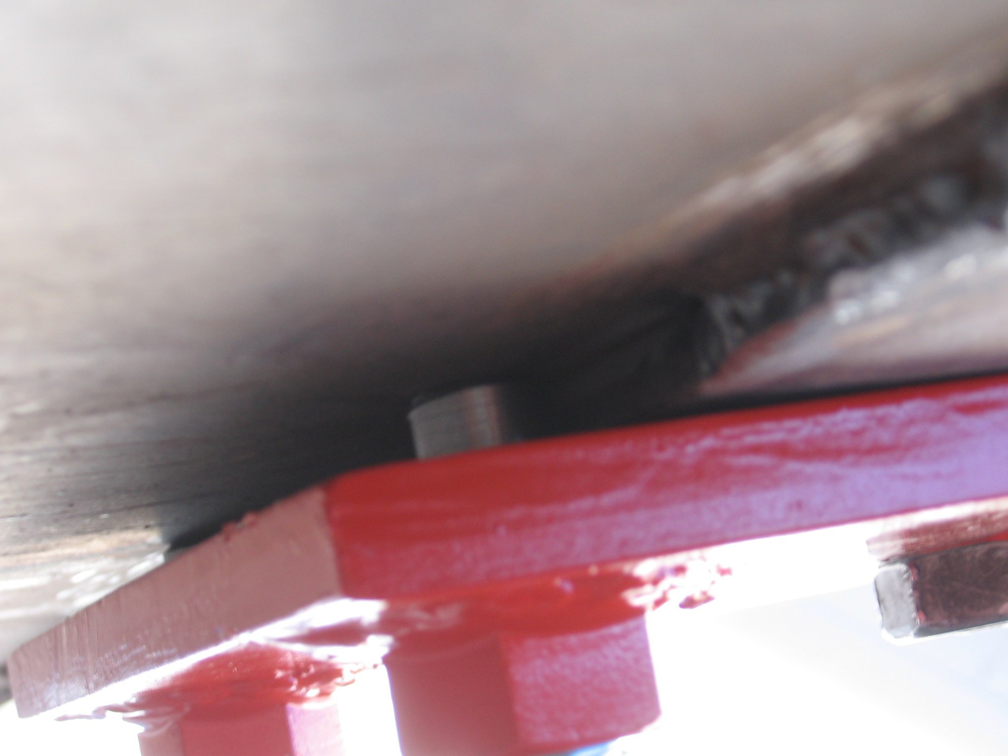

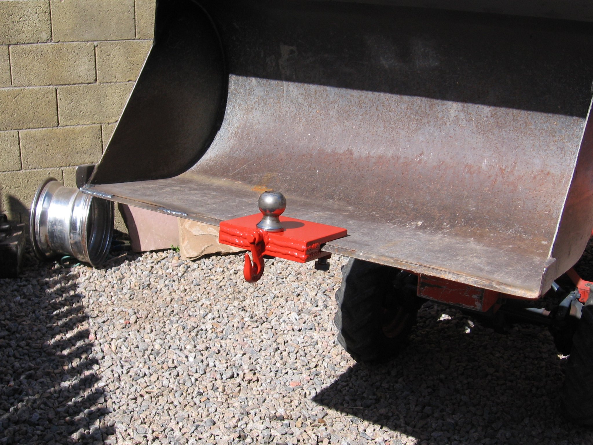

I made this:
Reactions: 6 users

I like what you did Lil Foot…. as long as there’s a safety chain used also.

These are all really good ideas. I have been thinking of what do do as well for moving a boat and utility trailer.
I have a question for Lilfoot: Guessing on dimensions 10 x 10" using 1/2 plate?
Also, on the bolts that engage under the FEL blade, are those some kind of bushings that fit over the threads?
