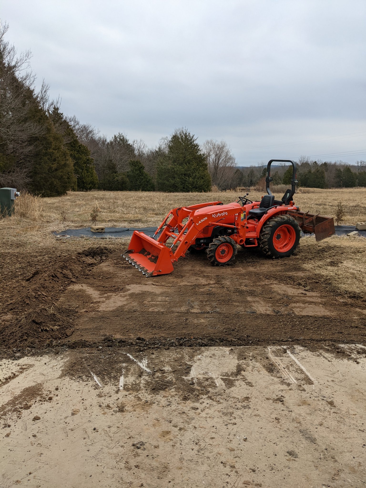

I leveled two sites (30x30 and 30x16 feet) in hard packed clay with lots of rocks. Each site had a side that was about 1.5 feet higher, but the whole process did not take that long - less than 2 days total for both sites.
I am not sure what you plan to use the grapple for with your project. I have a grapple, but I only used the FEL with the bucket to dig. I did use my box blade with scarifiers to help break the soil, but I do not think it was a big plus. The box blade's primary uses were for final leveling and spreading gravel over the sites.
You might want to buy a tooth bar for your bucket; it helps.
