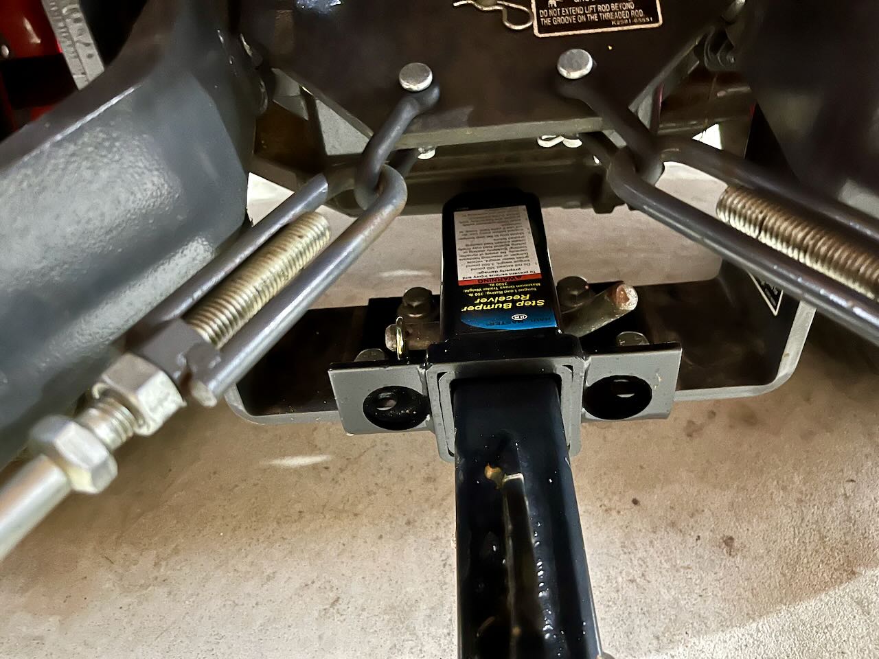

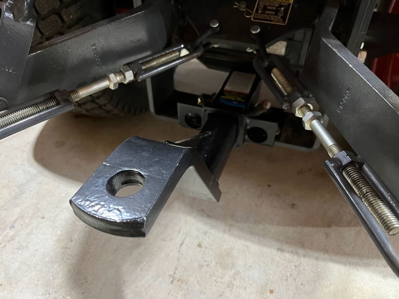

I’m not sure if your rear attachment is the same as my BX1870 but here is my solution. I bought one of these at H-F:
and one of these although any adapter could work:
The receiver’s rear two bolt holes lined up with the tractor’s bolt pattern when I took off the factory ball bracket. The other two needed to be drilled which was easily done. Now I have a real receiver and the flexibility to change the ball, for $40

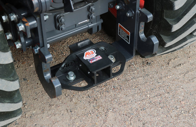

What about something like this?
I find the ability to raise and lift quite useful at times. Plus I have a 3 size adapter I use with it, as I have equipment that uses all 3 balls.
You can also buy a cheapo drawbar and put a hitch ball on it, for similar results.
Or if you have SSQA, you can get a hitch plate for the front of your loader arms. I use that when I have the BH hooked up.
That's what I have and was cheap when I bought it before the covid issue came. I think I got one delivered for around $50 off eBay. It was cheap enough that I bought one as a gift for my son in law...LOL
Today still relatively cheap for what you get. Works well for me...
