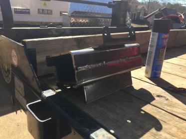

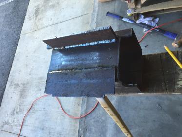

I started with a 1' piece of 6x6 square tube and some scrap 1/4 plate. I needed a 4x6 piece but my local shop didn't have any.
Here are some photos. Keep in mind I am a wood worker who dabbles in metal when I find time. The welds don't look pretty but they penetrated and are plenty strong.
Can't seem to get more than one photo to load so I will post more.

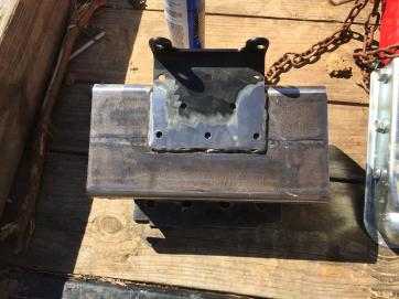

I had to cut 2 inches out of the middle. It was just to tall the hood wouldn't open. Like I said 4x6 is what I wanted.

I used rubberized under coating on it because it's nice and thick and I couldn't get inside of the tube to clean all the rust off of it. Has worked nicely for me in the past.

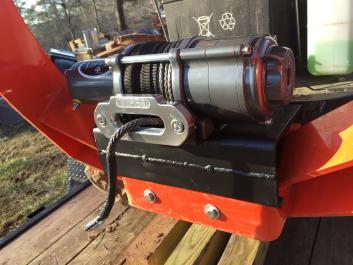

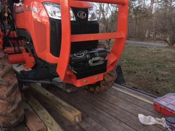

Here it is all finished up and ready to pull. I put the dash switch on the side of the joystick for the FEL and the plug in for the wired remote is in the side plastic vent below the hood.

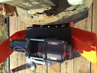

Jason I used a Viper Max 5000 atv/utv winch with synthetic rope it is unbelievably light without all that steel cable. It was recommend by a friend. Used it today so far so good.
