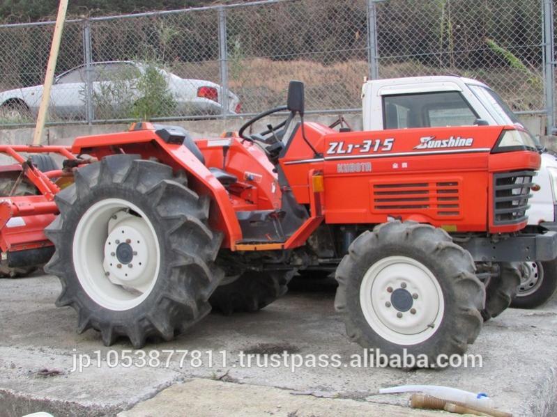

Regarding the problem of automatically lifting up the hydraulics while in reverse - I think I have found the right knob for that, however, even if I try to turn it on and off, still the tractor pulls the hydraulics up automatically. Since I am thinking of buying a car trailer and using it universally - on a car and the tractor, this option of auto lift up will be a really big problem for me.
for Corney - hello, I haven't got any pictures from exactly my tractor, but I have found exatly the same model on the internet. Please find the photo attached!
