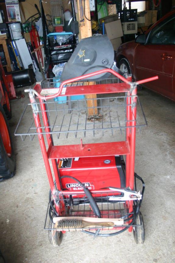

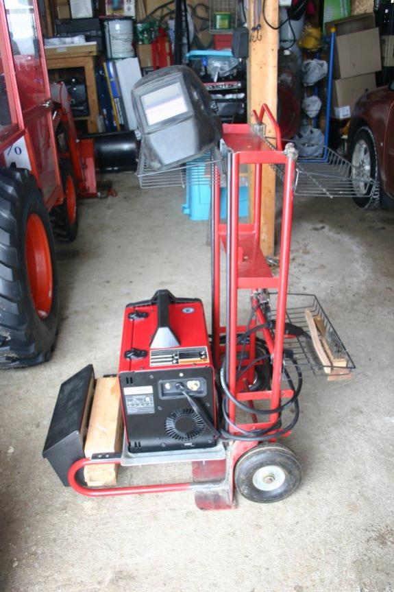

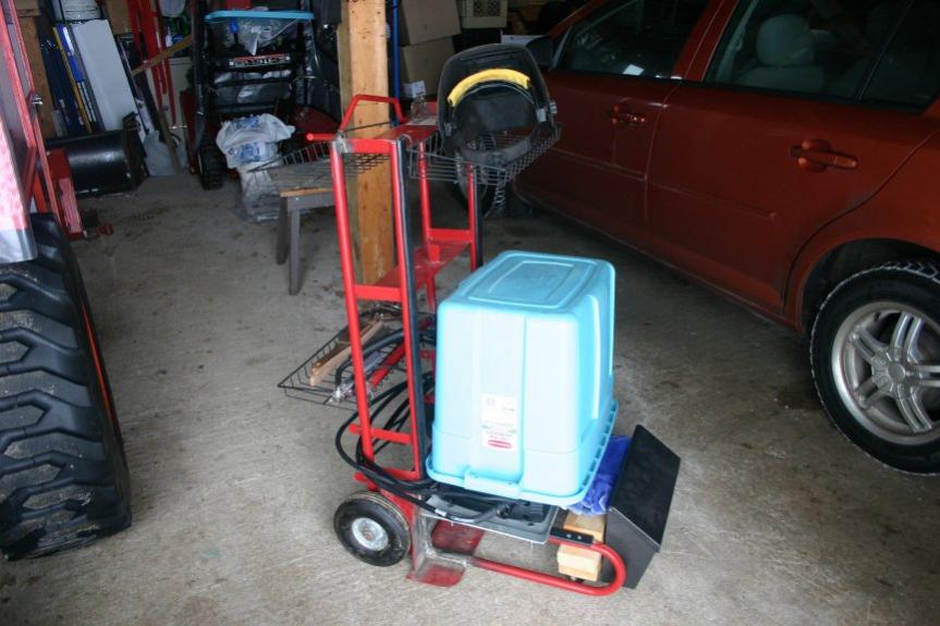

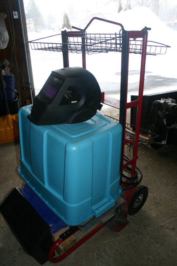

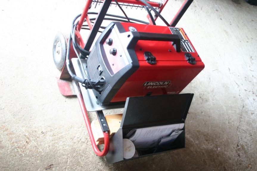

Attached pictures are my welding cart that made out of dolly.
I installed two small swivel wheels at the front too. and used mail box for sundries.:D and Rubbermaid was perfect for dust cover...:D
