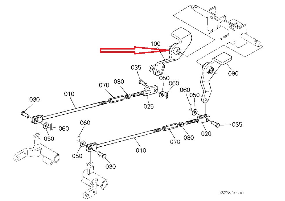

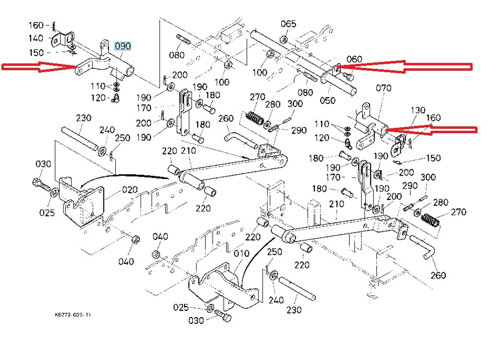

I attached a few diagrams below of the major parts I needed to order that I could not remove from the B2650.
I hope this helps and will post updates as they come.
View attachment 83343 View attachment 83344
Thank you for your detailed description & the annotated schematics.
By happenstance, I'm having the attachments installed in the order you recommend - although I'm still waiting for the backhoe.
I'll check with the tech, using your info, to make sure he's tracking the mounting parts.

I just made a post asking if there is a secret method to get that carrier shaft to slide in (#50 in 2nd pic), because the backhoe frame is in the way... Looks like the secret is there is no shortcut and that frame has to come off, ouch!
Ouch is right! I agree, the backhoe frame will have to be removed or possibly moved just enough to slide the shaft in. Sorry....

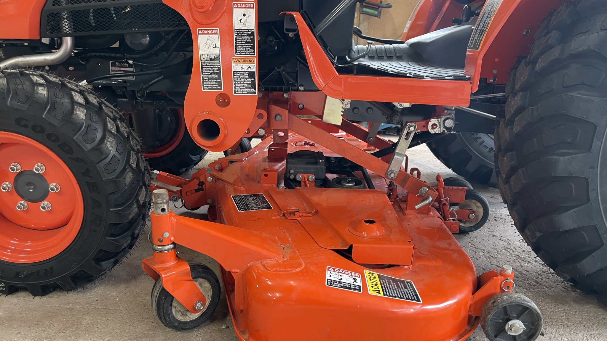

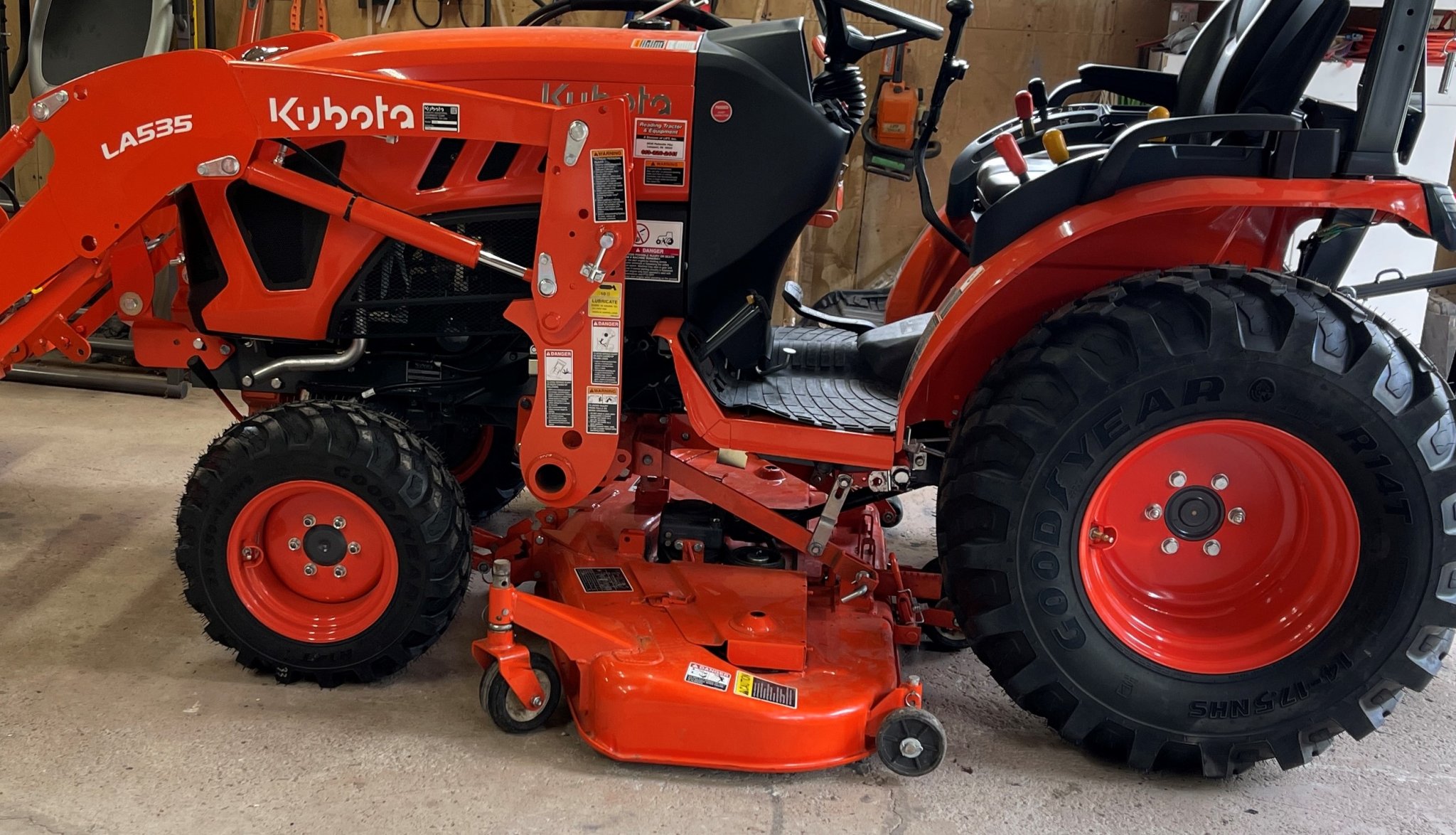

Sorry for such a long delay but I just wanted to post a few pics and confirm that the RCK60-30BA deck from a B2650 in fact fits and works perfectly on an LX2610!

It turned the few hour job into a whole day job, thats for sure! I about had a heart attack when I went to put the lift mechanism bushings (90 and 100 in the diagram above) on the 3 point hitch shaft , as there isn't enough clearance to drop them between the ends of shaft and BH77 frames. I was thinking the other side frame would have to come off too, then I realized you can loosen the bolt above the draw bar receiver and slide the shaft side to side.
View attachment 88345 View attachment 88346
I have a 2015 B2650 with this exact deck. Just letting you know that your bracket from the front of the tractor to the front of the deck is not on correctly. The pin with the clip through it goes back farther and slips into the notch on the deck. That way the pin that is in there will be back farther and keep it from moving back and forth.
