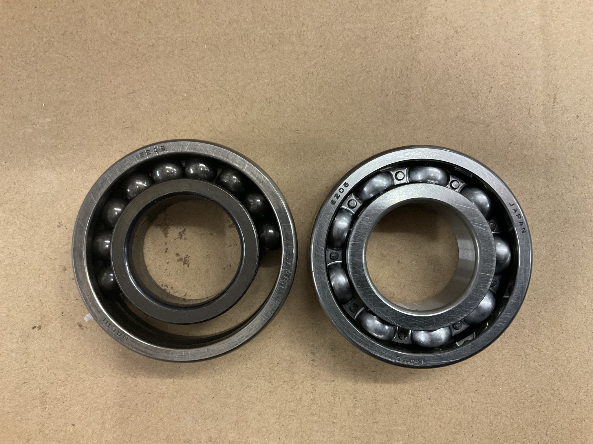

I just split my Gr2120 mower deck gear box and found the same thing. It was from a bearing race/cage. The bearing looked as though it lost some balls. After looking closely it was for sure the cage around all the balls.

Changing oil filters on kabota m7040 yesterday and found large piecescof metal in them, where could they be from?
That was a bearing cage ........... I would be breaking the machine down and find the problem BEFORE it becomes a situation where IT cannot be fixed!!!!!!
That definitely looks like the race from a ball bearing.
I would think something is either loose or making noise. Being internal is a Big deal. I would not run it until I found the issue.

For that much of the bearing to have come apart and ended up in the sump, I'd guess the "event" was a while ago and by now the rest of the debris has gone to the bottom of the gear case too, Not a nice thing to see - but if there are no new sounds it may be benign for now....
If you could put a coin or other size reference in the pic someone might be able to guess where in an M7040 there are bearings like that - where to start taking it apart.
5,579
2,947
For that much of the bearing to have come apart and ended up in the sump, I'd guess the "event" was a while ago and by now the rest of the debris has gone to the bottom of the gear case too, Not a nice thing to see - but if there are no new sounds it may be benign for now.... If your dealer knows the M7040 they might be able to say where it came from and whether it should come apart to chase it.
There is no such thing as a “benign” bearing failure.

In fact there are millions of them - most of the noisy wheel and gearbox bearings on the roads are caused by surface defects on the rollers. Many run for years that way. Once the cage is chewed apart, odds of more damage increase. Kubota gearboxes are very strong - big failures from bearing failures are nearly unheard of.

if that ball bearing came apart, you'd know it. Any abnormal noises? Operate ok? Do you know the history of the tractor?

He contacted the agent he bought it through. It's a series of problems. There had been a bad sound, he thought the gears, he had dismantled the engine, now started on the hydraulics. The initial metal sound has gone. The hydraulics seem to work again now too. It's a work in progress. He thinks all the metal has come out in the oil. The pieces together may measure, roughly, the size of a cotton reel.

That bearing will eventually explode and take out other stuff.
I would not sleep at night knowing what is going on inside.
Here is old bearing and new bearing. You have an issue like the one on left. It will give out, and I think it may be catastrophic!
Please look into what bearing went out.
