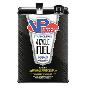

Agree with get some non ethanal gas, around here its called REC Fuel at the stations that have it.
or some VP 4 stroke or similar from like tractor supply.
Small engines are horrible with the ethanal gas the Alcohol seperates and swells rubbers seals.
Once I started using rec gas or VP in all my small engines they start right up after sitting and run great.
