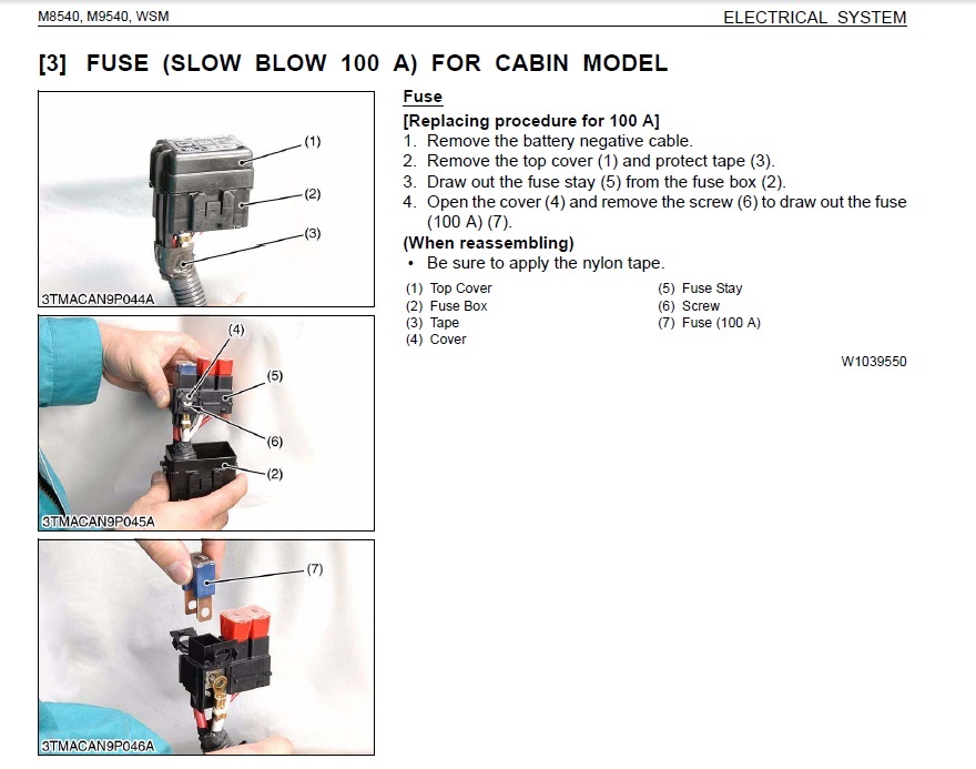

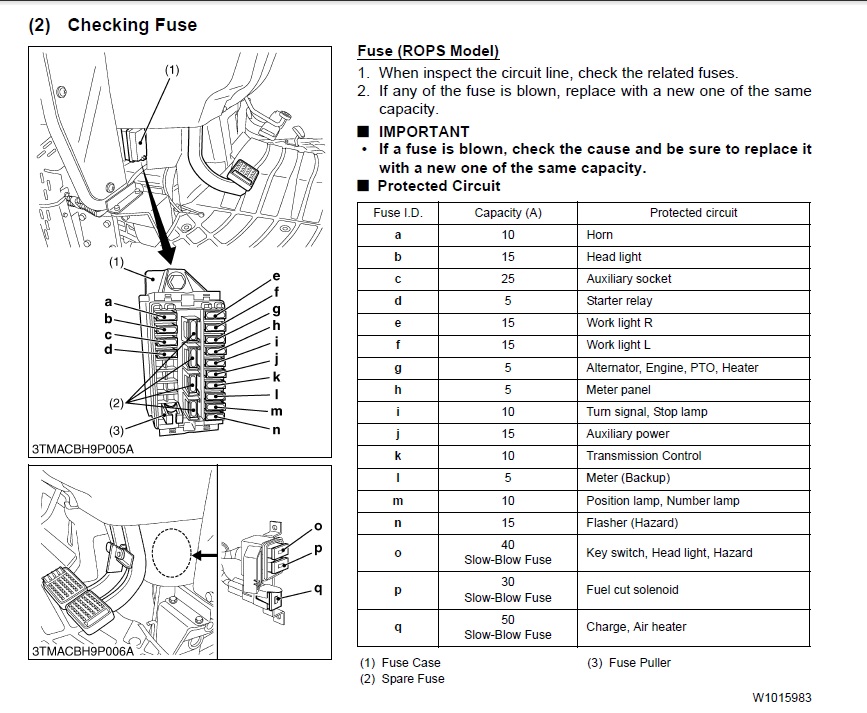

You need to provide more info on your tractor if you want to get useful help.
Cab or ROPS makes a big difference.
Some models spanning many years of production have changes the WSM may not reflect.
The WSM I can see does not show fuseable links but rather Slo Blow fuses,

It appears Dave has your tractor's fuse location shown for you.

Can you tell us how you checked them? Did you just look at them? Is there voltage going to them? And out of them?
