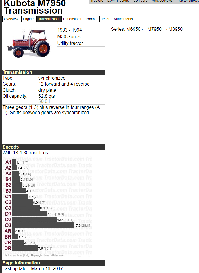

I have a 1989 Kubota M7950DT front wheel assist, there are no stickers left for any shifter. floor/trans mounted shifter appears to have 4spds forward & 1 reverse, but manual states it should only have 3 speeds. on the LH side of seat according to my manuals it should have 4 range gears (a-d) in a "winding river" shift pattern BUT it does NOT it has 2 shifters that move forward/back with rh side shifter has a word on a tiny piece of sticker that says ....."speed". can someone please help me?

By reading this I would think it would have 3 speeds forward one reverse. With a 4 range a, b, c, d.

according to operators manual, yes it "should" have 3 speed gears & 1 reverse but it definitely has 4 speed gears & 1 reverse. according to operators manual it "Should" have 4 ranges (A-D) but it definitely does not, the shifter for range as per attached diagram is not same as above pics of my present shifter setup, notice diagram shows a "lazy river" pattern for A-D but my photo of my present shifters are NOT like this at all

Looking at the parts list, it looks like that 'lazy river' is for a hydro shift DT-S. Unfortunately Messicks doesn't have pictures, so it's kind of sketchy. There are multiple transmission options on that tractor. Can you read the full model # off the nameplate, should be on the frame?

Yes, i do have a shifter in middle of floor but it has 4 forward gears & 1 reverse. I have been able to find out that this tractor is considered a M7950DT "OLD STYLE", which looks identical to a regular M7950DT & has same V4300 engine but COULD come with a "SUB SHIFT" & "CREEP SHIFT" which uses a 2 lever system same as i have on the lh side of seat along with PTO shifter & 4wd shifter. I hope somebody here can get me the proper operating information for the SUB SHIFT & CREEP SHIFT out of a operating manual & possibly even a picture of the decals so i can have them remade
