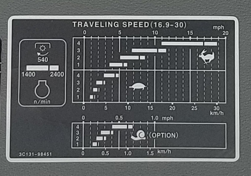

So how do you like the creep? Do you use it much? I am not sure I really need it but for $850 I figure why not. This is the tractor purchase where I dont want to run into a "I wish I had gotten...." at some point down the road. I originally was looking at a MX5600, and played the "well for only a couple grand more" game until I ended up at the M7060 12 speed.
mcmxi
4,710
5,452
NW Montana
I'm with you on options and would rather have it and not need it. I use creep to get on/off a trailer but not much else at this stage. But if I ever need it I'll have it. As you can see from the sticker on the sun visor, creep range is very slow.
I dont know how 1st on the M's compares to my TC45, but I found when snowblowing really deep snow it was too fast.

I have a 2023 7060 with ever option you can get except rear window defogger and wiper ( which I regret not getting)! I really like the creep for close contact work like trimming limbs, hooking up rear attatchments, etc and I do have a quick hitch and top/tilt, anything where 1 low is not slow enough. The KSR for the loader is sweet when carrying logs, hay bales, etc across fields. Get third function for sure, the factory 1, all hard lined. It is a much cleaner setup! When changing gears 1,2,3, etc, you do'nt have to clutch it either, just move lever on steering column to neutral, change gears and go. You do have to stop when changing ranges though. Might would have gotten a m4d wide cab if they had one at the time I bought but, the M7060 has done everything I need.
Oh yeah, creep does help when inching up to an implement so I use it for that too. I haven't tried using the hydraulic shuttle to shift gears, mainly because it's so easy and natural for me to depress the clutch as compared to moving the shuttle with my left hand and the gear shift with my right.
