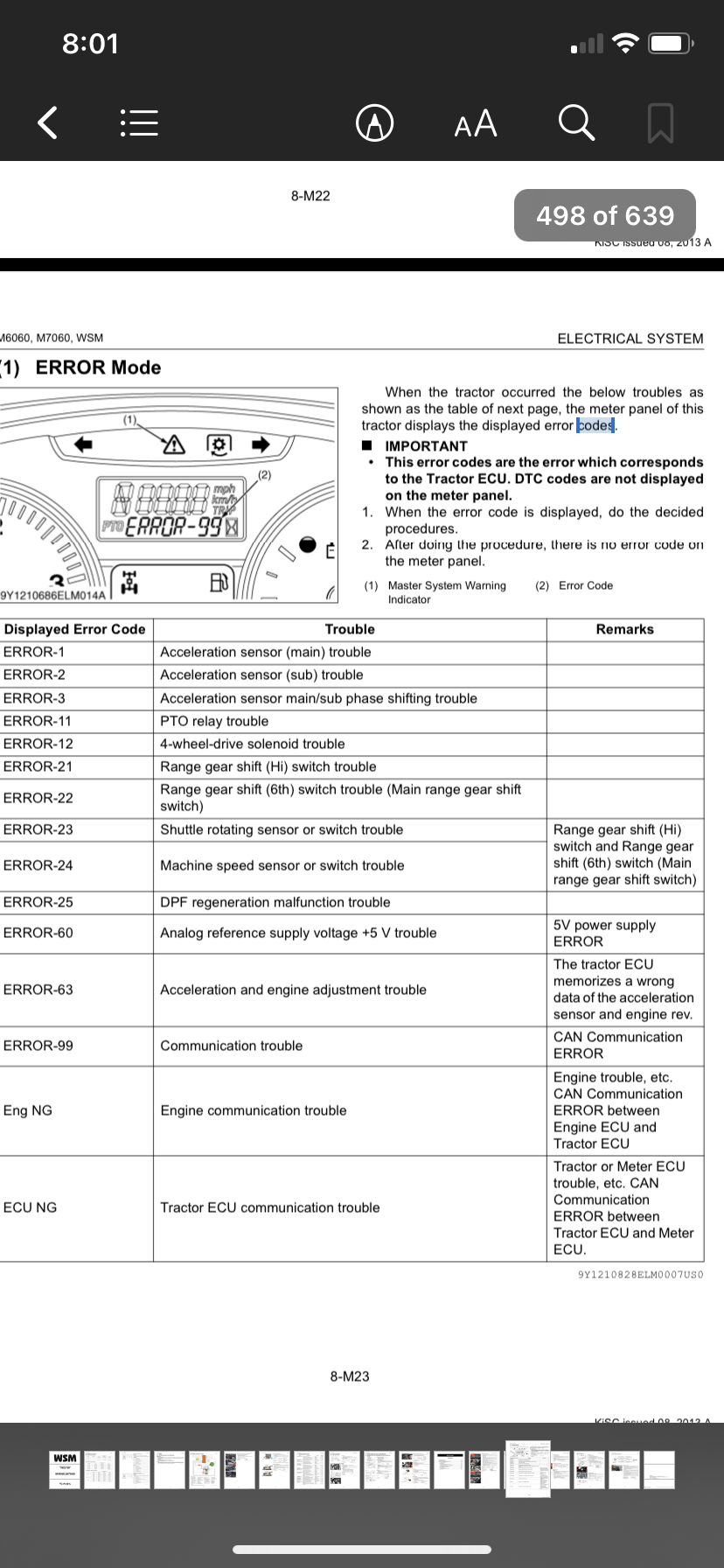

M7060 showing codes 1 & 2 . Accelerator return spring was broken and has been replaced . How do I reset or clear the codes . Tractor will not run over idle with codes flashing .

Think on this a minute.
The ECU only knows voltage, frequency, and ground-nothing else.
The ECU is reporting that there is a trouble with the throttle sensor. It's not seeing the voltage frequency or ground that it is expecting, thus telling you via the panel that there is trouble.
that leaves you with this. You have a sensor trouble a ground trouble or wiring trouble. Possibly ECU trouble although not likely. The question is, why'd the spring break? Was there anything that could have gotten jammed into the pedal or lever, which may have forced the pedal/lever too far in one direction? If so, sensor damage would be likely-that or wirings.

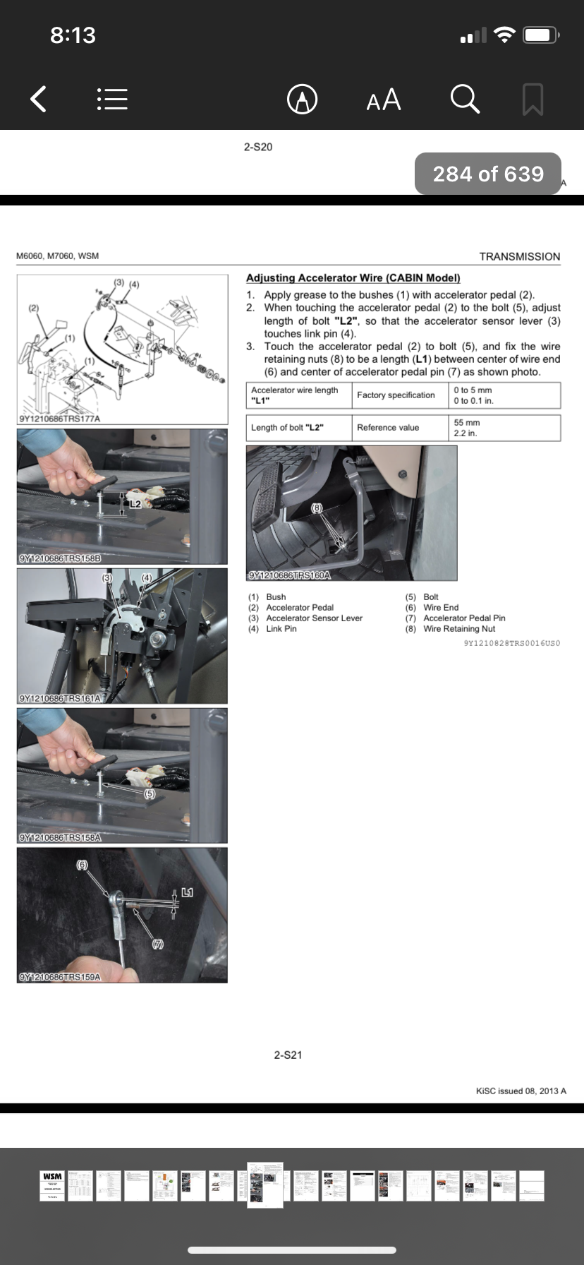

I found the problem on the new to me M7060 . The hand throttle was not in the correct linkage location and would not allow the rheostat that controls the electronic throttle to return to the proper location in addition to the (very small) return spring being rusted and broken . When repaired the codes automatically reset and the tractor operated perfectly ! Thanks to everyone for your help with this problem !!!
