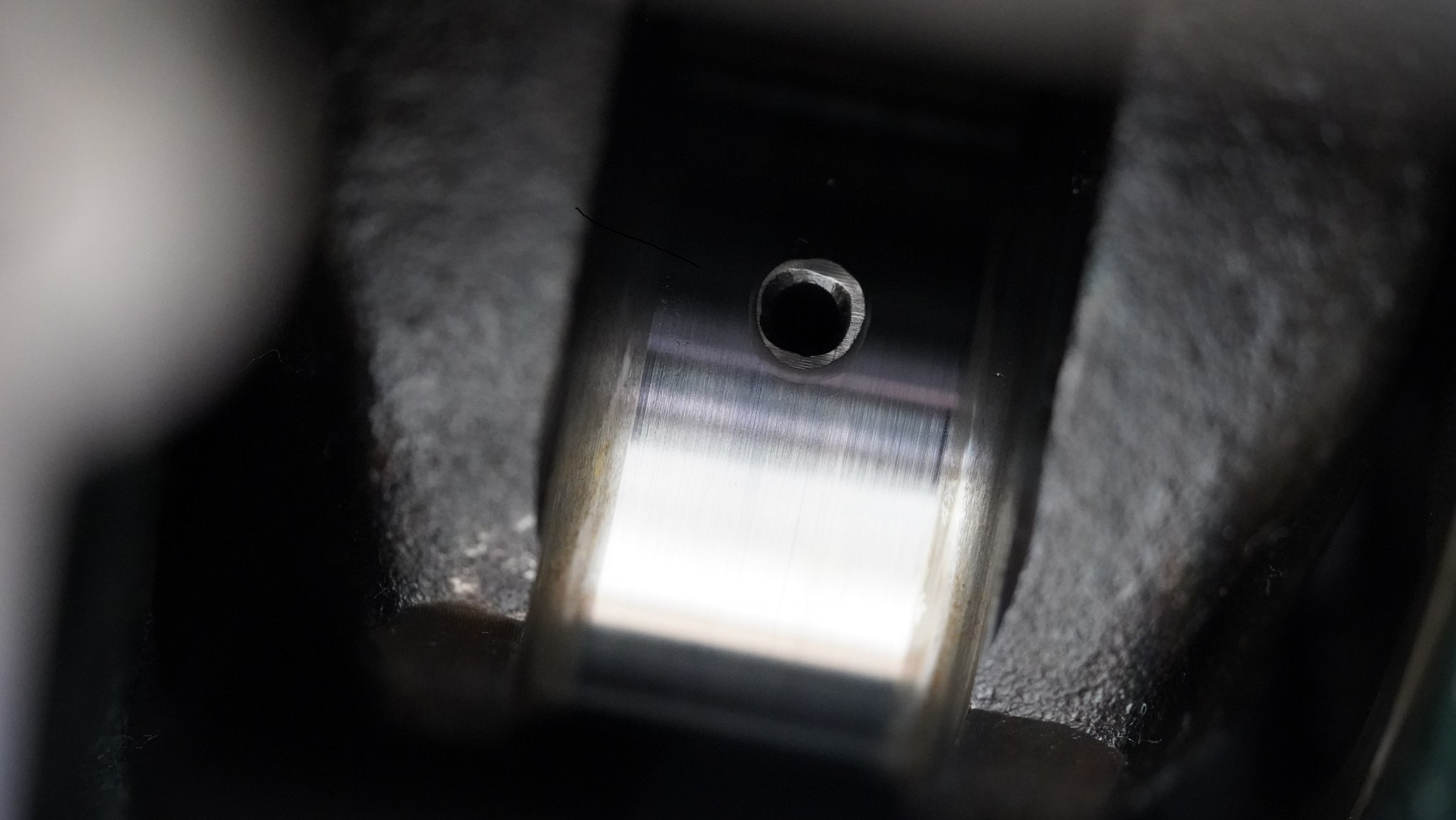

I have the engine stripped, pistons out, cam shaft out but the mains are left in because the engine is still on the tractor and it is staying there. I don’t want to go as far as remove the block. I am hoping the mains are okay, the rod bearings have some wear and some contaminant scoring, they are not shot or spun but new ones are going in. I would like to run a cleaner through the crank and through the mains and flush it out of the rod journals. What’s the consensus on cleaning through with kerosene then I have hot water detergent flush, final rinse hot water, blow air and run oil through passages? All other galleries and components I have brushes for, tappet guides, rockers and cam can be cleaned with brake cleaner then oiled.
I have read to use X prime pump to run cleaner through, then using it to prime oil pump with new oil and prime until oil pressure is showing on gauge and running out of the rockers.
Other method suggests to use the oil pump itself on a drill and feed oil through before cranking.
I could also use the oil pump to run kerosene through the system first to clean it, the pump has had some wear and I am installing a new oil pump anyway. I thought a better way would be to back flush kerosene/cleaner through the rod journal holes backwards through the mains, this would push any contaminant through the center of the mains and back up the oil feed line, but I can’t think of a practical way to do it. Also what’s the Recommended assembly lube for start-up?
Second I have some ridge on one of the cylinder liners about 1/3 way around the cylinder at the combustion side which doesn’t pass fingernail test. I am to understand It is bore taper from detonation. All other cylinders have some ridge which can hardly be felt with fingers, passes fingernail test and I think will hone out. All cylinders measure within manual allowance limits, including the bore tapered liner. My question is does the ridge need to be removed on the bad cylinder? Old rings are pretty worn and I am replacing with new ones. I was always told to remove ridges putting new rings in because they can break or damage the ring lands?

If contaminants scored your big end bearings then your mains are just as bad or worse.

This is the scored one and wear on the combustion force end. All other 6 like this. 40 years of wear. I wouldn't think mains would be as bad because they rotate and don't have to stand explosive forces. I am no scientific engineer but I reason the mains would be no where near perfect but wouldn't think they could be worse than the big ends, why would you think they would be worse? I don't expect the engine to last 20 more years but if i get a few years of little use slashing 3 times a year I would be happy if I done have a catastrophic failure?

OK... not worse. But any damage from contamination will be common to any force lubricated part. If all you're looking for is another three years then you might get them.

I don’t understand how you can have a ridge half way down a cylinder “which doesn‘t pass the fingernail test” with bore taper and still measure within tolerance. You can make them look pretty with a ball hone but it won’t make them square and concentric. If you have contamination scoring on the rod bearings, I’m sure the mains will show the same. If you have that much contamination in the lube system of that engine, there’s really no way to efficiently clean it without a hot dip tank.
Seriously, I hate to see anyone make a 1k mistake.
