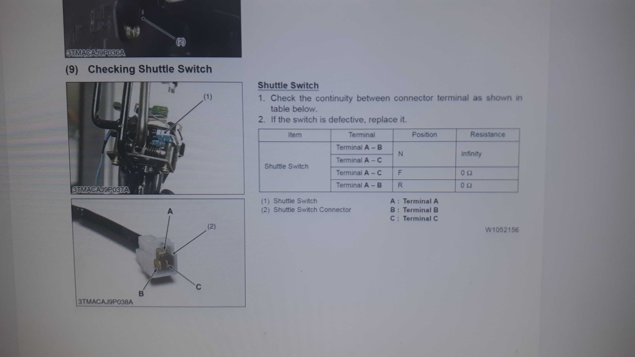

I checked it, you and another member sen't me the pdf, I can't thank you enough, when I get this figured out the first thing I'm going to do is come on here and tell you all what it was, Rob.

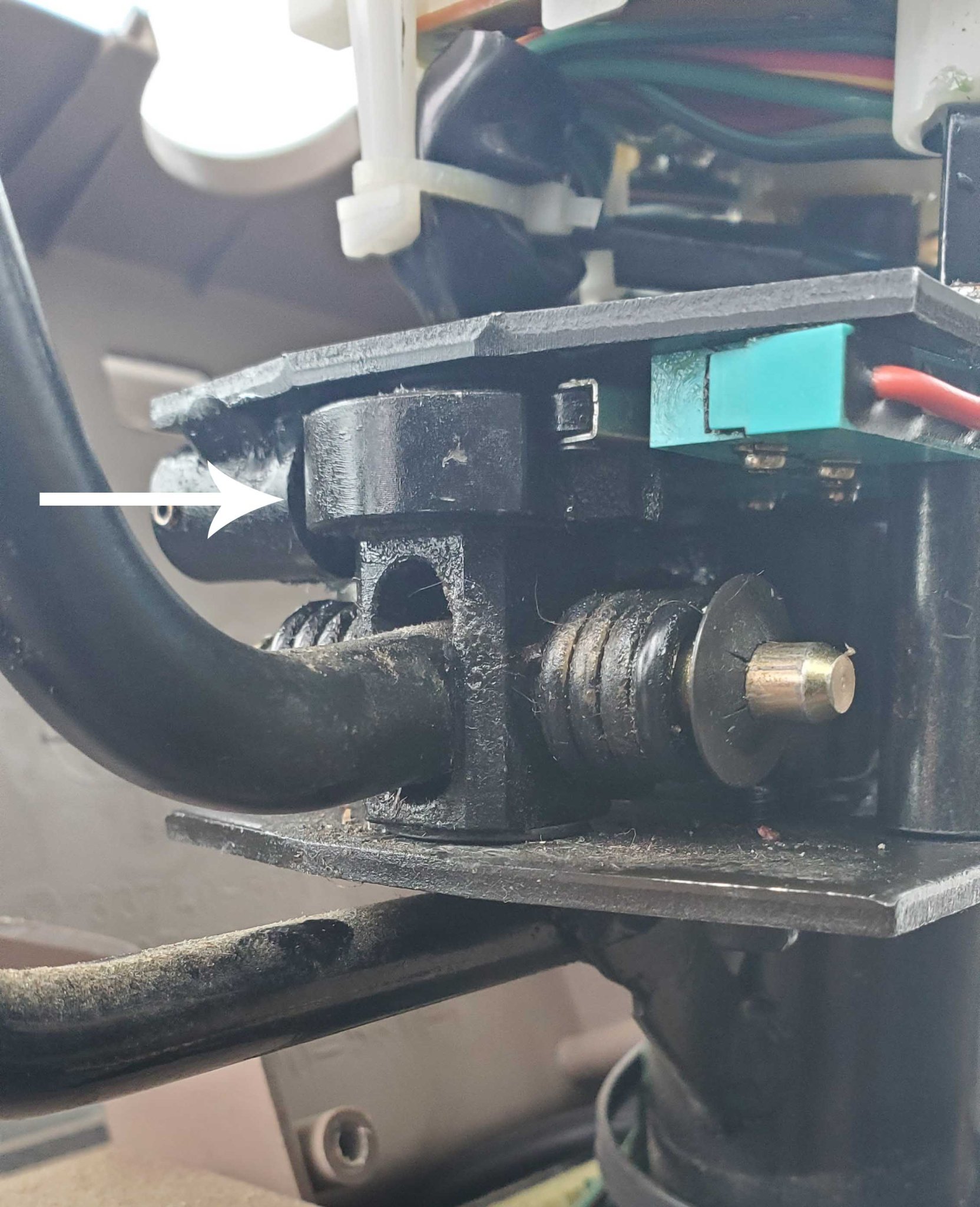

Well I figured it out, thanks to Fedup for the pdf, the problem was the forward switch on the shuttle shift, the lever with the little wheel wasn't pushing the button far enough in to engage the switch, using needle nose pliers I bent the lever out a little as you can see in the picture, this provides a little more pressure on the switch button from the cam on the shuttle lever as it's pushed forward

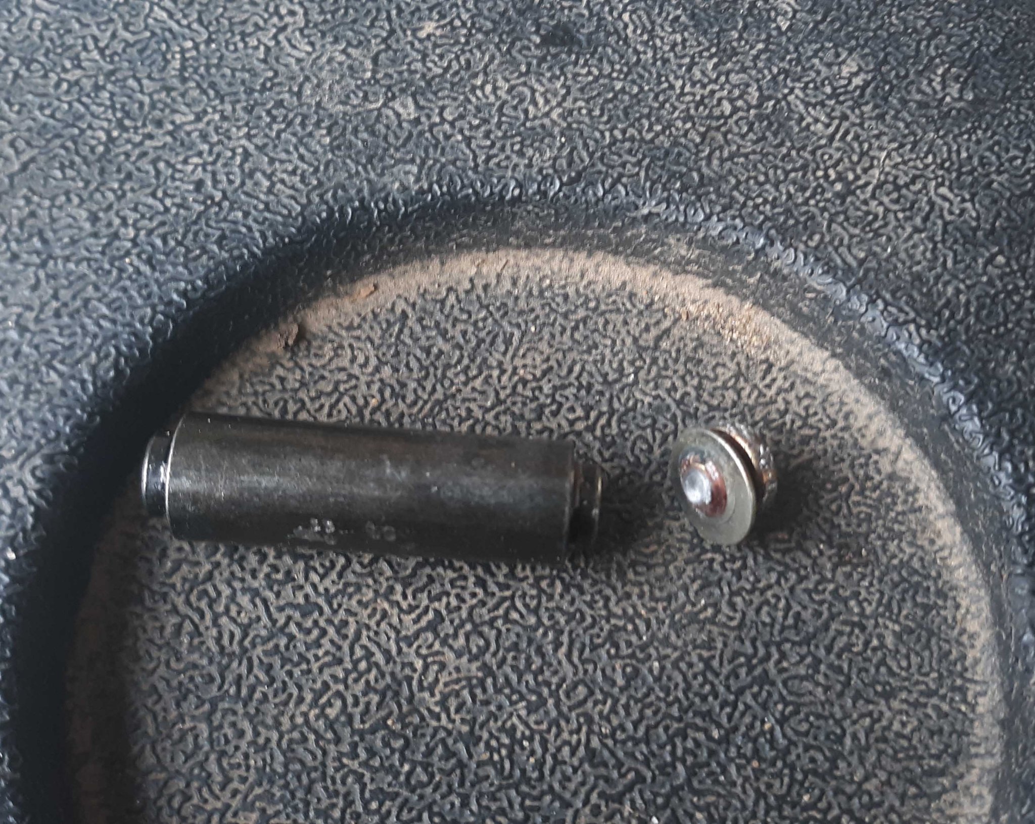

You have to remove this plate, unfortunately it looks like they used lock tight on all the screws, it was Hell getting the plate off, had to use vice grips to get that screw out!

Remove the post, there's a screw on top and bottom, I broke the screw on the bottom, thank God that's the only screw that broke, I put it back together without that screw on the bottom and it looks like that will suffice, the little post on the opposite side doesn't need to be removed, but the top screw needs to be removed to get the plate off, it's so tight the Phillips head screw driver had no chance, barely had enough room to get vice grips in there, thank God I didn't break that one!

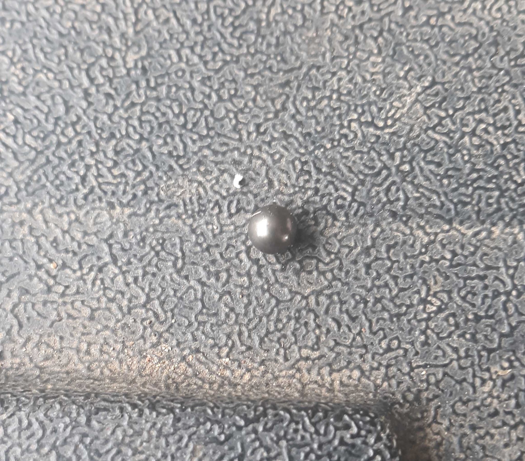

There's a little ball bearing where the arrow's pointing, don't let that fall out and hit the ground, you'll never find it.
