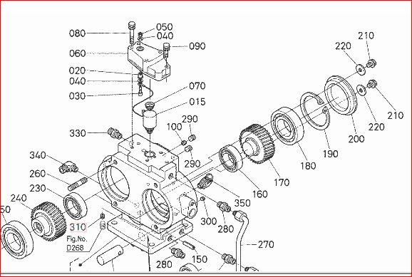

I'll pull the switch today and see where we're at- from the parts diagrams alone it looks like the hydraulic clutch valve, presumably where the solenoid is, might be a little tough to get to.

33,391
8,703
Yep on top of the transmission right behind the 2 hydraulic pumps.
