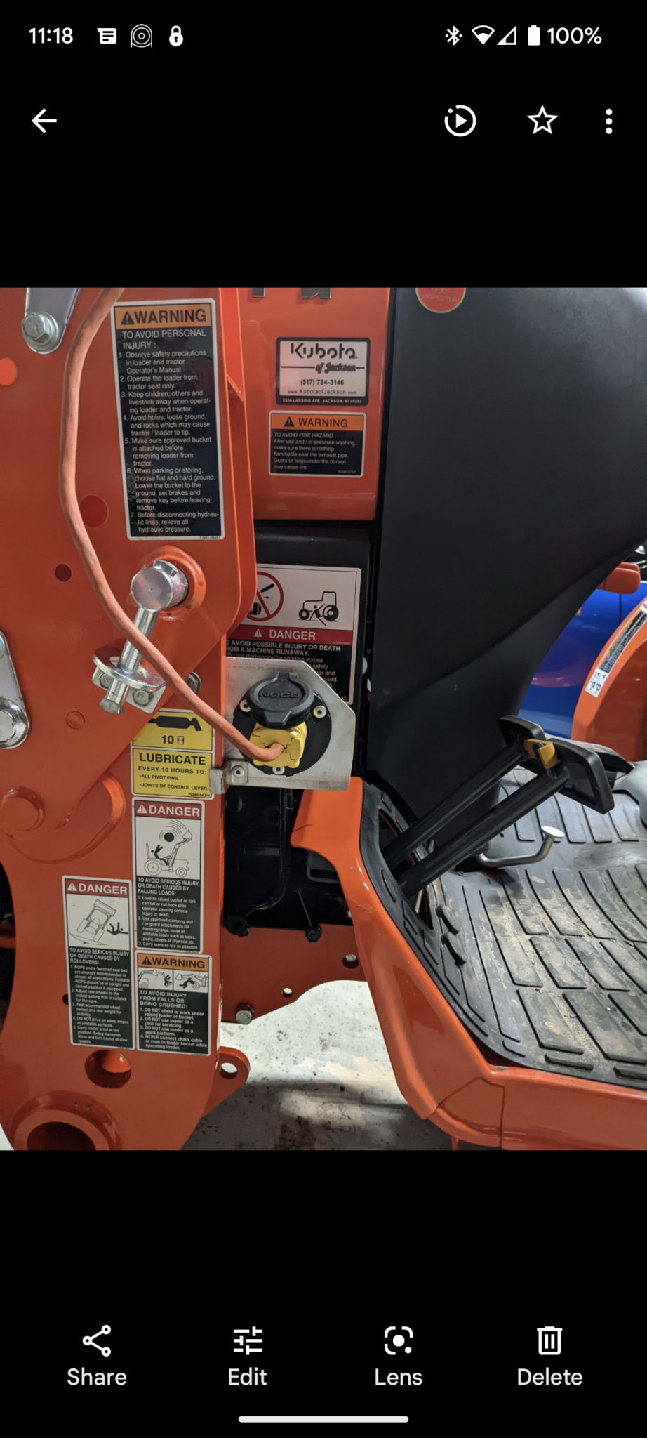

For anyone that has either installed a block heater themselves OR had a block heater installed on their lx3310.....
Do you know if you had to reprogram the tractor's computer in order to initiate cold start or was the Kubota blockheater a plug in play that required no additional programming for the ECU?
