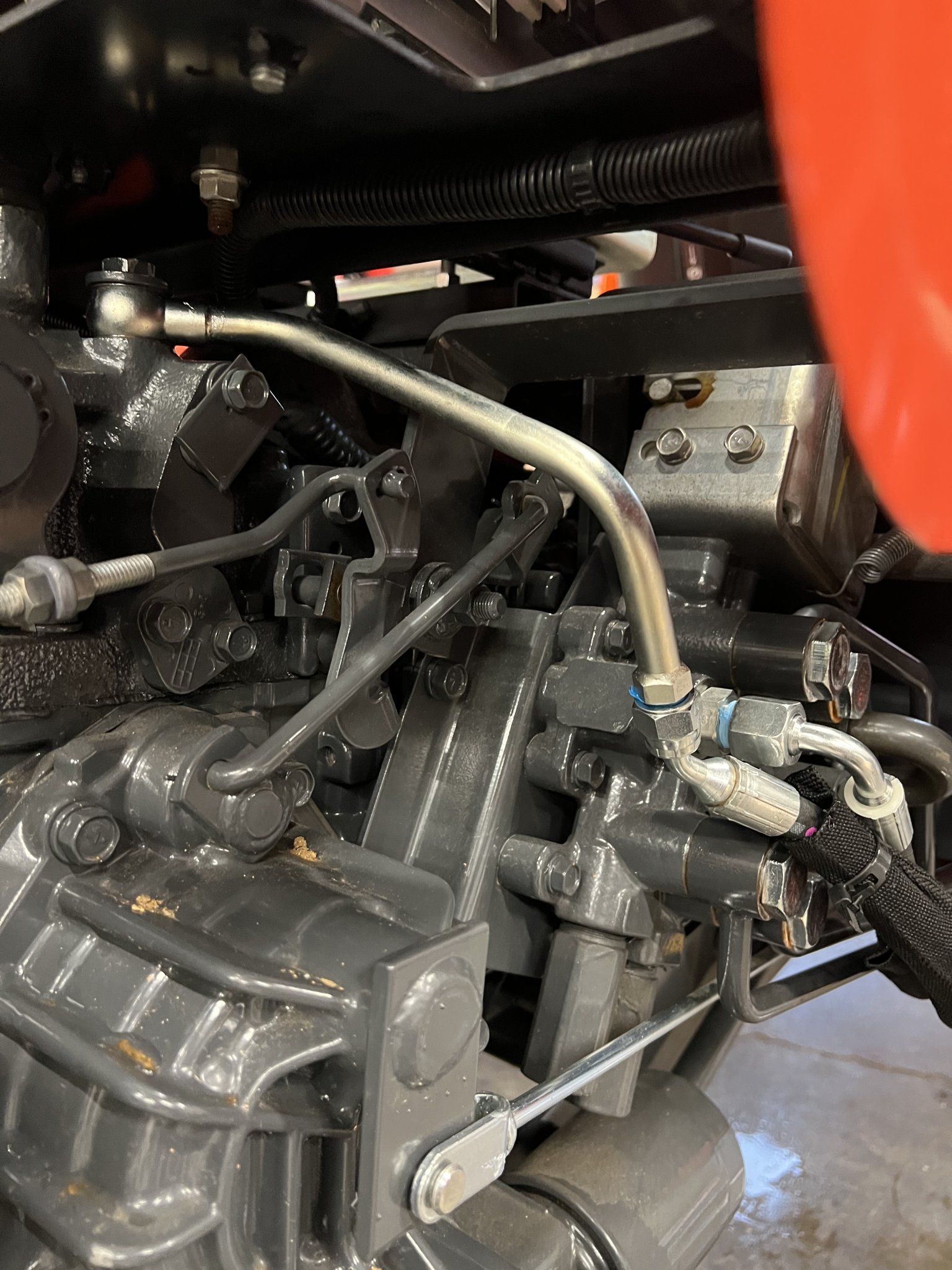

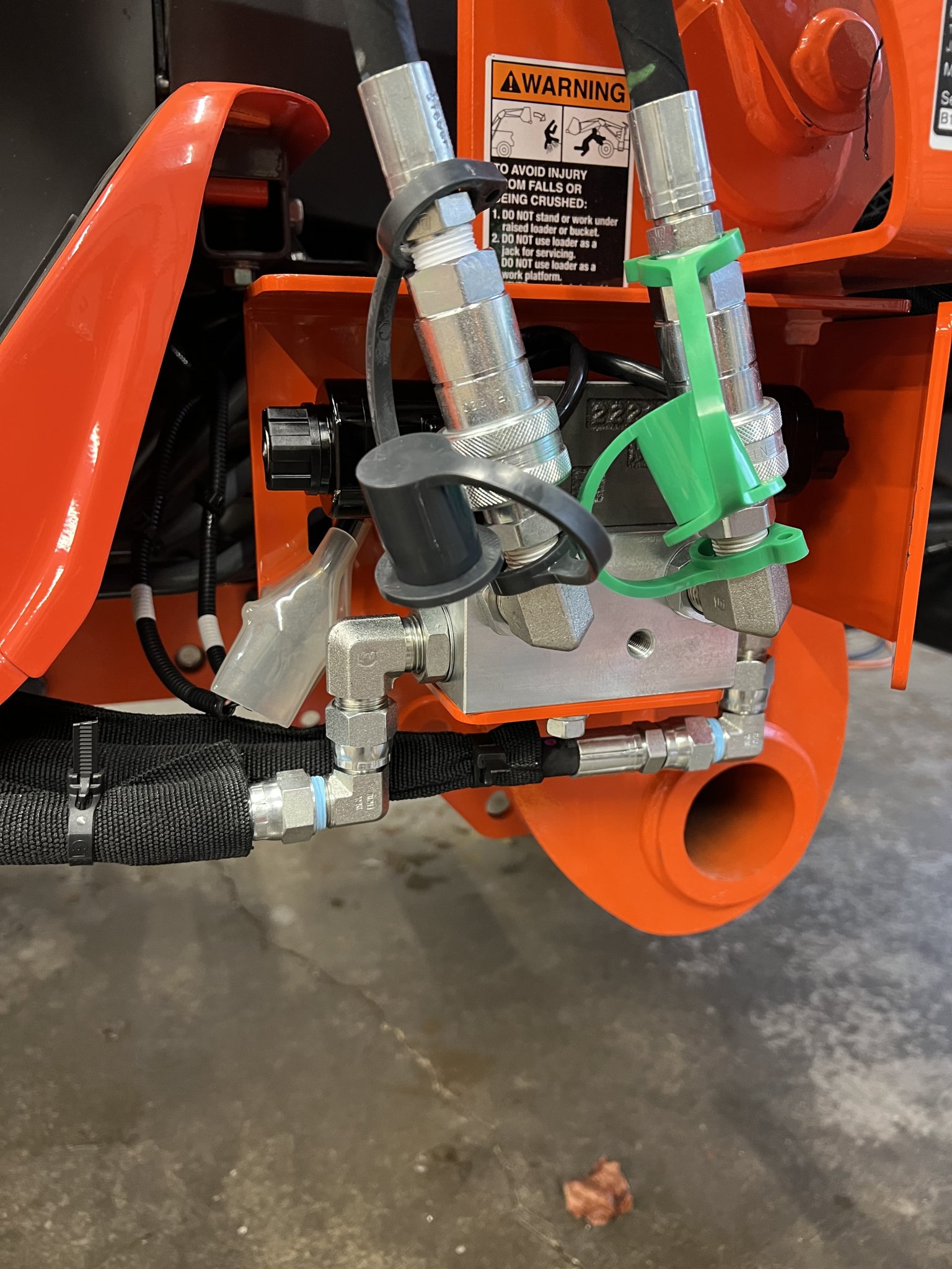

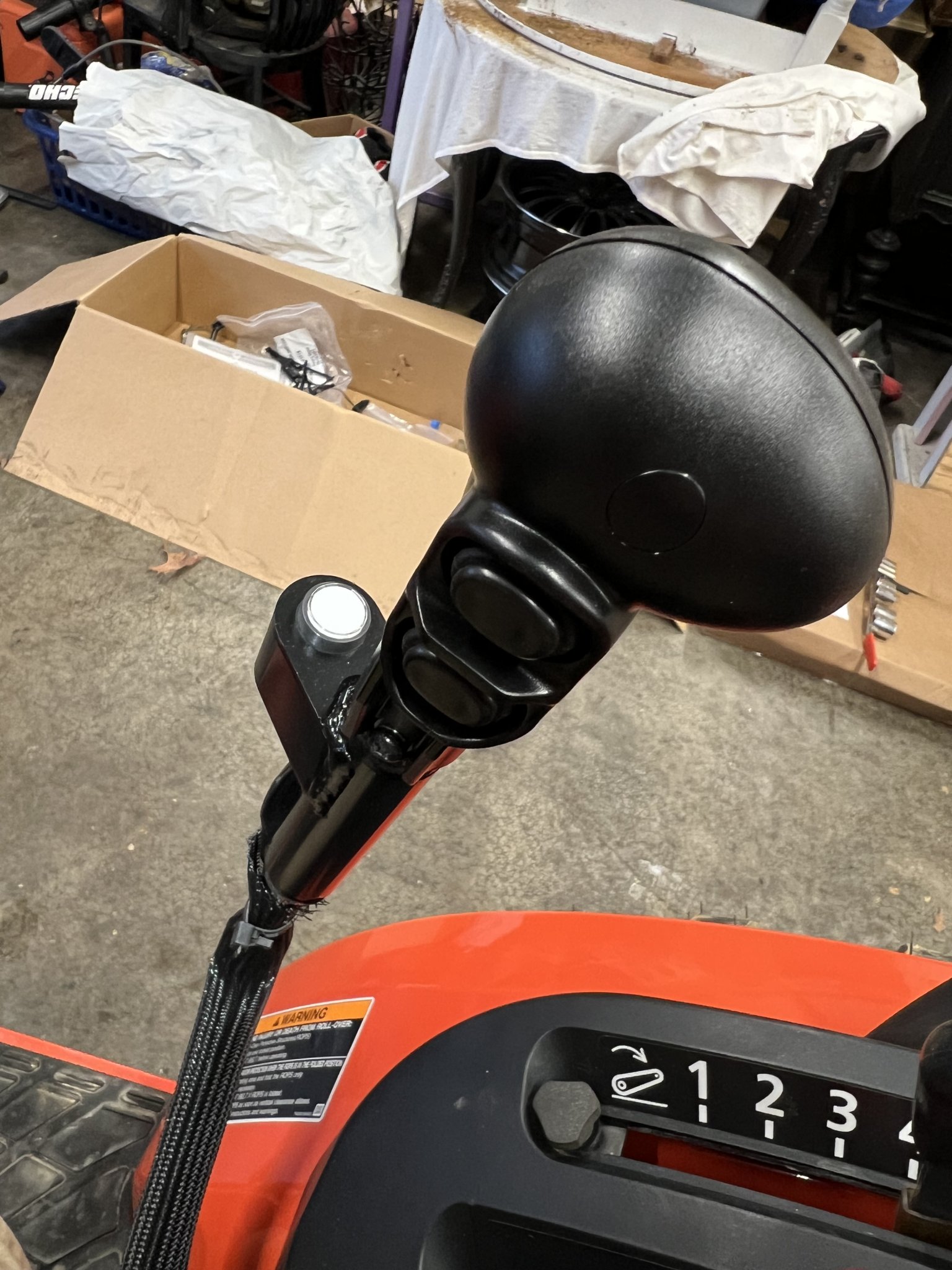

EC135P3H
LX2610SU
Nov 24, 2024
17
Georgia
I got the kit installed today. Fairly simple install, I didn’t have to remove the fender or the seat. The hardest part was figuring out the wiring. The directions were poor for that. I ended up pretty much figuring it out on my own. I took my time to ensure it was ran in a way that was protected and secure. Could install another kit in half the time now I bet. IMG_2093.jpeg IMG_2091.jpeg IMG_2092.jpeg IMG_2090.jpeg IMG_2088.jpeg IMG_2084.jpeg
