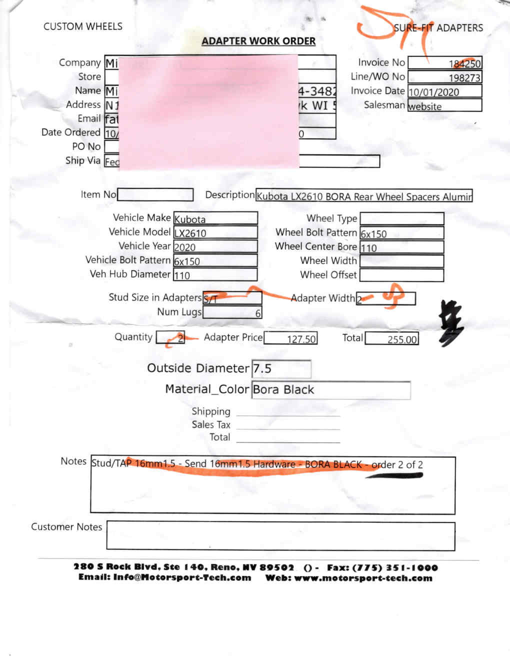

Today I finally had time to install my BORA 2" wheel spacers. The fronts were easy, Since I had loaded rear tires, I thought the rears would be more difficult than they turned out to be. For the rears, I jacked up one side at a time so the tire just cleared the floor. I removed the two nuts and the four bolts and gently worked the wheel off the flange until it was free. The wheel/tire was easy to roll off to the side while the spacers were installed. Everything was torqued to spec for the spacer and the wheel once it was reinstalled.

The rears were necessary when I need to put my chains on, to provide clearance to the inner fender.
