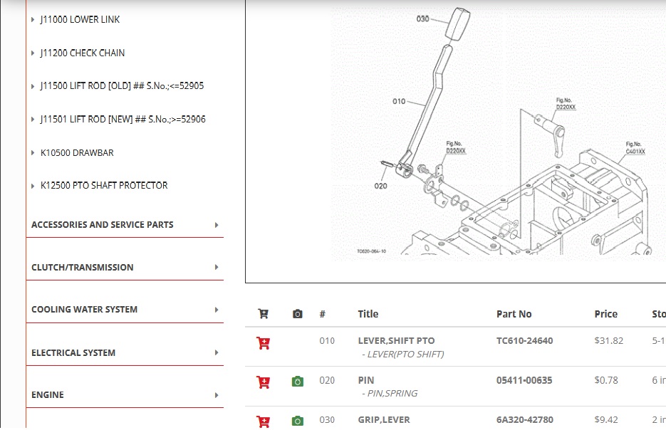

Had this cable problem from the get go with my 3301, even replaced cable by the dealer soon after delivery. I am thinking of a way to make a lever system or similar to do away with the cable. Anyone with ideas or has done this would pass on the info. Would be appriecated by me and others I presume.
thanks.
old and tired
L2800 HST; 2005; R4
...I am thinking of a way to make a lever system or similar to do away with the cable. Anyone with ideas or has done this would pass on the info...
I assume you have HST... the DT model and F (2 wheel drive) have the lever to engage the PTO. Only problem is that it's pretty close the the reverse petal of the HST, thus we have a cable...
I could access mine pretty easily to put a shifter on but my cable works just fine...
Yes I do have the hst Old and Tired. Thanks for the diagram.
