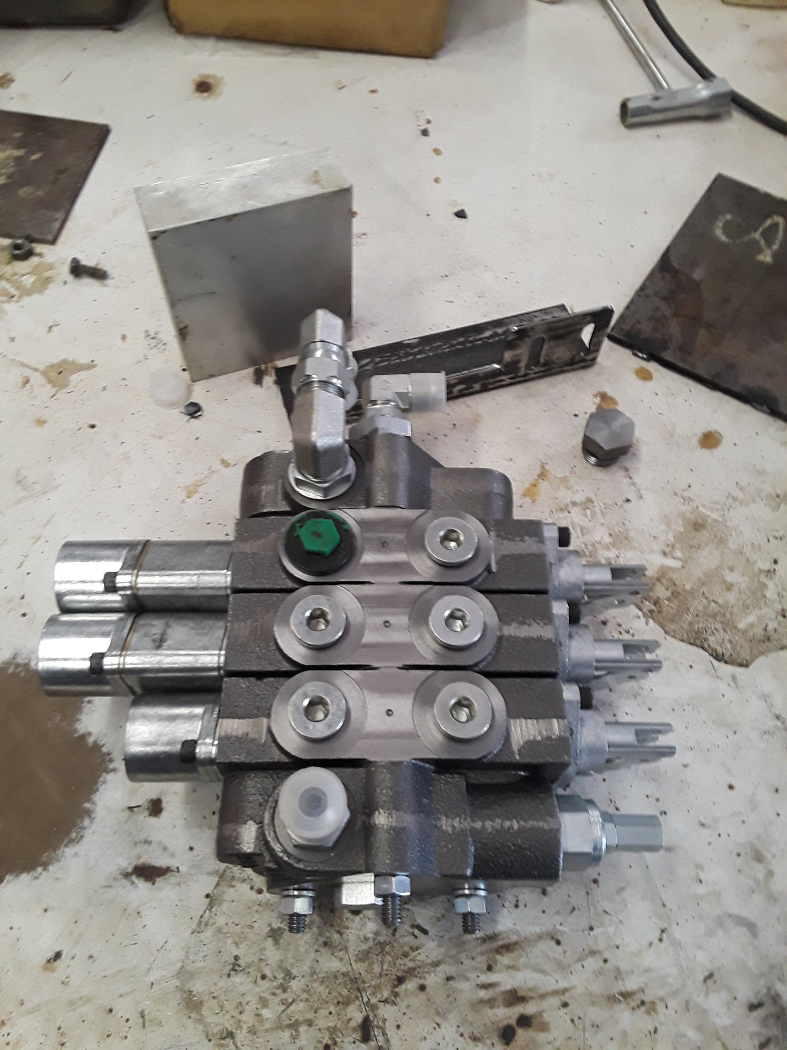

Already bought the post driver shaver HD8
It has the valve body with lever
2 hose one small and one large as the return fluid needs to exit without resistance
My tractor has no rear remotes
Does have a few
Has power steering
The loader is fed from a block to the left under the seat.
My thought was to have a quick attach from the loader function where as the loader could be unhook and the post driver using that hydraulic circuit..... or possibly a T of the fel circuit too a quick connect
Does have a few
Has power steering

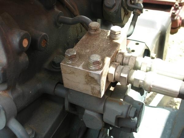

Hope I'm not confusing things, but I've had a few L345/L355s so here goes:
On L345 and L355 models there is 4-bolt cap under the seat, left side, that connects two high-pressure passages in a valve body. To install a loader valve, the cap is replaced by an aluminum port block (like in the pic below - part no. is 70050-00279).
The block's front port sends pressurized oil to power an aux valve (like a loader) and the rear port gets high-pressure oil back from from the aux valve's power-beyond port, for powering the 3-point hitch.
I'm jumping ahead on Dave's post a bit - sounds like your loader valve is connected to a block like this already. Kubota loader valves usually have 7 hoses, one of them being the "power-beyond" hose going back to the block.
A direct way to get power to your post driver would be to feed it with a new control valve connected in series with one of the high-pressure hoses that now goes from the block to the loader valve. The loader's power-beyond hose would instead become the supply hose for the new driver feed valve, and the new valve's PB hose would go back to the port block. Clear as mud, eh? Basically the two control valves would be in series with the second one's "power beyond" going back to the 3-point hitch. Meanwhile the driver's big exhaust tube can be simply stuck into the oil-fill plug.
Don't know the GPM of the hydraulics on the L355 - but it only effects the speed of lifting the ram up after a hammer stroke (good video here).
On L345 and L355 models there is 4-bolt cap under the seat, left side, that makes two high-pressure ports from one source. To install a loader valve, the cap is replaced by an aluminum port block (like part no. 70050-00279).
The block has two ports, one to power an aux valve (like a loader) and the other to connect high-pressure oil from the aux valve's power-beyond port to run the tractor's 3-point hitch. See attached pic.
I'm jumping ahead on Dave's post a bit - sounds like your loader is connected to a block like this already. A loader valve often has 7 hoses, one of them being its "power-beyond" hose.
An easy way to get power to your driver would be to install its new control valve in series with one of the high-pressure hoses between the block and loader valve, moving the loader's power-beyond hose to the supply port of the new driver valve instead, and the routing the driver valve's PB hose back to the port block. Clear as mud, eh?
Don't know the GPM of the hydraulics on the L355 - but all it effects is the speed of raising the ram before the next whack. Spring and ram-weight do the hammering. vid here

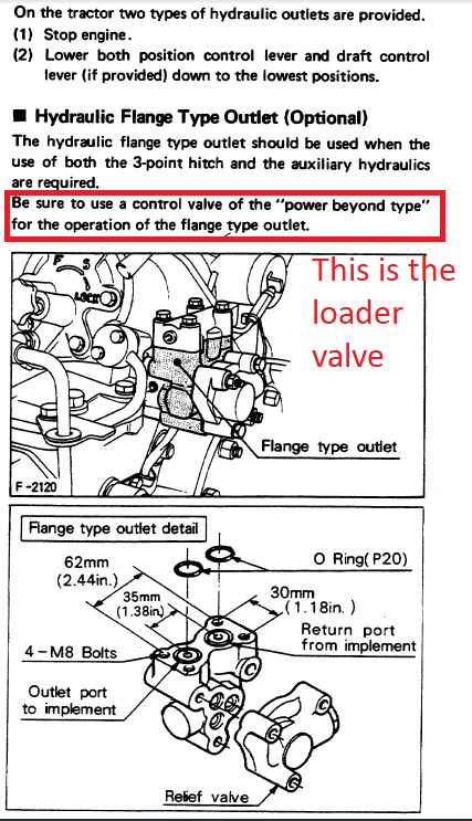

Those drivers have an open center valve and simply use the hydraulic cylinder to cock the spring. Pulling the lever fires the spring, exhausting the oil and releasing the hammer. Plumb it like any other open center valve. Are you sure the loader valve does not have a power beyond port for the 3pt? That would be the preferred plumbing but you could use the tank return if push came to shove.
As to flow I have added remotes for that exact model Shaver to ancient 3 GPM Ford tractors and it worked fine.
As I understand the L series flange type outlet, when there is a loader, the loader valve must have a PB circuit which is plumbed back into the flange type outlet to supply the 3 pt hitch. In brief, the loader valve must have a power beyond!
Since the Shaver driver does not have power beyond in its valve, I do not see how it can be inserted into the PB circuit between the loader valve and the 3 pt hitch.
See literature below on this matter.
Suggesting to use the loader tank return as the supply for the driver valve will subject the loader valve Tank port to pressures far beyond their design. Yes people have done this.
I would not want the responsibility for someone else's safety with this plan.
If you have other options I welcome them.

If as you said the loader is powered by the hydraulic block near the seat, and, if you only have 6 hoses connected to the loader valve something is amiss.
The Owner's manual page explicitly states to use the flange type outlet the valve connected to the outlet must have power beyond.
Try and clean up the loader valve so you can see any markings cast into the valve body.
Specifically, I want you to look for a T.
If you find a T trace the hose to see exactly where it goes. If it connects to the flange type outlet, the loader is plumbed incorrectly and is dangerous because of the risk of the loader valve body splitting and spraying oil at pressures high enough to pierce the skin.
The T port will be rated in the range of 400 to 450 psi. When you lift a weight on the 3 pt hitch this pressure can rise to the system max of perhaps 2,000 psi.
Dave
6,889
3,327

Hi Grace,
Thanks for our sidebar confirming which loader valve you have.
The Kubota L355ss tractor was usually sold with the model 1720 loader. It was supplied with a Cross BA 2-spool control valve, usually with 6 hoses. On the side of the valve is a large hex head plug that can be replaced with this $20 part to convert it to a power-beyond port.
This PB sleeve should work fine as a power source for a hose to the driver valve. A quick connector here won't do the job adequately - see Dan's post - next page
The Cross valve is very robust and using its return port to power the 3-pt hitch has worked for many years on many of these tractor models. Cross has good info on this valve link here.
