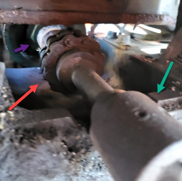

I drove my L275 down the road to my sons place which is less than a mile. As I slowed I noticed some LOUD noises coming from the front end. My heart sank thinking it was the lower end of the engine. Parked the tractor and went back the next day with the trailer. Started it up and it's making a heck of a racket and the bucket would not raise. I see the belt moving so all three pulleys are spinning with no visible wobbling. What can go wrong with the front of the PTO and or what should I be looking for as I pull off the bucket pump? I appreciate any advice

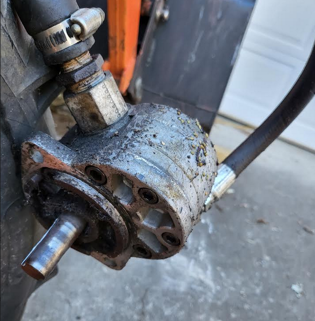

Well I just removed the pump and started the engine. I can hardly believe the pump made that much noise but it did.....

1. OK, Thanks for the info on Metal in the system...Hadn't thought of that.
2. I could not find a number of the pump at all, just the name WEBSTER.

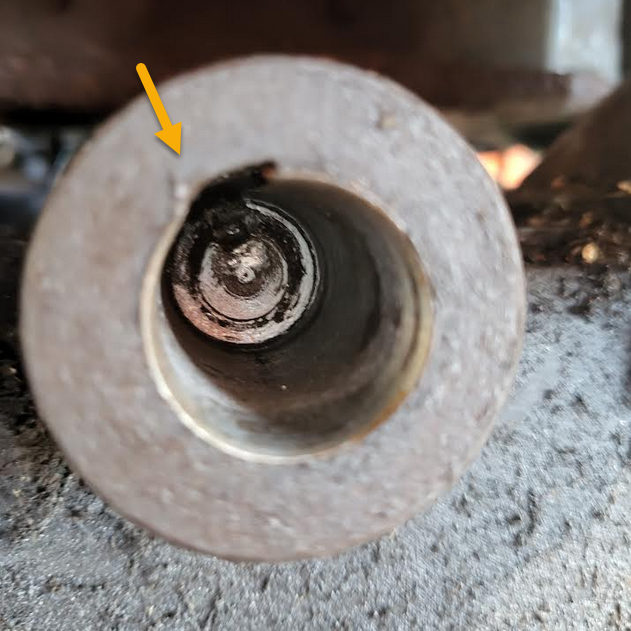

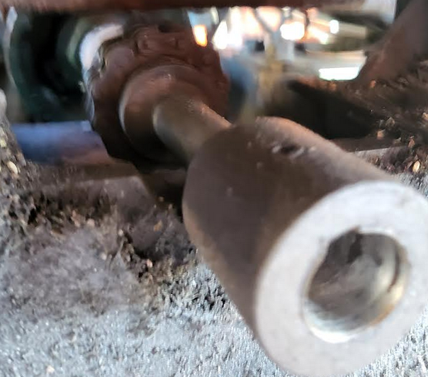

3. An additional item is the shaft connecting the pump to the front PTO. I tried to find a release similar to implements that attache to a PTO and am unable to find anything. I believe this part has been on the PTO since new, I sprayed with PB blaster to help release but may need to remove the radiator to get a better view. It is stuck at this point unless someone can point me to a release mechanism.
4. In the center of the shaft there is a dual chain possibly a slip clutch... this could be bad as well.
What I know is when I removed the pump the noise went away. Suggestion on troubleshooting each please.
5 the key-way on the end of the shaft is smooth to the touch in the counter clockwise direction when facing straight on. Thoughts?
12,920
5,647
wow, someone ran that for quite awhile and 'messed things up' !!!
double roller chain is the 'coupling' between engine and pump, allows for a MINOR (small) mismatchh in alignment.
keyway in #6 photo is shot, must be replaced, I don't see any 'mid ' support for the connecting shafts.
Since the pumps a Webster(big USA name) I suspect previous owner made this 'upgrade' ?
'click' engine over couple of times( no start !) to see the front PTO shaft rotation, you need a pump with the OPPOSITE rotation

Is this connecting shaft a standard shaft? I cannot find an IPB for this unit nor can the Kubota dealer. Does someone have a PN for the shaft? How does it connect to the PTO, can't find a release... Thanks.(y)

I would say you didn't a "pump" failure, as much as you had a "coupling" failure. The key should fit snugly into the grove in the pumpshaft, and in the grove of the coupler. I am thinking both keyways a shot, which means a new coupler and a new pump. Plus the pump should slid snugly into the coupling.

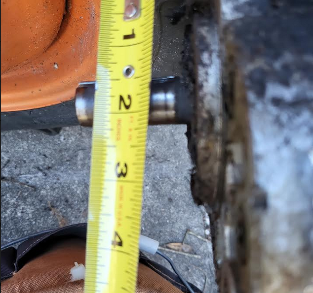

In the picture #4 the chain coupling connecting link is at the top. If you can get it out and the chain off then have the shaft to measure to replace the beat out coupling on the pump end. Might be able to get a shaft coupling to replace that along with a pump to get you going. You wouldn't be guessing at the length etc. Assuming of course the crankshaft end is still sound.

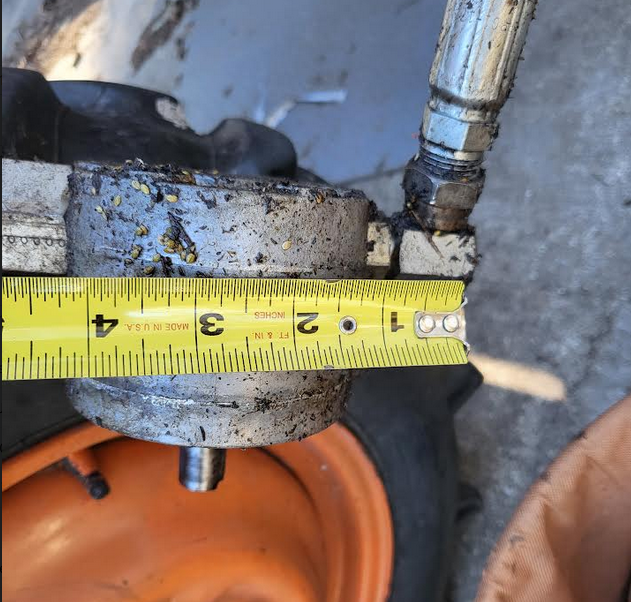

I dont see anything special there - looks like all commodity parts. You should be able to replace everything from chain coupler out including the pump for $300 to $400. I have done a few.
What you have is fairly standard for the vintage of the tractor and there are many threads on this forum that discuss the arrangement and how to resolve problem.
The front of the engine’s crank shaft extends through the pulley and was used for auxiliary power. That shaft has a splined outer diameter and Kubota sold a shaft that fit onto the spline and had some sort of set screw locking to keep it in place. That shaft extends out to a coupling (in your case a roller chain coupling). Half of the coupling is on the tractor side and the other half is on the the shaft extending out to the front of the tractor (in your case that shaft goes to the pump and it looks like there is a second solid coupling at the pump shaft.). As others said it looks like the solid coupling failed.
This system could supply p to a larger flow pump than the standard pump and was used for front end loaders. There was also a electric PTO clutch that could be fitted there to turn on and off the power transmission out of the shaft
the chain coupling is what you want to take apart
