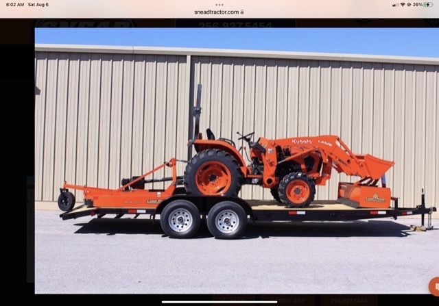

Thinking about this combo…Land Pride is not el cheapo is it? :unsure: :cool:
Much better box blades can be had and I'm not familiar with the brush hog. Those trailers are the cheapest of the cheap - unless you really need a trailer, I'd get a tilt deck that's a few feet longer later. Also keep in mind those package deal tractors do not come with some of the options that you may want like rear remotes, turf/R14T/R4 tires, 3rd function, etc...
Just some things to think about. Messicks has a good video online about package deals and pros/cons.
Land Pride makes several grades of equipment. I can't tell from the picture, but that looks like one of the lighter ones (first two #'s 12 or 15). The cutter starting with 18xx is a good, medium duty one.
I don't know the BBs, but they have at least two weights.
looked up land pride, made in Kansas is good enough for me(y)

On the Landpride packages, check with the dealer whether they'll let you upgrade. There are low end brush hogs/box blades, and heavier duty ones. The packages tend to have the light duty ones, and the usual recommendation around here is to go for the heavier ones. But the dealer may honour the "discount" baked into the package even if you get the heavier implements.
Trailers, the general recommendation is to buy a good trailer separately. The ones in packages are often not very good. In my part of the world that means Chinese-made and poorly welded, but in your part of the world it probably just means they were made to a budget - lighter deck, lighter weight axles, maybe less effective brakes. Unless you're using it very rarely I think a cheap trailer will rust and wear out/break quickly. But if you use it only to bring the tractor home, and move it place to place a couple times a year, and can keep it under cover, then it may be all you need.
