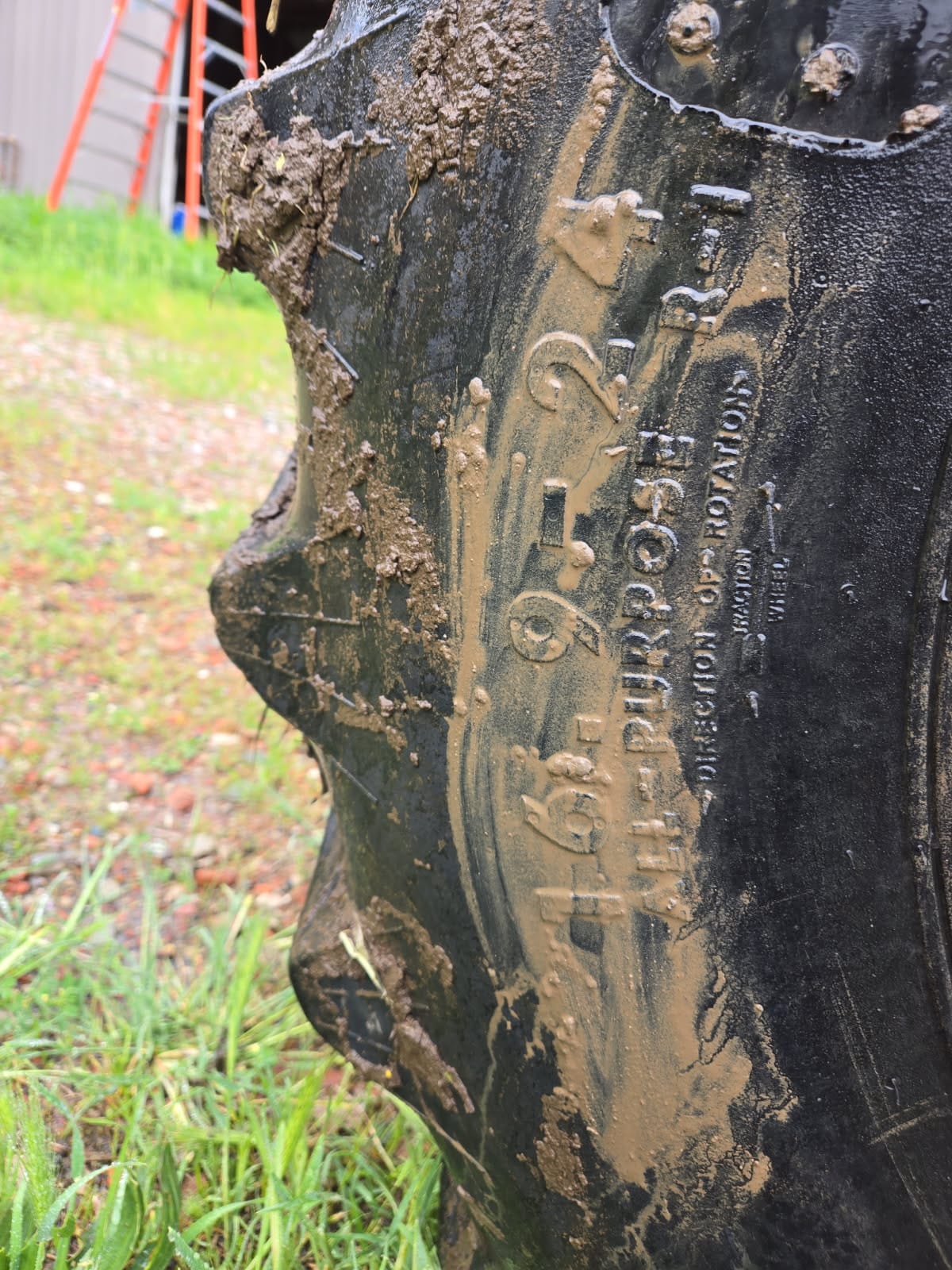

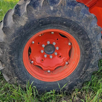

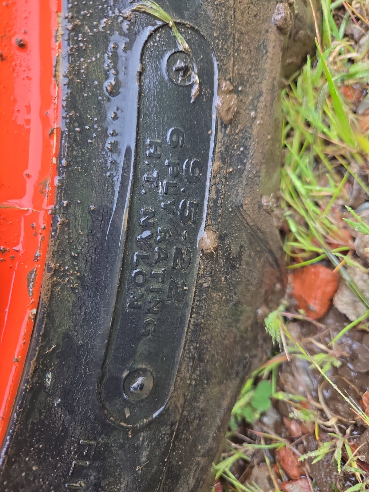

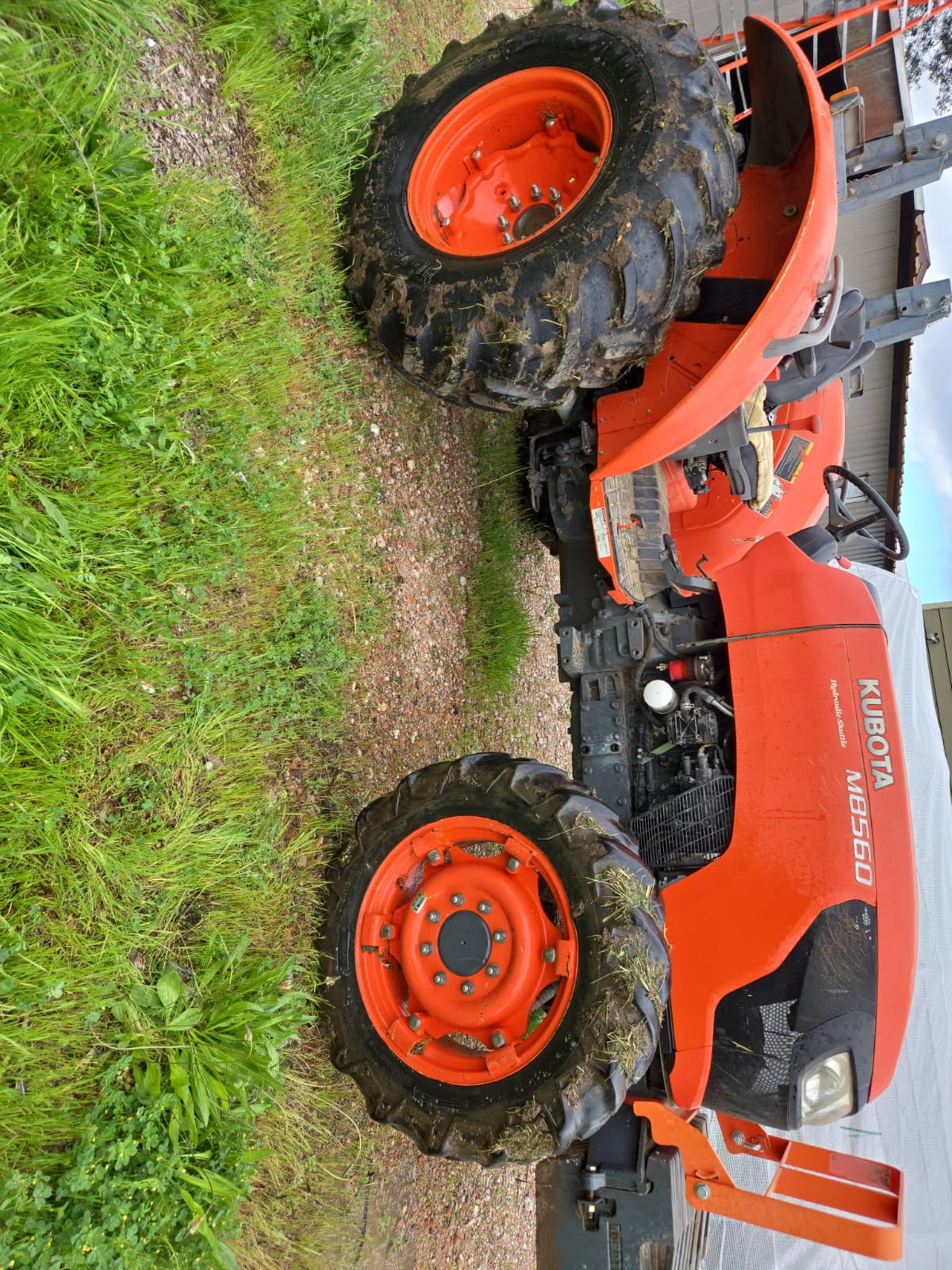

Hey everyone,
I'm trying to switch my Kubota M8560 to row crop tires — the thinner ones for better maneuvering between rows. My current tires are:
  • Back: 16.9-24 R1
  • Front: 9.5-22
I didn’t get much help from the dealer, so I'm hoping some M60 series owners can pitch in with the correct row crop tire sizes. Any advice or recommendations would be greatly appreciated!
Thanks in advance

The front-to-rear axle ratio on the M8560 is 1.405, unlike the 7060 and 6060. The M5-091 has the same hub dimensions and axle ratio as the 8560. You can Build a tractor on kubotausa.com to see their tire options for an M5-091, but it looks to me like you have the narrowest Kubota offers. Some have larger wheels and look narrower, but I think it's only because they're taller.

You actually have non standard tires on it right now.
These are the 2 stock options for the taller tires
Front 12.4-24
Rear 16.9-34
Front 12.4R-24
Rear 18.4R-30

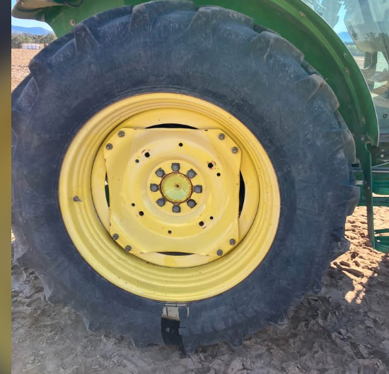

Found a used ones from a private seller with rims, 16.9-R34 back and 13.6-24 front. I am really anxious what if they mess up with MFWD mechanism if not of the proper ratio? Where can I really confirm or double check? I will be peaceful if someone using this combination. I also found that these tires used on JohnDeere, is that okay? Do they interchange?

The fronts are not the right size, 12.4-24 is what you need.
The 13.6-24 might work, but would need RC of both tires to know for sure.
Can you measure them before you buy? You can measure the circumference of both tires at the largest point, divide the rear by the front, that should be maybe 5% less than your table ratio.
Also check the bolt # and circle, and hub hole size on the wheels.

I got a good deal for the back tires, I will buy the front tires from somewhere else. but they are coming from John deere , do you think the wheels/rims will give me trouble ?
34,827
10,118
I couldn't tell you anything about those rims specifically.
If all the holes are the right size I would think you'll be fine.
