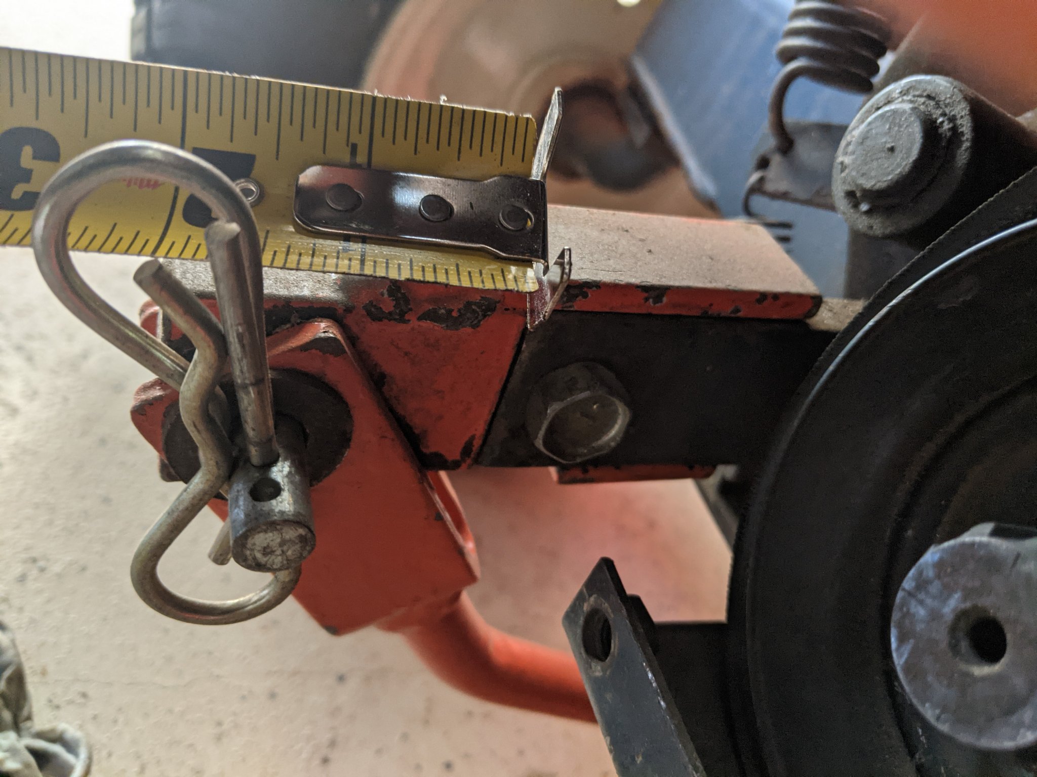

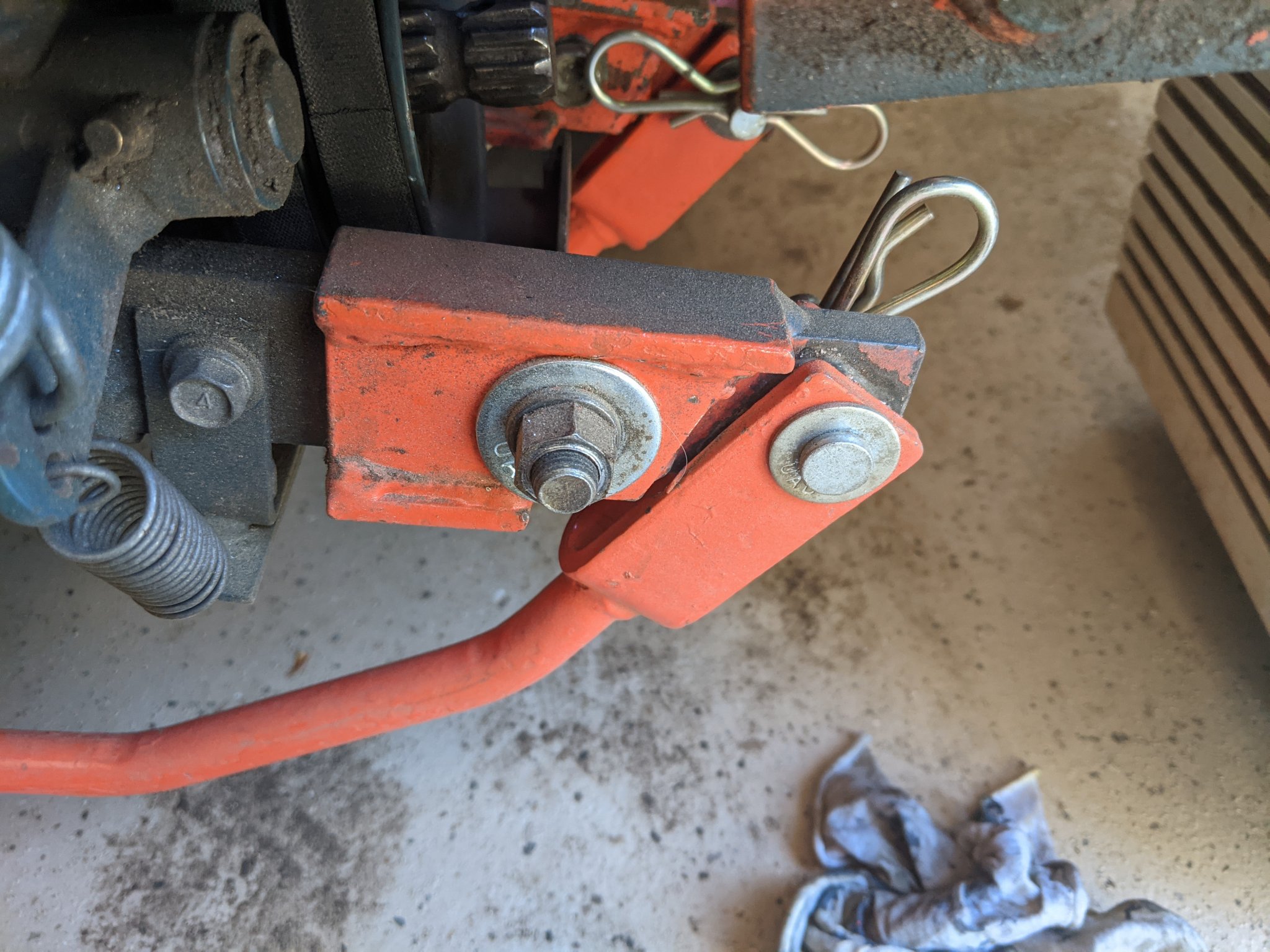

I hope you have found a deck. but if you have not and for others the mower decks for the G3200, G4200, G5200 and G6200 will all fit each model. Replacement decks that you can get are any deck for those 4 tractors ( These are not available anymore) you will have to find a used one and they rot out. The part numbers for those decks are RC40-G, RC44-G and RC48-G.
An updated deck that will fit your tractor or any of the early G series, are the decks for the newer G series mowers. G1800, G1900 or G2000 tractors. Those decks are RC40-G20, RC44-G20 and RC48-G20 if you use those decks depending on which front link arms you have for your mower you might need adapters as well these extend the front attachment points on the frame an additional 2 inches. I have attached photo's of these brackets.
THANK YOU for the photos.
During sharp turns, the rear wheels on my mowdeck rub the rear tractor tires.
I have measured and determined if the mowdeck was 1.5 inches closer to the front... all would be well. My front links are SOLID (do not have turnbuckles for length adjustment)
Now for the million dollar question. DID YOU WELD UP THESE EXTENDERS YOURSELF?...or are they a Kubota P/N?
Thanks.
Thanks.
The ones on my 5200 are the exact same extensions. Kubota made, no numbers on them and hadn't found anything online yet.
