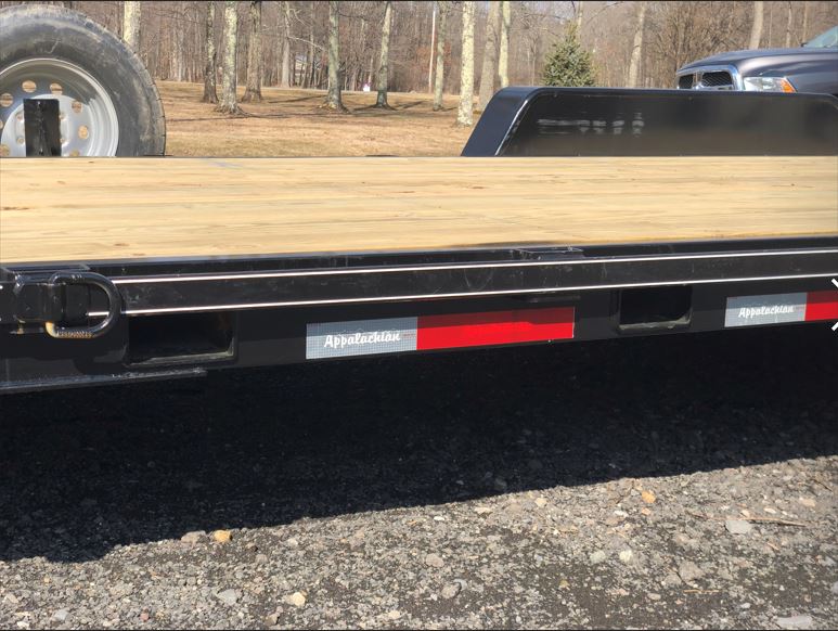

Before you pull the trigger, perhaps inquire about fork carriers....something like these. You may be able to do them as a small add on....
