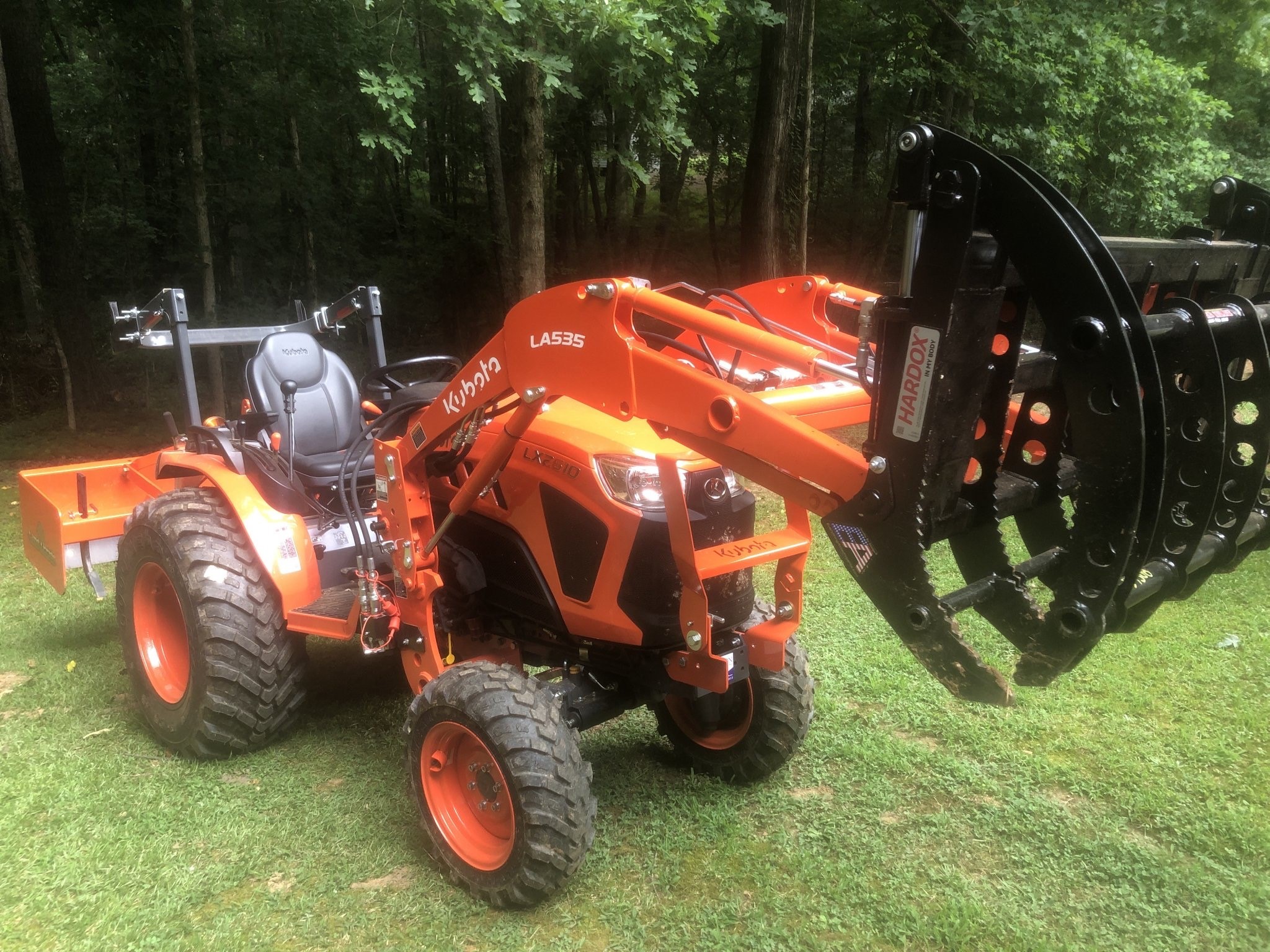

I have the larger SU R14's on my 2610. I like them in the woods and on dry grass, if it is wet, they will do damage, but I think anything would with the ground soupy.
Adding them automatically adds a steering stop kit too. And if you ever plan to run chains, spacers will be needed. Very little clearance from inside tire to rear fender.
And I would suggest the 60" bucket.

great to hear! So from your experience, on turf would you say so far your impression is R14 is about same as R4? I have a lot of R4 experience with tractor on lawn and it’s “ok” overall for all of my uses. Just want to make sure on dry and mostly dry grass I’ll be ok with R14 and that they’re good in the woods too!

I have very little experience with R4's, I am very glad I got the R14's with my 35 hours on them so far. They do cake up a bit, but they never stopped pulling while I was grappling privet trees out of the ground. I was really impressed.

Do you have the spacers on yours? That machine looks awesome!
