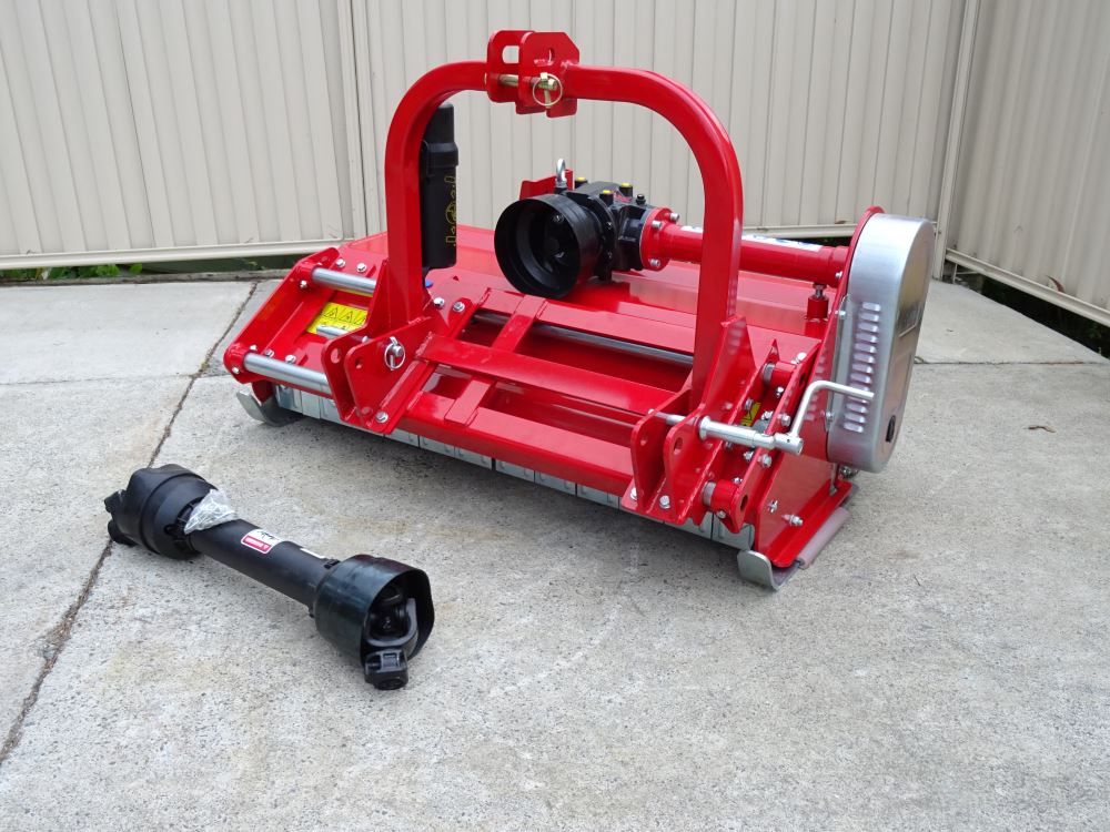

Agree completely. It's not too big for 5 acres, and the BX is arguably too small. I'd rather have a tractor at the top end than the bottom end of my needs. Only thing is if you were planning to mow, but the CK37 will pull a RFM quite happily. Or you could pull a 6 foot offset flail. That'd top the paddocks instead of a rotary cutter, and still do a fine enough job on the house section. Plus you could mow roadsides with it - offset.
You might even be able to go up a size if you run it slowly - means you can still cut a lot quickly without beating your back up over bumps.
