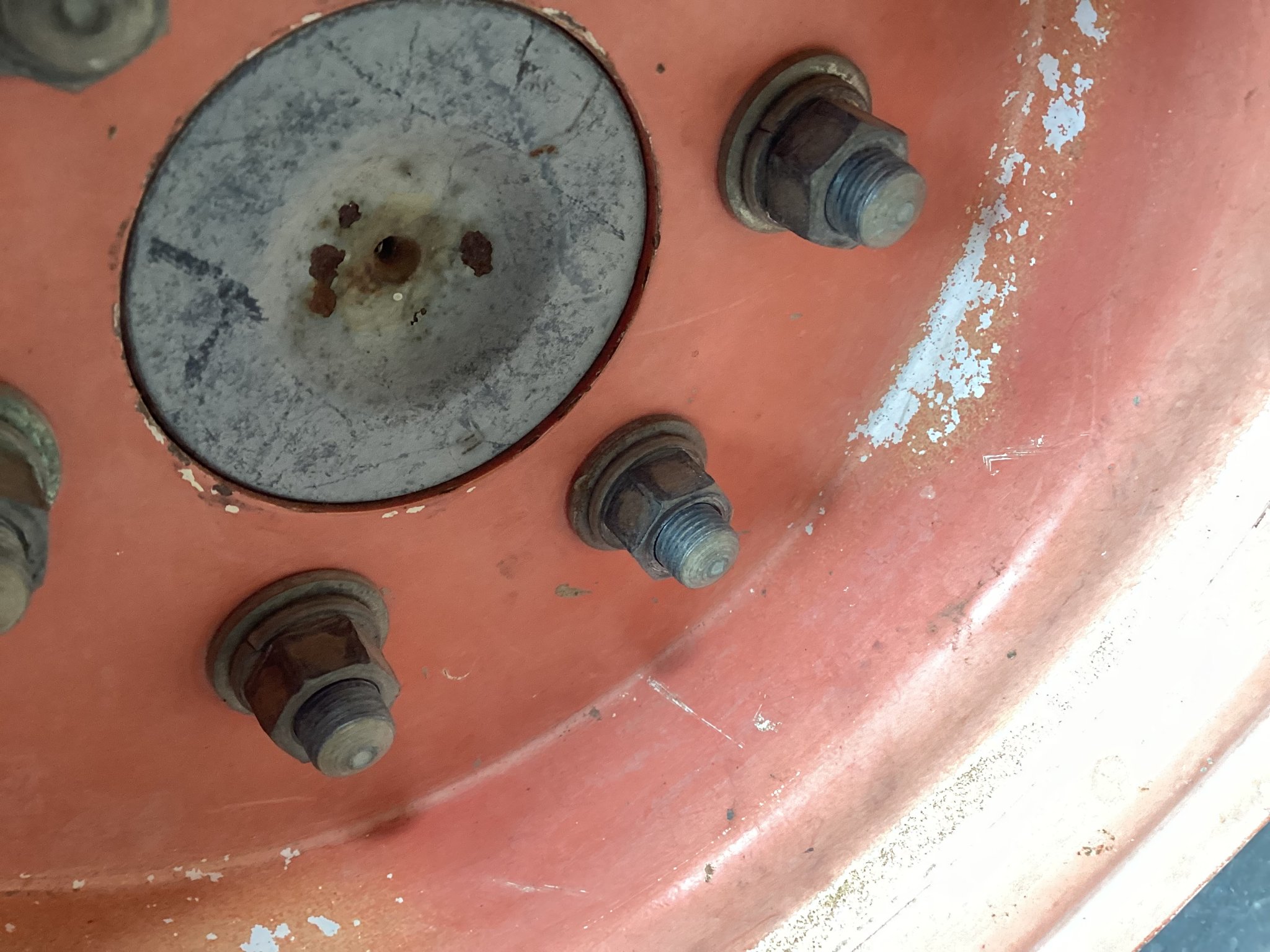

I recently had to pull a tire off my old B7500 -- the lug nuts were installed with the tapered end out and with lockwashers against the wheel -- non-tapered end of the lug nut against the lockwasher. I looked at the other wheel -- same set up. Is this correct?

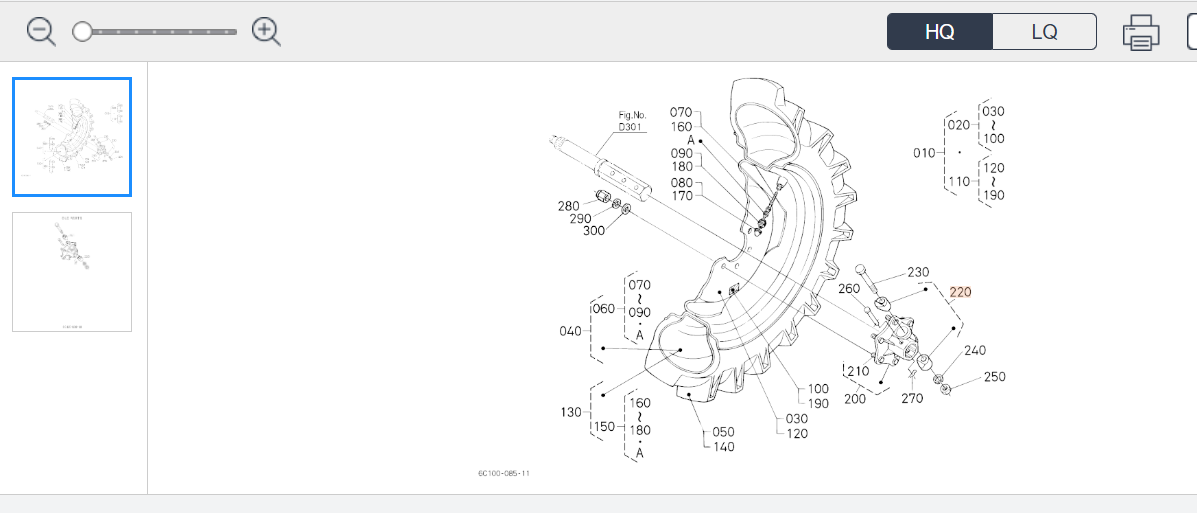

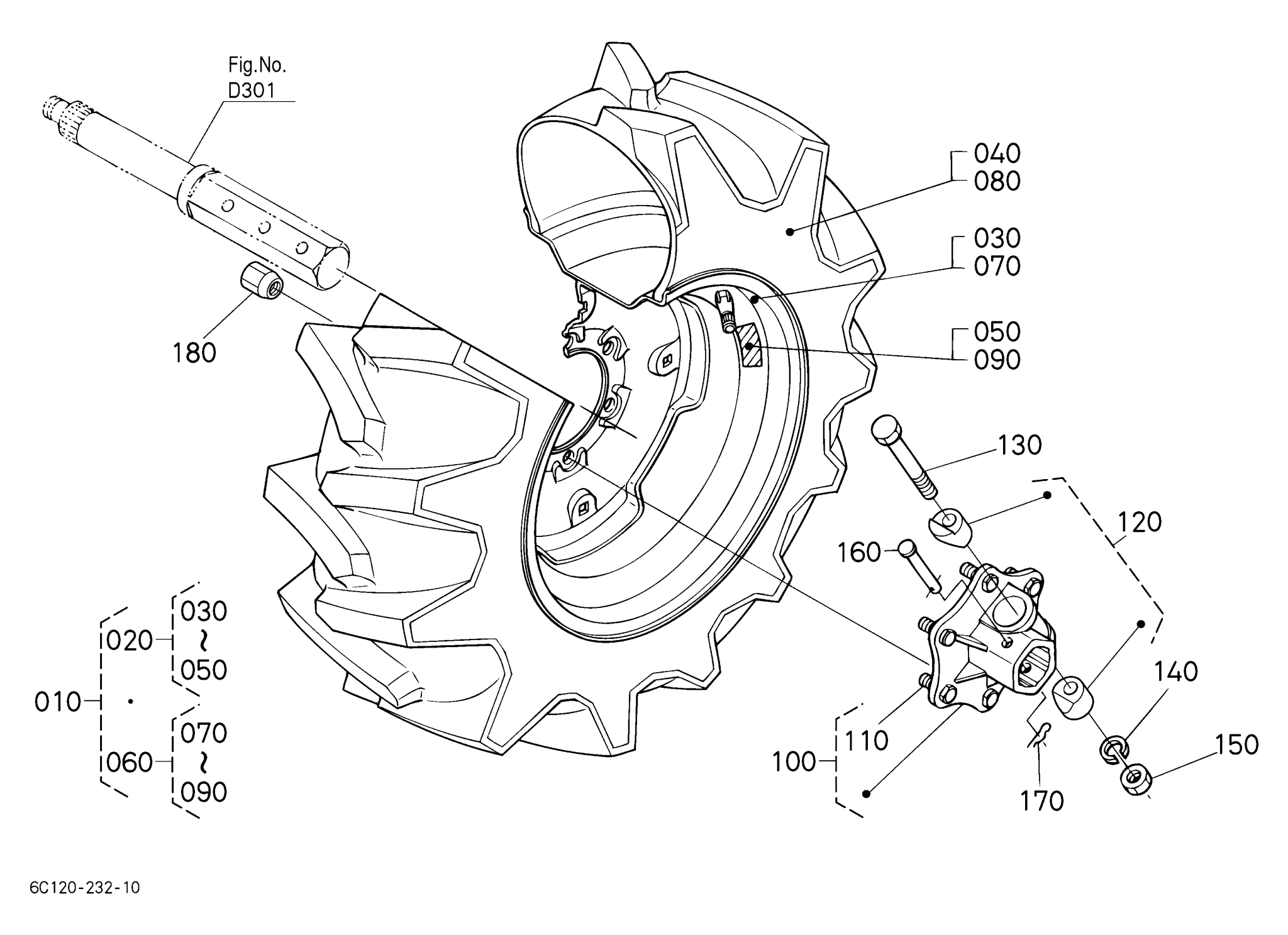

pulled this from Canada, B7500D, #180 seems to be a TAPERED wheel nut, at least to my eyes....
one clue is on the rim.... is there a 'taper' around the hole where the studs go though ??

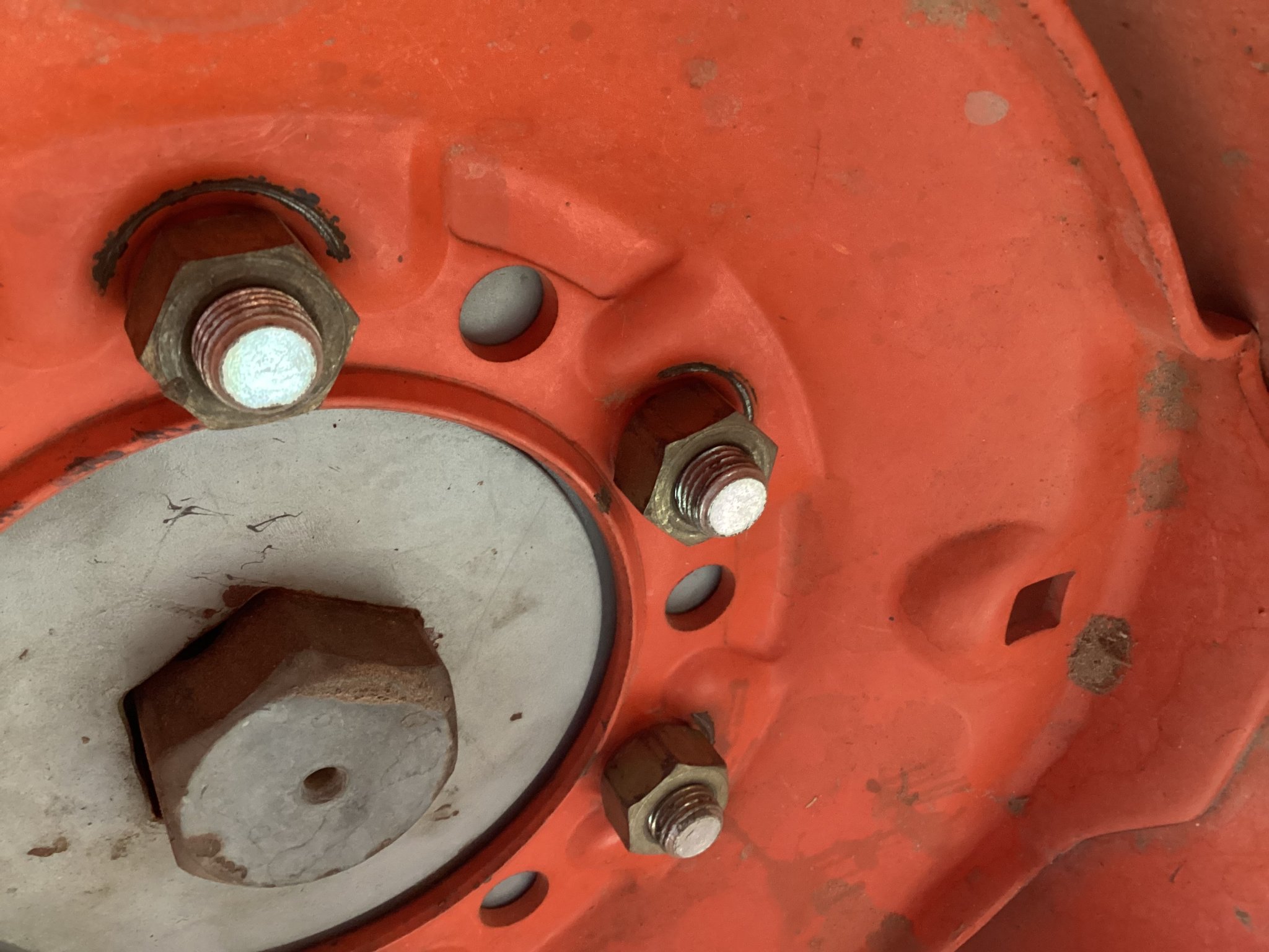

Here is a lock washer version.
