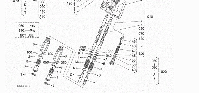

I bought a new FEL loader valve for a cab model (B3030). I can't actuate the control cables, ( lever is unlocked). I don't have a manual for the loader and am wondering if the tension gets adjusted by the springs I see in the parts breakdown, (attached). If so, can anyone tell me the procedure? I don't want to break anything.

Update.
Perhaps I didn't explain my problem sufficiently.
The problem was not with the cables, it was the spools were frozen in the valve body. I solved the problem by removing the fittings, filling with UDT and letting it set overnight. I then adapted a small puller and carefully dislodged the stuck spools and worked them until they freed up. I think they are working correctly now. Hopefully the packings aren't damaged. I then adjusted the cables as Dave-eng provided in his reply post, thanks Dave.
