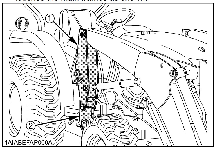

LA463 (original FEL) and LA524 (updated series for the "Standard" L Models). They both lift the same weight, but the location of where that weight was measured from changed.
For L3400, the L2800 used the same same loader. Not sure exactly when the LA524 came out, if it was mounted on some L3400 or L2800.
LA463 used a "C" channel to hold up the loader where LA524 uses a single arm (#2)
Any of the "Standard" L's after L2800 and L3400 uses the newer LA524...
