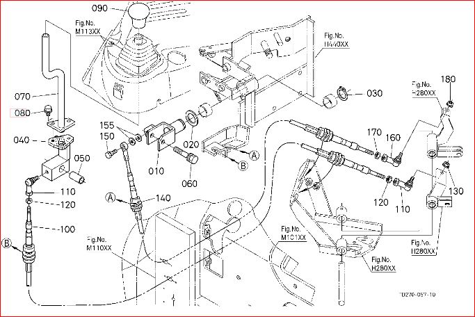

With your last statement I'm thinking your problem is in the cable inkage, probably has come loose.
Depending on which exact model you have (HSTC or HSTC-3) it could be either set up:
HSTC
HSTC-3

Thanks Wolfman...I think you're right, I need to adjust the linkage; the control arm barely moves towards the back before hitting some sort of limit.
I have the HSTC-3, do you normally adjust at the control arm (near part # 140) or outside near part # 170/120? Actually, 170/120 don't appear to be the adjustment, but the 2 bolts to the left of 170/120 look like they could lengthen/shorten the assembly.

Thanks a lot for the diagrams, I started with the adjustment nuts on the outside because they were easier to get to, and that was all it took. I just needed to push it in a bit to center the control arm, and now it works like a champ!
