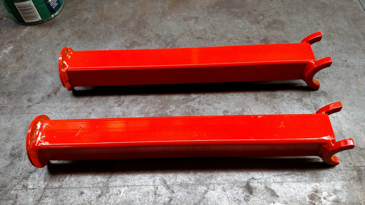

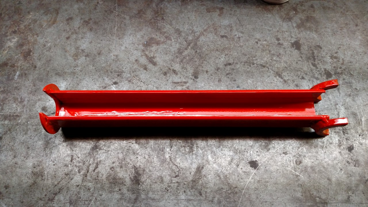

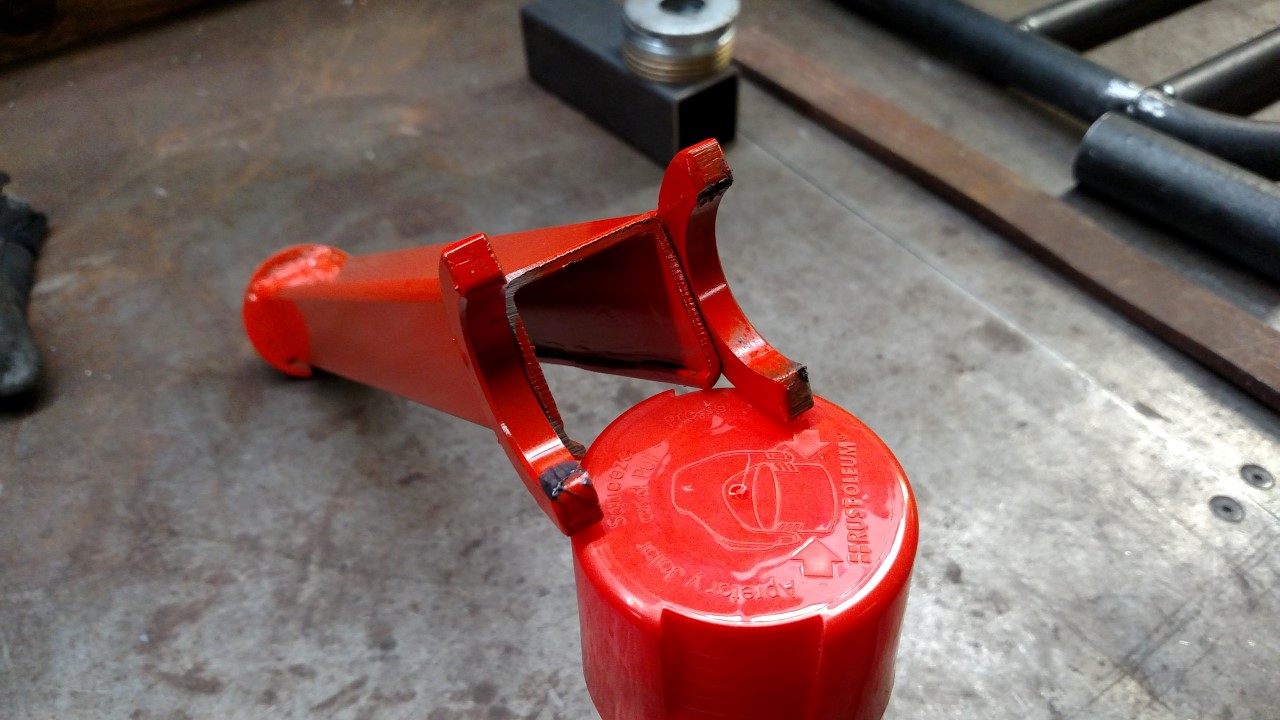

Here is what I made for my BX. The curved pieces on the end that pivots are a 1 1/2" shaft collar sliced in two, then those cut in half. I used 1 1/2" square tube with on side cut out with a plasma cutter. I used a 1" flat washer on the other end, cut to slip over the cylinder ram.
