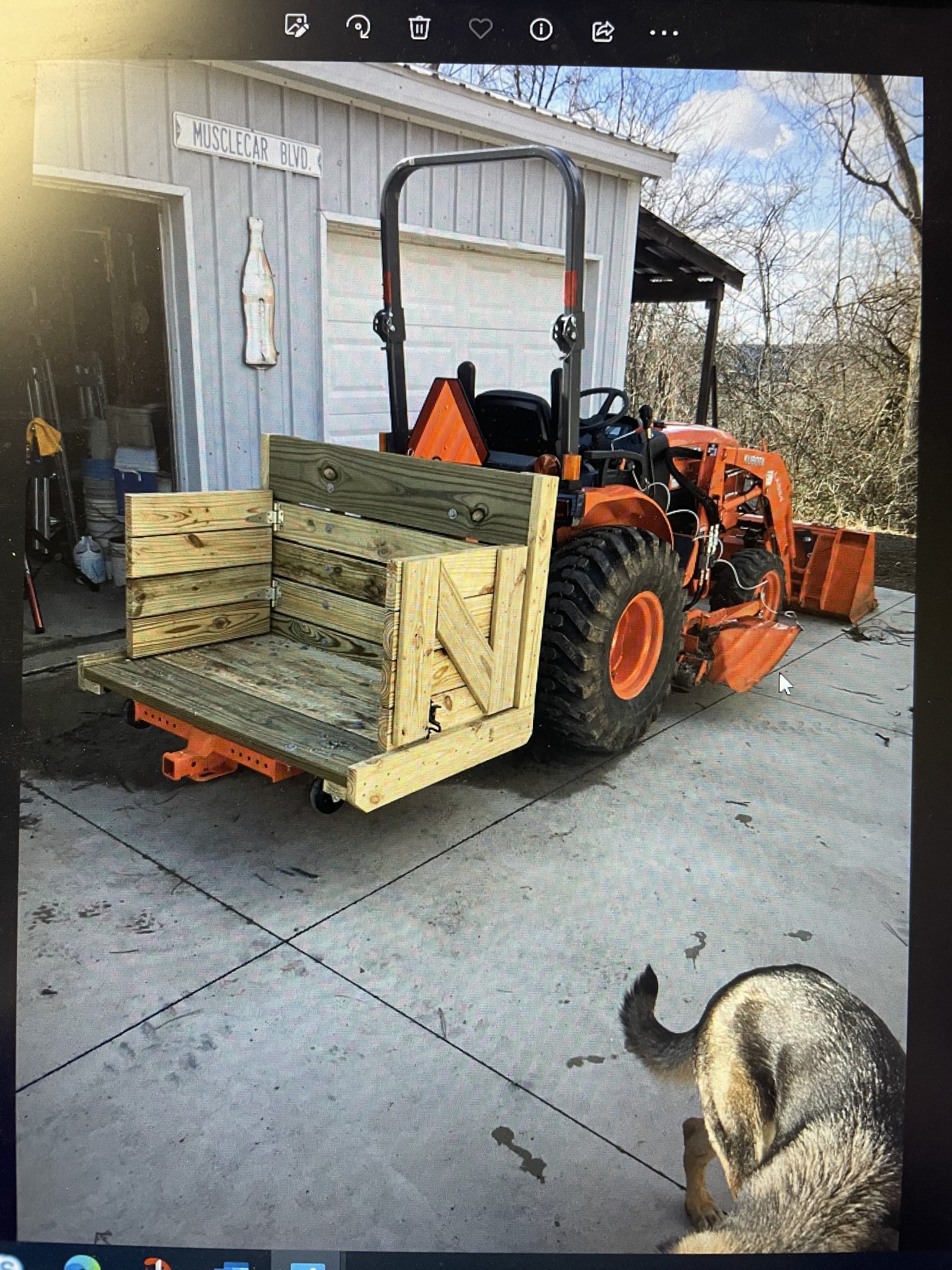

Maybe a carryall would be a good idea.
I’ll investigate. Thanks! I guess I’m really trying to use my front bucket as a carryall anyway. I could probably buy a carryall for the price of the 3-pt adapter.
