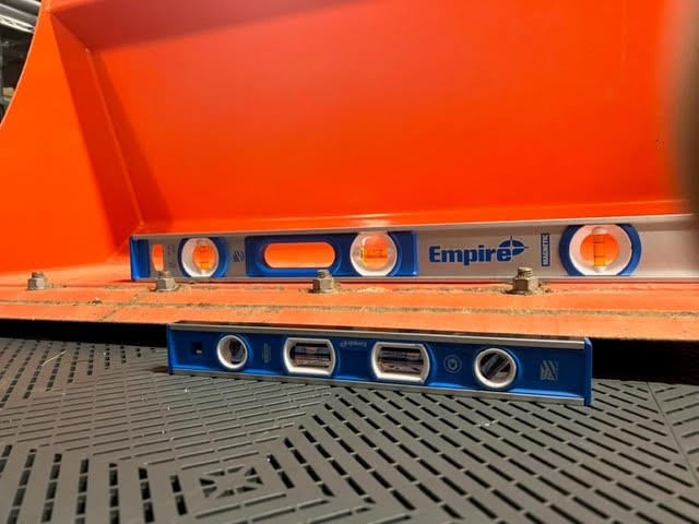

Not sure these show much but the floor is level but the bucket and frame are off.
Dealer is picking it up today/tomorrow to take a look.
Suspect this is why I had to make very large adjustments to get the mower deck level as well (mid mount).

Forget the level, just measure from the floor on each end. It doesn't look way off so try loosening all sub-frame mounting bolts and try to tweak it back to level, then re-tighten.
I did measure. At the cutting edge it's about 1" difference. At the front of the tractor (frame) it's about 5/8" difference.
Meaning -- the frame of the tractor at the front-end is not level from side-to-side.
